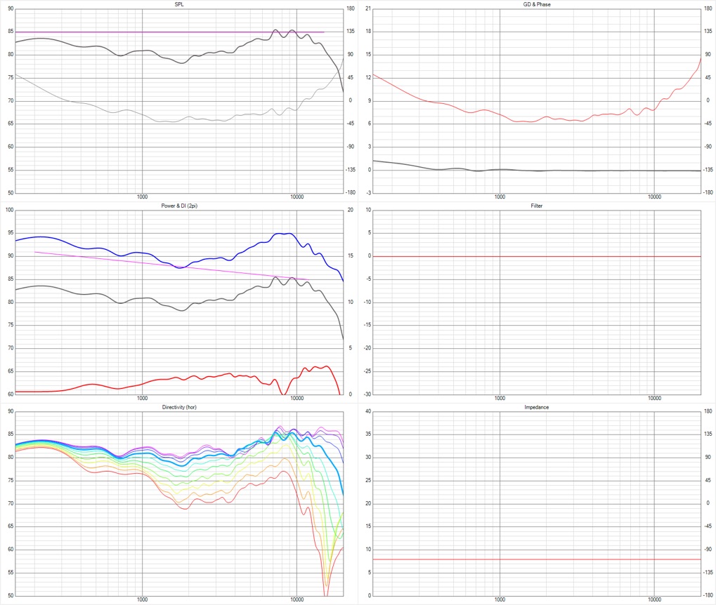

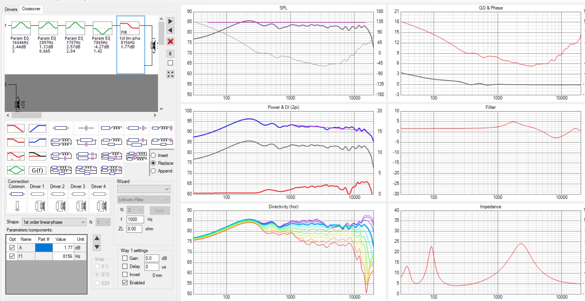

Well like you, I backed away from a crossover redesign because of the sensitivity. The EQ I ultimately used had a fuller tonal balance with greater emphasis in the midbass. It would have required dropping another 3-4db if sensitivity overall to tilt the response that way passively. It seemed like a 76db at 1 watt speaker was not palatable to most.
Here are my pre and post eq results. I shared these at my Masterclass at AXPONA as well. I did fill in that dip in these.
I tried to keep the eq relatively simple. You can get a sense of it in the upper left. Ultimately a new crossover is a better solution.
That's impressive software. Thanks for sharing. My revised passive crossover has about the same sensitivity as the stock unit. Maybe I'll reconsider. But all those extra components do add a lot of $$$$. This speaker is an odd duck. Lots of potential, but not easy to fix in a commercially viable manner.

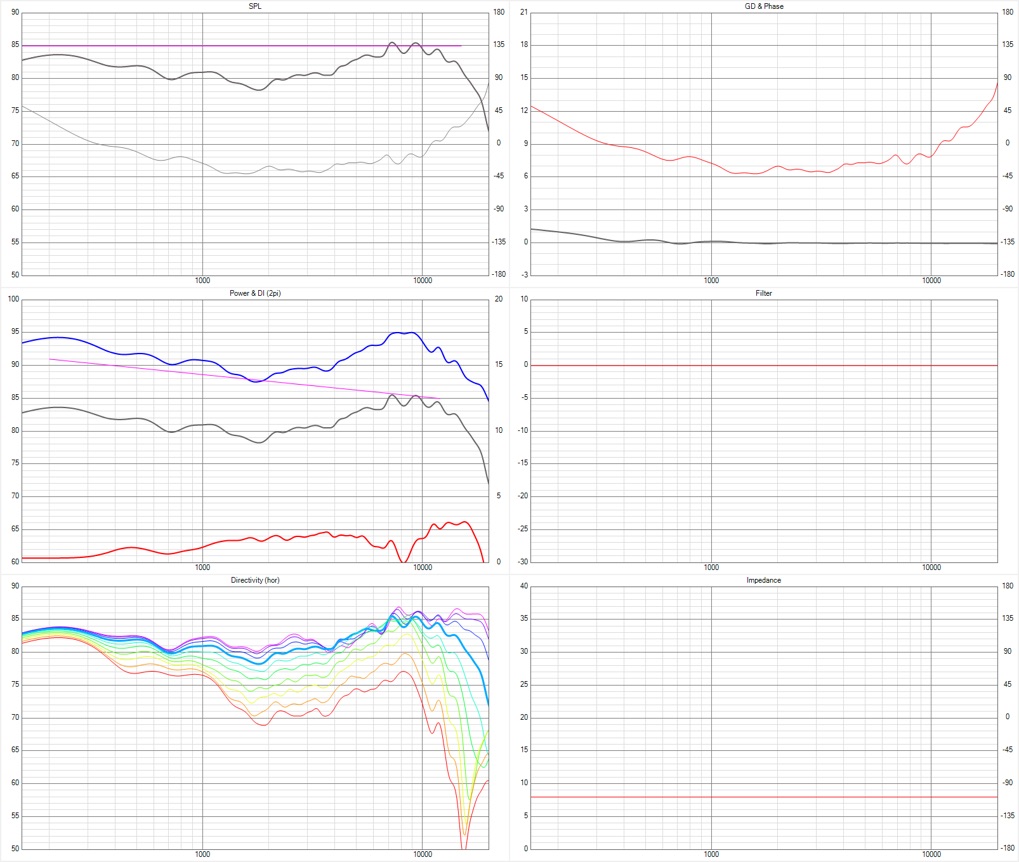

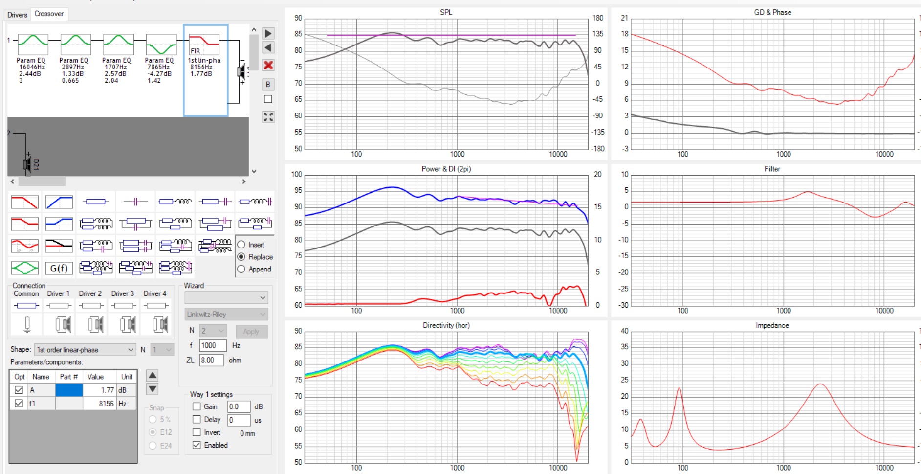

btw: What software is it??
Matthew J Poes
Matthew J Poes
Staff member
vituixCAD
https://kimmosaunisto.net/Software/Software.html
It’s for crossover design and can do active or passive. Since it can do active, you can model eq. When trying to eq a speaker, using its free space polar measurements is really a lot better. As you can see, I made a bunch of non-intuitive changes to get he best sound. First is that I went with 20 degrees as the preferred listening axis. Second is that I eqed the response so it’s average response across most of its polar response was flat, not so it’s 0 axis was flat.
It’s great software. I used it to model my alternative crossover for the 402 as well. Very flexible in what you can implement. It also has an automatic optimizer that works well.
