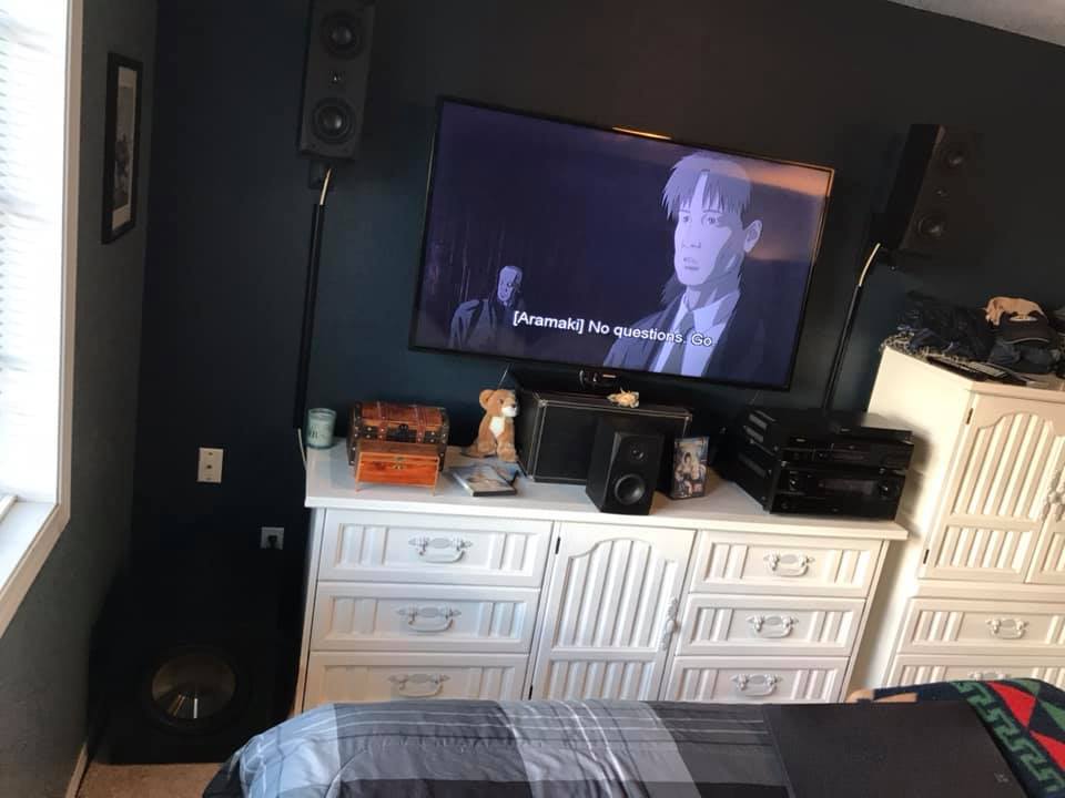

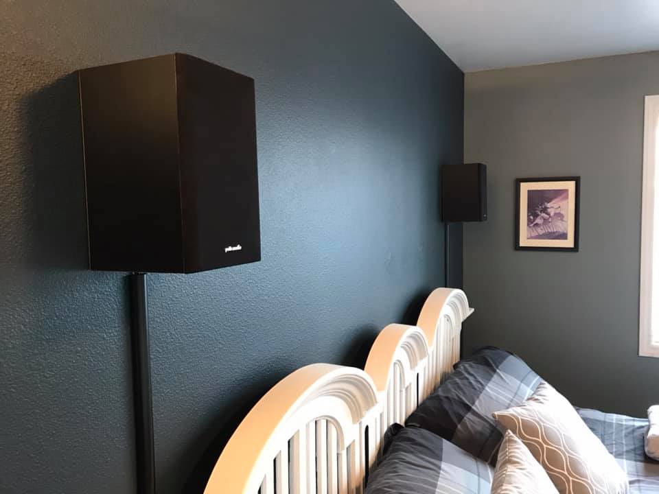

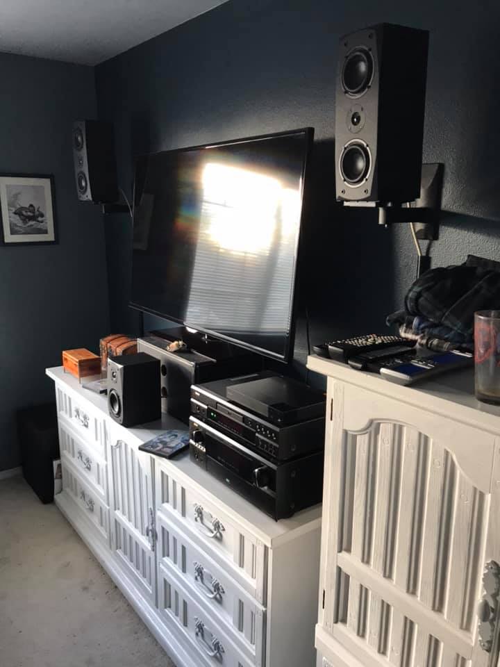

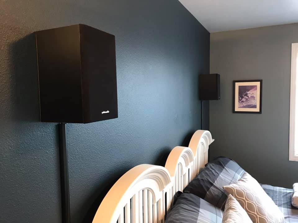

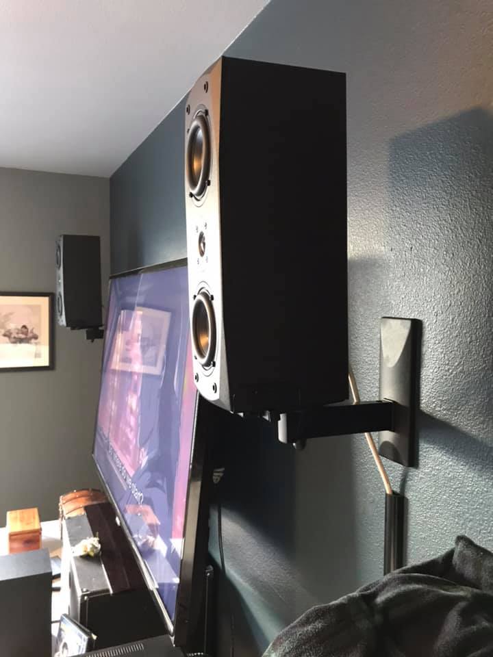

Based on Audioholics Best of 2018 I decided to get a host of 'budget' speakers and spend the entire day tweaking and tuning it until it sounded just right.
Although it can't touch our main theater or even our game room for punch or overall dynamics it sounds leagues better than the old 2.1 system.
The new speakers and their wall mounts amounted to just over $400 including shipping (which is ridiculously cheap)!!
Everything is wall mounted except for the center which is at ear level and the system is now 5.2.
Mains: Dayton MK442's (c/l/r) mounted vertically.
Center: Dayton MK402's (bookshelf).
Surrounds: Polk R1's (bookshelf)
Subs:
a) BIC America F12
b) Definitive Technology Prosub 80
Receiver: Denon 3805
DVD/SACD: Denon 2901
Blu-Ray: Sony BDPS6700
Display: Samsung LED LCD.
Interconnects: all Blue Jeans Cable, Monoprice, Audioquest, and some random 14awg wire spool.
After much tweaking with speaker levels and distances, gain on the subs, EQ adjustment on the MK402, running all new cable races + filling holes and repainting: we have a nice new space to relax in and watch movies/stream youtube/play retro games etc.
Did all the install myself with critical feedback from my amazing wife.
Thanks Gene for the lead on these, they sound terrific for the meager amount I spent on them, and the Denon 3805 doesn't seem to bothered by their 4(5?)ohm rating.
As you mentioned in your review I EQ'd the MK402 in the upper spectrum to smooth it out, and it took some tweaking level wise to get everything to sound homogeneous.
The additional sub really evened out the bass in the room, although the gain on the F12 is ridiculous and it's currently set at 1.5 out of 10.
Subs:
a) BIC America F12

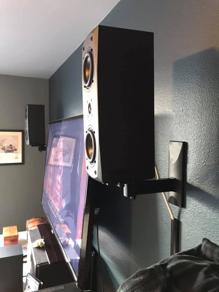

You might think about angling the MK442 downward a little bit more so that the tweeters are aimed at the listening position- that is, if the speakers aren't too top heavy for those mounts. Those mounts look like either the AMT Pinpoint 40s or the Videosecu side-clamping mounts, essentially the same design, so I think they should be able to be angled a bit lower. Anyway, very nice setup, that is a killer little speaker system!
The Chukker
The Chukker
They are in fact Videosecu side clampers.
I have them tightened down pretty well and I could definitely tilt them down tad more.
Tx for the tip!
