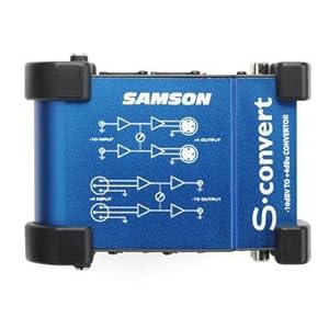

So, I found this recommendation by WmAx when using the search function. Is this what I need, or is it overkill for the application? $50.
Then this Mono y splitter, so that I can run dual subs.
I have to admit that I'm not crazy about how the Behringer looks. I think the Yammy amps that WmAx likes do look a lot better, but I'm not sure how they compare in power, if for more money. I am not sure which of the four P series amps would be sufficient. The pricing seems to run from about $400+ to $750, depending on the model. Hm.

I have seen that Samson unit used by tcarcio as well. I think it ups the voltage of the line level signal too. The fan mod for the Behringer is talked about here:

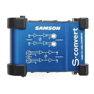

From what I've read, the s-convert is a trial-and-error type of thing. Some people are fine without them, but if you're running a pro amp pretty hard you might run out of voltage. IIRC, some of them have an audible hiss when the gain is on the high side. Probably not an issue with a sub especially since it doesn't sound like you plan on pushing it too much. If the interconnect run is long you might benefit from the noise rejection of the balanced connection. But that's application-specific too. I would wait on it and see if you run into any problems.
The interconnect run will be short. I run the HT at roughly -11 to -9, depending on the movie itself, and how packed the HT is. The sub is usually around normal, and I think the hottest I've ever set it to was +3. Not exactly sure where it's at right now.
