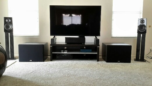

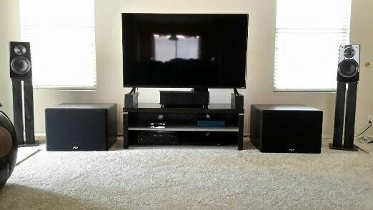

I agree. I have a lowly 58" pansy plasma, lol but the only thing for me to consider is an OLED. I'm about 16' away and it's just too small. Here's the front of my room. That little 58 just gets swallows up!
Pardon the mess. That was shot a Christmas time.
I've been wanting to see your setup! Are those B&W speakers? They look similar to (but nicer) the DM570's I had.
*Edit: Nice space you have there too.
on the contrary it looks quite lovely.. lot of sunlight for my taste though for I am a vampire type of person.. since I live in kuwait I have experienced enough sunlight for more than 10 life times :)
Those are JBL studio II's. been a little shy about posting pics but...

That was shot early in the day with sun reflecting off of the snow outside. fwiw I hate winter.
This is at night, and if I leave the panel lights off it's pitch black.
