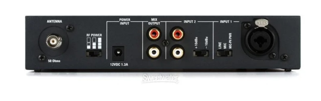

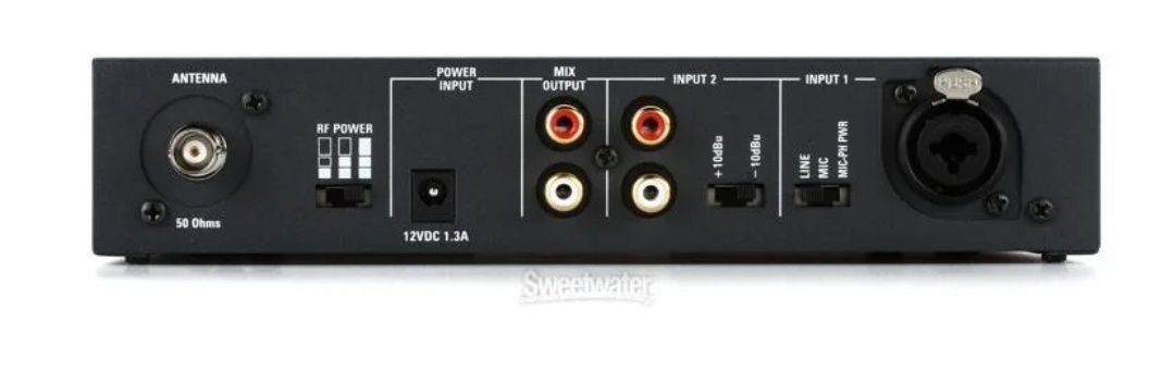

I have been unsuccessful. If I transfer all the cables from the old transmitter and set everything the same, except using Channel E instead of Channel A, it works fine, so it's not the transmitter equipment. I have attached an image of the back panel to help.
Unfortunately, when hook up a microphone headset to the RCA inputs, I get nothing out. When I hook up the XLR setup, I barely get any sound and it's of very poorly quality. I can barely hear it. Nether method has any audio to.the earphones, even when the system is running using the Audio system as set up on the original transmitter.

Not nearly enough information to make any sense of this. This is going to be a gain matching and also possibly and impedance matching issue, especially as we are dealing with balanced and unbalanced inputs and outputs here. So you would have to make a drawing of your connections and the specification of all the inputs and outputs you are connecting.
