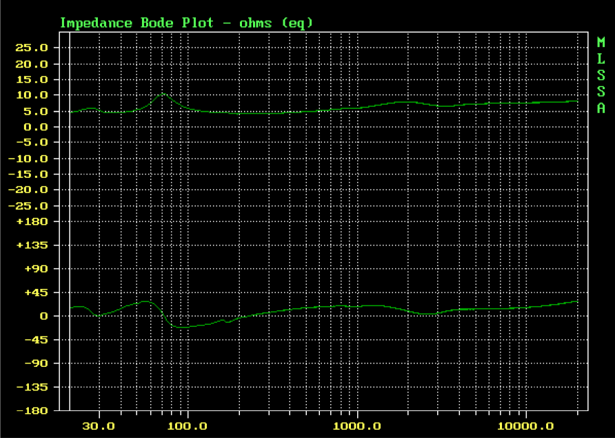

No, they do not all sound the same under different loads, and its fanciful to expect that they would and will. Amplifiers are tested with resistive loads, and is therefore limited in telling you how it will drive a given loudspeaker. Very few amp manufacturers actually test their amps under varying condition of load. This was another point that Peter Walker made continuously. For one thing source impedance varies from amp to amp, and those with a higher source impedance will sound more different under varying loads than one that has a very low source impedance. That is one reason that I am keen on Quad amps, as they have a very low source impedance.
In comparison to this issue, measuring amps for minute levels of distortion connected to a resistor gives very limited information. That is what you would expect the way impedance curves look and then even more to the point look at phase angles. When these get to negative 45 then there are huge differences in true and apparent shifts resulting in large current fluxes. To think that all amps will act similarly to these situations is absurd in the extreme. So no all amps do not sound the same. Not by a long shot.
If what you're saying is that some amps will crap out under a tough load and not sound very good I agree. That would be operating outside what it's capable of doing, right? Whether or not it should be capable is another subject, imo.

That is not true. I do not actually like tube amps precisely because they have a very high source resistance..
Do you agree that two amps that measure the same should sound the same? Or whatever audible differences claimed between amps should be measurable?
Yes, but there is a problem. It actually is very difficult to actually measure an amp under the type of load a speaker offers on the bench. So the quickest short cut is a measurement of the amps source resistance. Current methods of measuring amps are actually of questionable value. THD under resistive load condition are of very limited value. Peter Walker showed years ago when he unknowing to a listening panel gradually raised THD. They did not notice until it was around 4% THD. So there is far too much reliance on THD for determining how an amp will actually sound.
Unless you buy Magnepan speakers you will not really have a good handle on how your amp will perform with your speakers or others. That really is a good argument for active design and making amp and speaker one integral unit from a design standpoint.
So amps can and do sound different under loading conditions. Loudspeaker loads are all over the map, in terns of impedance and phase angles especially.
So for me a low source resistance is a matter of great importance especially from the pint of view of speakers design, as I have less worry of load to amp matching.
So there is something to amp and speaker matching, and that is especially true of tube amps.
I guess I wasn't specific enough so that's my fault. Of course some wonky, real world speakers that present difficult loads can affect an amp's performance. I know there are circumstances where matching an amp to a speaker can make a big difference. When I say "they should sound the same" I mean it when both are operated within spec, level matched, controlled, etc., and certainly wasn't including tube amps. I know an amp rated for 8 ohms wouldn't do well with speakers that are all over the place in impedance and crazy phase angles. That's why I would never suggest all amps sound the same without at least a few qualifiers. Special needs speakers like the ones you're talking about need special amplification.
Personally, I'm buying speakers that (hopefully) won't require any special amplification and should sound pretty much the same on any decent amp, provided conditions are equal (no processing) and operated within spec and design parameters.

The problem is that you actually know the impedance and phase angles of few speakers. An awful lot of speakers have worse curves than you imagine. There is a good reason most don't want you to see it, and use jargon like 8 ohm compatible. My experience is that more speakers are fairly difficult loads than easy. I well remember that Phil's B & Ws he had in Grand Forks sounded quite harsh with his Perreaux amp, but the HF much smoother with Quad. In particular a three way speaker is far more likely to be a difficult load than not.
This goes to the issue of not only sound quality, but also reliability, especially of receivers. An amp that can handle difficult loads well is much more likely to have a long life. I can tell you that amps not fussy about the load they are driving trend to the much more reliable.
