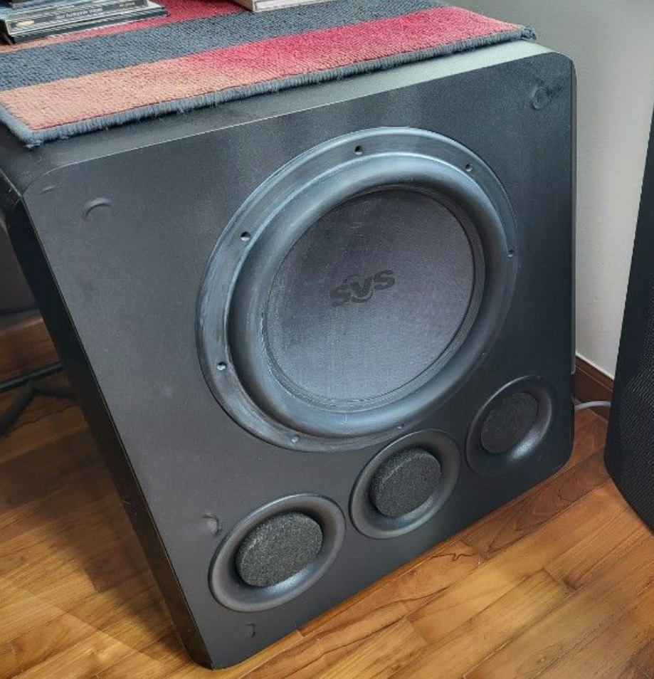

I ended up buying this:
PB12-Plus.
Tested it, seemed great with minor cosmetic damage.
Took it home...and my daughter pushed the sub and trolley over! :eek: I dunno how a 3 yr old pushes over a trolley with a 56kg sub, but she did it.
Now, when I turn on the sub, I get an electrical buzz that didn't exist before, and there is a "pop" when i turn it on and off.
Help?

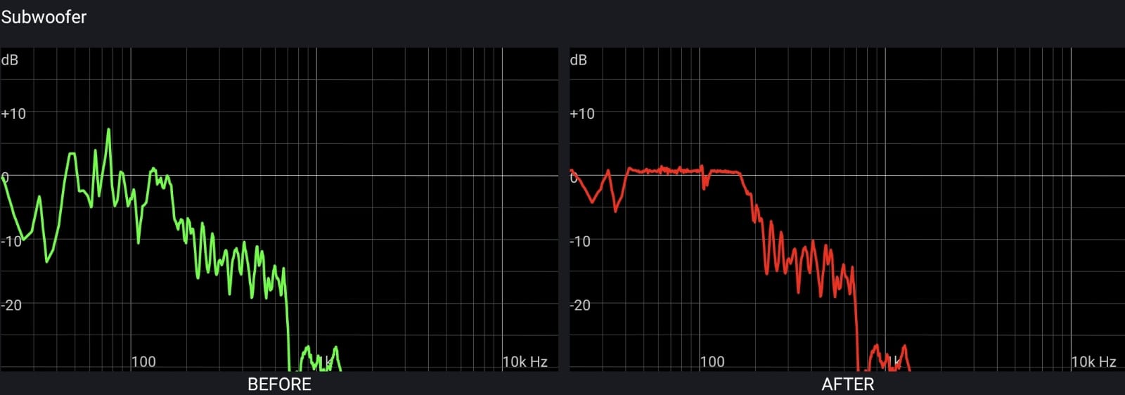

I placed the subwoofer in a corner, following the sub-crawl technique, and ran Audyssey.
Played some music (Decaf, Kendrick Lamar), and movies (Tron Legacy, GotG vol 2, Free Guy), and wow. Talk about rumble galore. I have not yet run it at loud volumes.
There is a lack of "punch"(?), and looking at the Audyssey graph, I seem to have a null around 40Hz (approx -18dB!), 70hz (-10dB) and possibly 80Hz.
I'll move the sub to another location on my next day off, and run Audyssey again.
EDIT: Here is the Audyssey graph

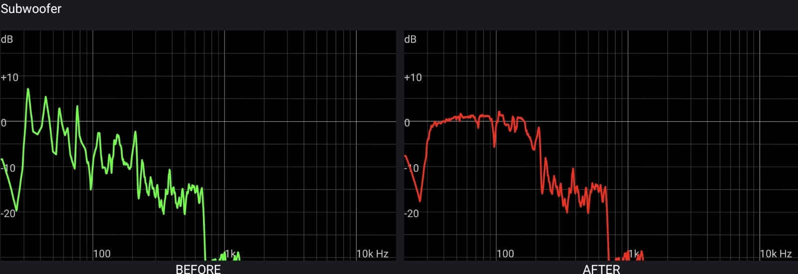

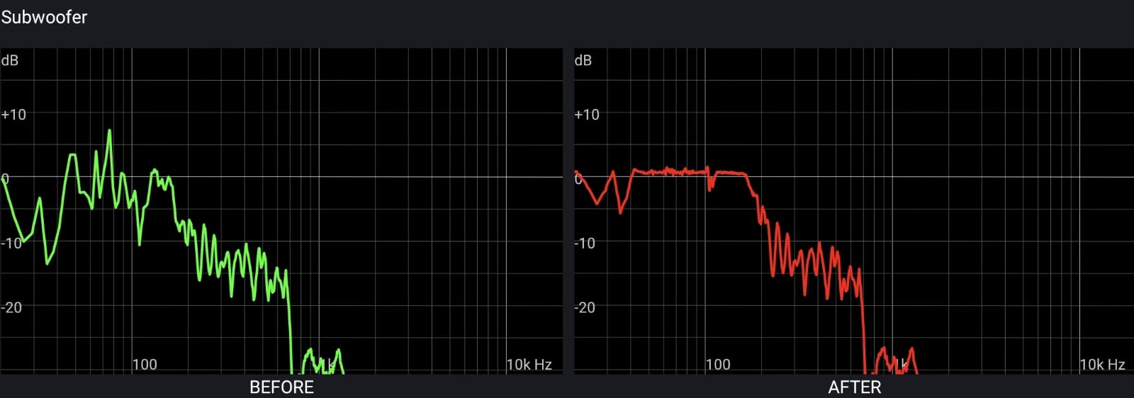

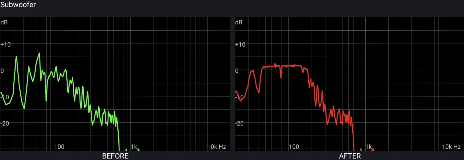

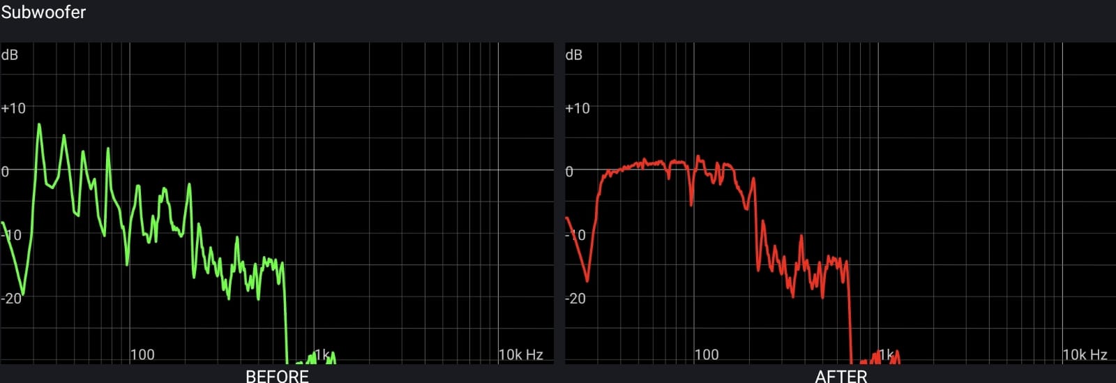

Moved the sub around the house today, and ran Audyssey each time. I tried out some music, and movie content and am not really satisfied with any of the results.
Info:
The subwoofer PEQ is set to off, phase at 0, crossover disabled, volume/gain set to 9 o'clock position, ports / tuning set to 20Hz (16Hz and sealed are the other options).
Main speakers are Q Acoustics 3050i (tower), 3090i (centre), and 3010i (surrounds).
Audyssey calibration set the following:
Front Speakers: Large - Full Band
Center: Small - 40Hz Crossover
Surround: Small - 40Hz Crossover
Midrange compression manually turned off
Dynamic EQ: On
Dynamic Volume: Off
LFC: Off
LFE Crossover: 120Hz
Below are the results.
Position 1 (Left of the sofa)
Position 2 (Right of the sofa)
Position 3 (Left of the Front Left Speaker)
There is no space next to the front right speaker.
These are the three spots I can place the sub, plus the plot from the previous post.
Listening impression:
Position 1 was very easy to localise where the bass was coming from. The bass also had a "hollowness" to it. Not sure how to explain it.
Position 2 was better, but it just seemed quiet and not as well integrated with the rest of the speakers
Position 3 really blended well with the speakers, and bass thumps were good. But once it goes to the lower frequencies, it literally was silent.
I am thinking position 2 is going to be the best starting point. But where do I go from there?
Any help on improving the sound / experience would be very much appreciated!

Why such low crossovers on the center and surrounds? You can shape your low end to have a upwards tilt with a shelving filter but first which port plug configuration are you using?
Edit: I see 20hz..
Edit: I see 20hz..
Yep. all ports open, and tuning set to 20Hz.
Audyessy set the crossover points for the centre and surround.

I spent some of Sunday afternoon tinkering on your feedback.
@everettT Alright. I'm learning! I had to Google Shelving filter, and found some useful info on ASR. Making that edit in the curve editor has really given substance to the low frequencies! Thank you for that. I am always afraid of tinkering with the curve editor incase I make the speaker / sub do something it doesn't like and breaks.
@lovinthehd I had no idea that the crossover was set by Denon and not Audyssey! I have updated the speakers to all be small, and set my mains to crossover at 40Hz (in a vain attempt to fill the null), and other speakers to 80Hz.
It's all starting to sound much better thanks to everyone's input.

I'd still try a significantly higher xover on your mains, tho.
Sure. I'll give it a try tonight.
EDIT: Would adjusting the phase or distance of the subwoofer change the measured responses? I am wondering if the calibration is not accurate.
EDIT 2: Tried lowering the main crossover. Didn't sound as good (to my damaged ears).
Phase/distance can affect it but measuring would be best.
Lowered the main crossover? You weren't using one before, were you?
ps as far as main crossover I see you did say you were going to use 40/small..... I was suggesting you raise it....
LoL! Yes. I meant raise. I went from 40hz to 80Hz. Didn't feel / sound right. I made a typo as I'm sleep deprived at the moment. The other option I can select is 60Hz, so I can try that.
