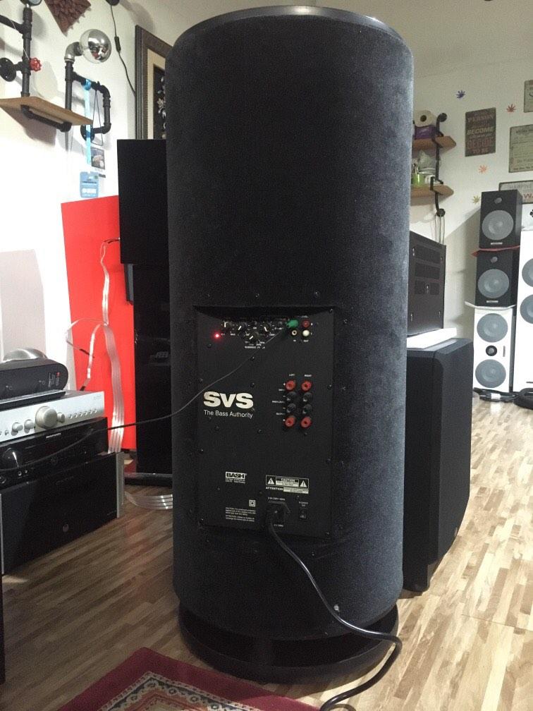

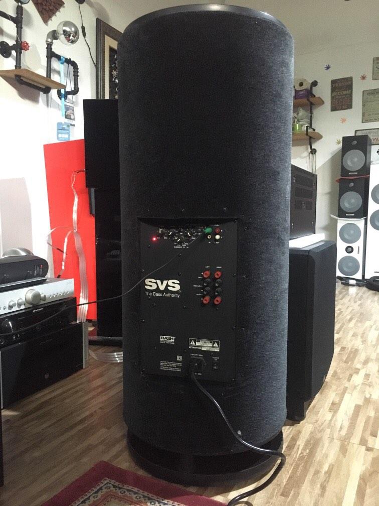

However, I did come across a secondhand listing for a mysterious 12" cylinder SVS with 3 ports. Anyone have any clue what it is? There is only one picture in the post.
It may be the PC-12 Plus....but the amp at the back doesn't match the image I found from SVS's website.

Looks like a PC12 Ultra

That sub is around or close to 20 years old. It is a pretty good sub I think. It is ported, so if the amp fails you can replace it with another if you can make it fit. It will need no special or custom Eq. If the price is right and it is working, then it might be a good option. Don't give more than $200.00 for it, in case you have to replace the amp soon. The reliability of these amps has improved a lot in the last 20 years.

It looks much closer to Circa 2004 SVS 20-39pci model. As Mark said, it is likely to be nearly 20 years old, so it must be considered before pricing it. It was initially sold in the US for $899. Its modern equivalent would be approximately a PC-2000 Pro.
I don't think that amp was in that series and I think it was three ports, IIRC.

Yea, It does look more like an early PC12 Plus. Here is the matching image:
That dates it roughly circa 2008-2009

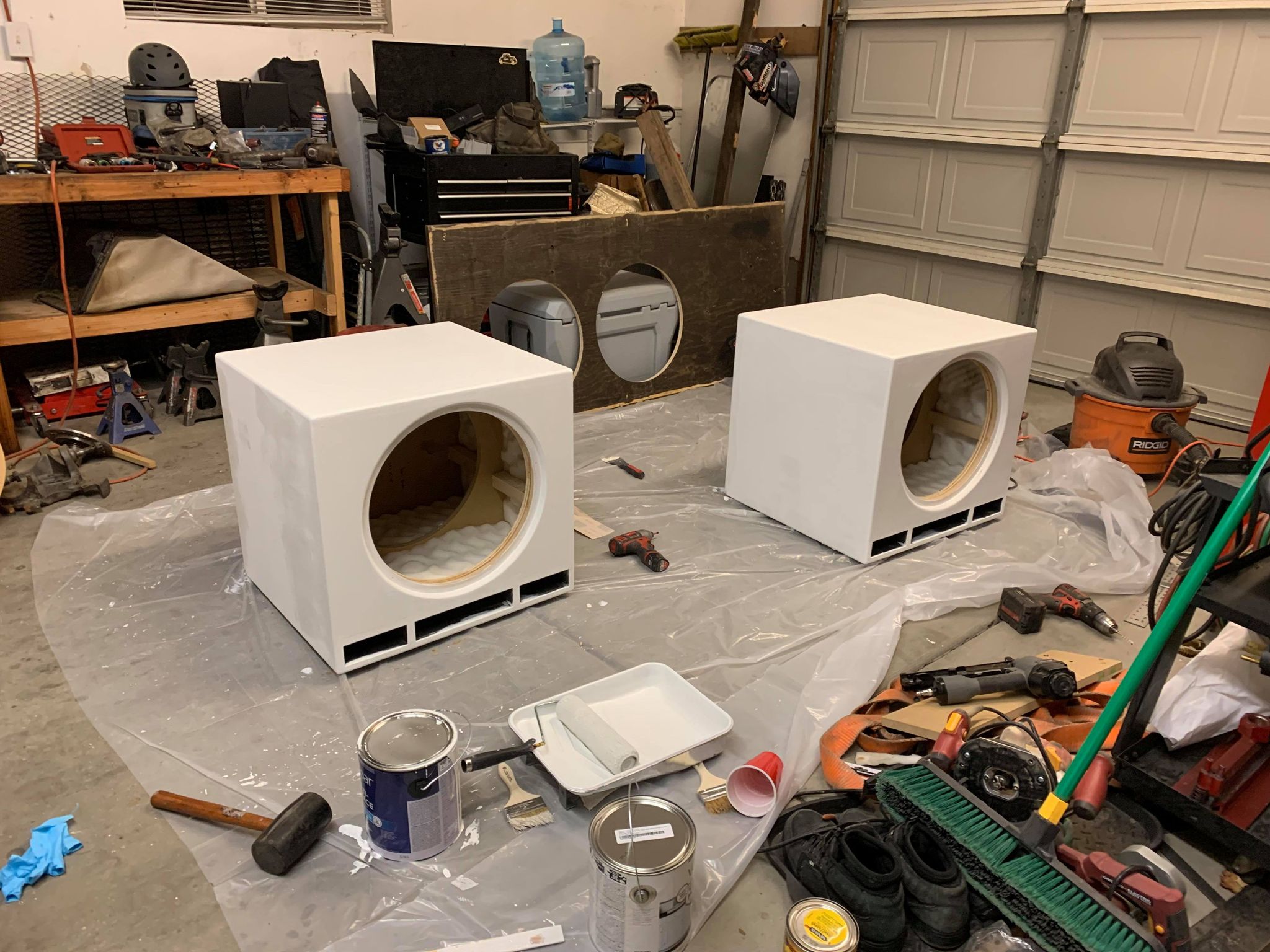

Let's source some individual components for an 18" build!

Budget be darned!
There isn't a single subwoofer included in the Op's list that's suitable for use in a 5000^3 space.
View attachment 57953 View attachment 57954
A few sheets of 3/4" material.
Look online for a B&C 18TBW100/4, Lavoce SAF or SAN 184.03 4ohm, Dayton UM18 or RSS460HO, or Beyma 18QLEX (All from Italy/Spain except the Dayton's)
Behringer NX6000D (Literally distributed out of Singapore)
Some finishing materials & a weekend of fun...
