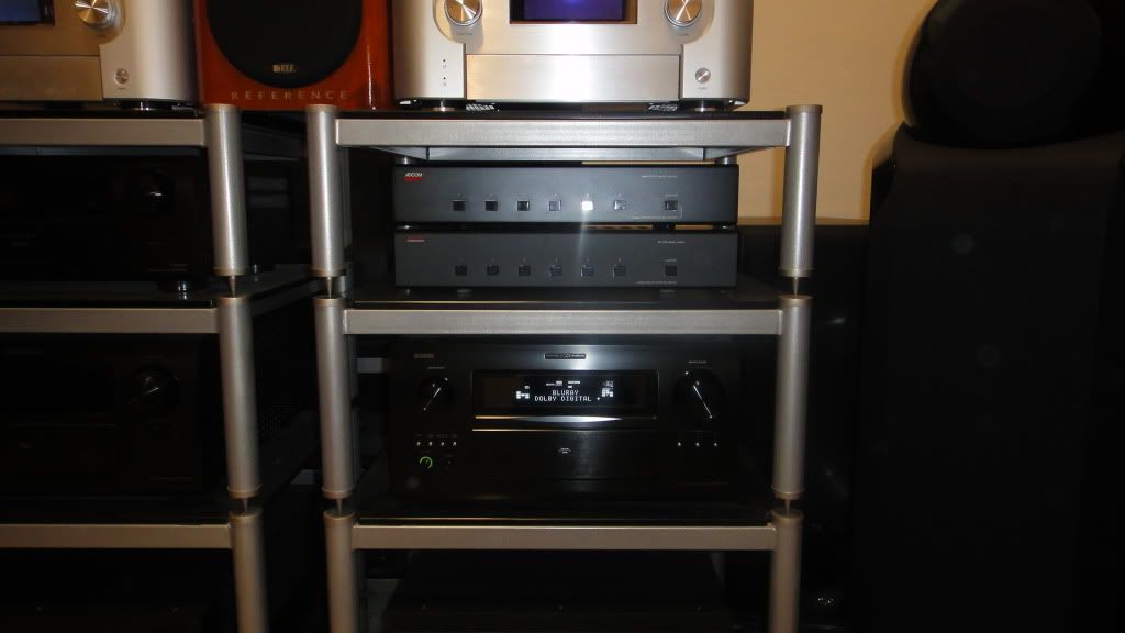

Seriously my friend, could you be more specific with the model Adcom speaker selector you have? Thanks :)
Cheers Jeff
It is the Adcom GFS-600.
GFS-600 - ADCOM-USA
You thinking about getting one for your future speaker collection? :D
I should have bought it from eBay. After I bought a new GFS-600 from Amazon, I bought 2 GFS-6 from eBay - one for the family room speakers, and one for looks. :D
GFS-600 - ADCOM-USA
Thanks my man, no I just want it for looks also :D
