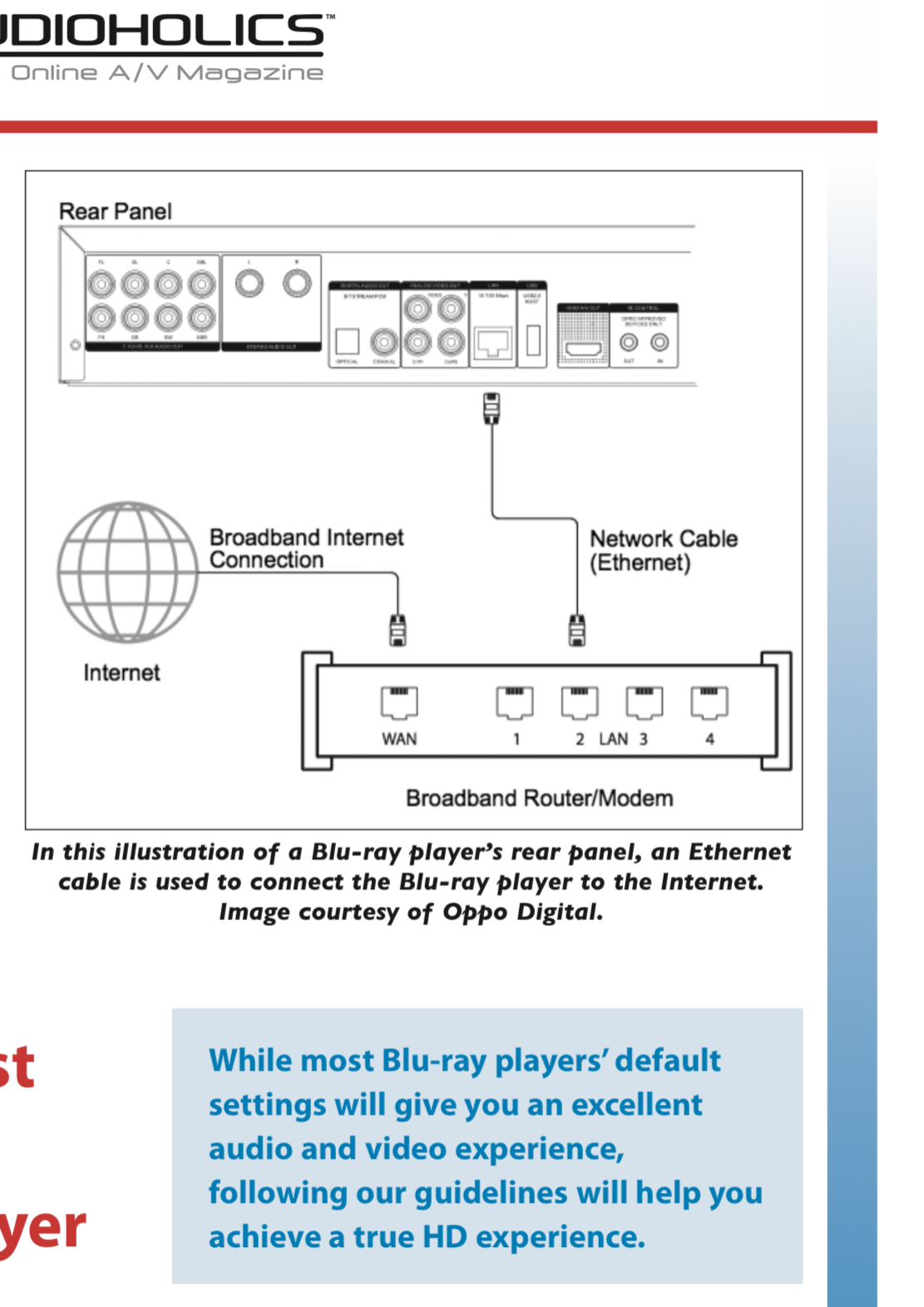

Audioholics talks about connecting my Blu ray player via the Internet. This may sound basic, but I don’t want to sacrifice any quality or audio sound hooking up anything incorrectly.
My tv is currently hooked up the wall with a cat6 cable. So In order to connect my Blu ray player based upon audioholics recommendations (see below) am I connecting my blue ray to the tv or at I getting a splitter to connect both my TV and the Blu-ray player to the wall? I also have an AV receiver and I will be hooking up 7.2 Atmos. I don’t want to hook anything up incorrectly that will jeopardize my video and audio experience. I will also be using blue Jean HDMI cables.

If you are going to connect more then one device to that Cat6 cable at the TV, then you need a local Ethernet hub. So you connect that cable to the hub input and connect Cat6 cables between them and the local hub.
You could just use wifi for the bluray player, too.
He could, but hard wired connections are better, especially for updates. Hubs and Cat6 cables are cheap. I only use Wi-Fi for mobile devices. Anything that does not move is wired.

If you have multiple devices that require network access, but you only have a single port that goes back to your router (modem), then you will need to split that connection so you can hard wire in your multiple networked devices. The network connection will not impact the quality of video from the Blu-ray player or other devices. Likewise, using a hard wired connection provides the fastest, and most secure way to connect to the Internet.
To split that single incoming Internet connection, you will typically use a small network switch. These are readily available from Amazon or Newegg and aren't expensive.
$16 on Amazon: https://www.amazon.com/Ethernet-Spl...anaged-TL-SG105/dp/B00A128S24/ref=sr_1_2_sspa
This 5-port switch is connected from your wall to ANY of the available ports. The switch is smart enough to know where your Internet connection is coming from, so you don't have to use any specific port as the 'Internet IN' connection. Just connect it to your wall, then connect your Blu-ray Disc player to another open port on the switch, and connect your TV to an open port, and connect your AV receiver to an open port.
This will give every device that needs it, in your equipment rack, a hard wired connection to the Internet.
If you add other devices that need a network connection to your equipment stack, then you can connect them to that switch until it is filled up. If you think you will have MORE devices than a 5-port switch can handle, then I would recommend getting a larger network switch that can handle all the devices you intend to use.
