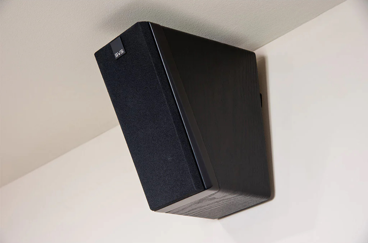

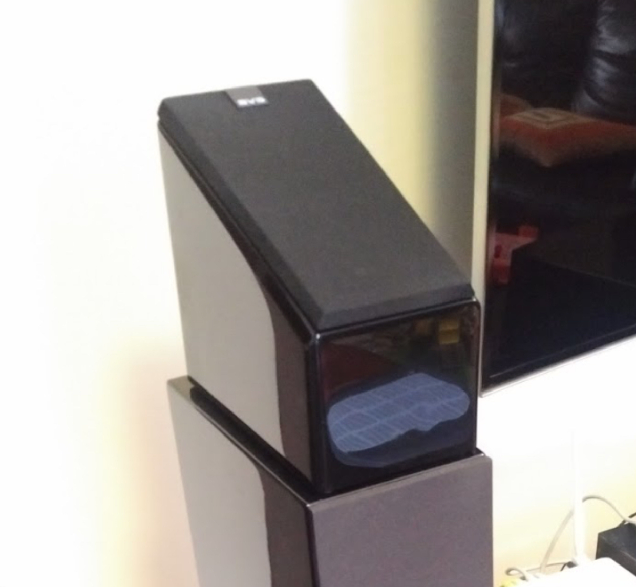

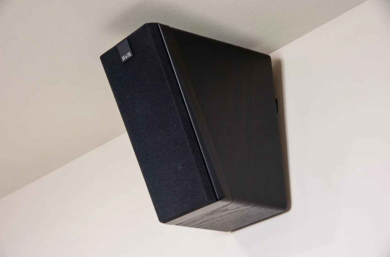

As @William Lemmerhirt mentioned, and I mentioned in an earlier post, the height speakers need to be placed accordingly. If being placed atop other speakers, they need to be on their backs to bounce off of the ceiling. If placed on the wall, they need to be angled downward.

Thanks for sharing the pictures, that's very clear and it's easier for me to place them on their backs to bounce off of the ceiling than hang them on the wall (less drilling is better as the house is rented). However I'm sure they'll sound better if placed on the wall angled downward.

I’ll be happy to elaborate further later. But trebs advice is solid. You will have to change them in the AVR menu to Dolby Atmos Enabled speakers. Do not select height or top settings.

Did you remove the banana plugs when you placed them atop of other speakers, I tired and it didn't work. Probably I'll have to place rubber feet underneath them to avoid damaging the banana plugs and raise the speakers.

Sorry, the pic was not of my speakers. I suppose they applied rubber feet to them.
