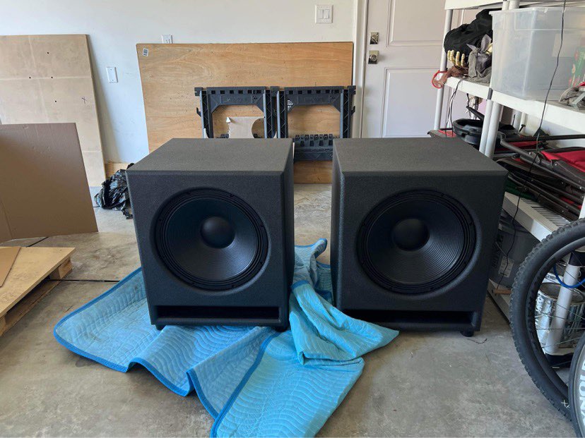

A pair of our finished MC18 with LV SAF drivers getting ready for placement in their forever home

Uh, they're not dogs or cats- not much in audio is 'forever'. :)
Seriously, you have a Dennis The Menace Park?
Dogs & Cats also aren't forever. Our client must have whatever you're seeing.

Only diamonds are forever, but many end up in the pawn shop to finance nice subs.
Didn't see the smilie, eh?
What drivers are you putting in these cabinets? I have heard of the Marty subs for quite a while, but haven't talked to anyone who uses them. Any customers in the Milwaukee area?
To best answer this I'd need a better idea of which size Marty you'd be interested in using.
Here's a link to our available drivers - https://shop.gsgad.com/collections/subwoofer-drivers
Mini Marty 18" - Marty Cube 18" & Full Marty 18"
Then we have the Marty 21" & BTS 18"/21"
