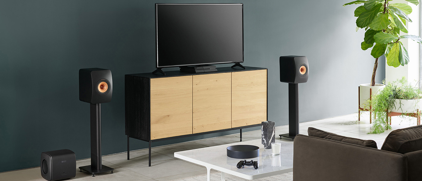

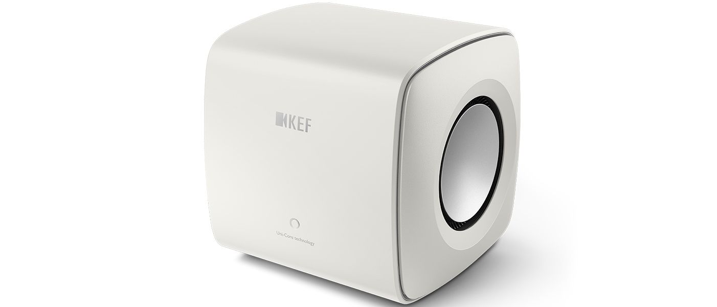

I haven't' shopped for subs in years... the Kef KC62 looks pretty neat though... (and is around your budget)
I have a pair of Gallo TR1's that do a nice job... - which I've had for about 10 years... they would probably be a bargain on the used market... (TR1 or TR3)
Just look for true sealed designs... fully sealed - where the pressurised air inside forms part of the suspension for the drivers... not the designs where they put a semi-plug in the port and call it sealed - they are currently out of fashion - they use slightly differently designed drivers, with a softer suspension I believe, and the air inside then forms part of the suspension of the driver, resulting in lower distortion - they tend towards being a little less efficient (lower SPL/w) but they also, as a genre, tend to do a LOT (!) better on music - get the tones/harmonics right, rather than the earthquake effects.

A dual opposed 6.5" "sub"? Seriously? For $1500 yet? Good grief. Why is such a small box desired? Hamstringing a sub doesn't mean it's more musical....good grief.

Yes I do mean acoustic suspension from the old days (still current in designs like the KC62, or the Gallo TR1/TR3) - it uses a softer woofer surround - less resistance/less distortion - but still achieves the required suspension action through the compression of the air within the sealed Box/Cylinder...
Most of the woofers available today, are designed for ported designs - so they have much heavier suspension surrounds.
It does have constraints... if you consider max SPL output of 105db a constraint.
If the listener is a fan of the Harman Curve with +10db in the bass, and uses an average listening volume of 85db - then it isn't a constraint - you still have 20db of headroom
My own average listening level is around 75db... so this would be far from constraining !!
But tastes, and the ability to bear loud sounds, varies with the listener - some might seek max SPL's of 110db or more... - not me!
Also I strongly believe that many (most?) subwoofers sacrifice distortion for SPL's - they go low and loud, but they also have very high THD - which matters not at all for a home theatre LFE subwoofer, intended for explosions and earthquakes.... but if you want to get the tone of a double bass or Harp right, (bottom note fundamentals of 41Hz and 31Hz respectively) - then most of the "effects" focused subs are a bit of a "blunt tool".
