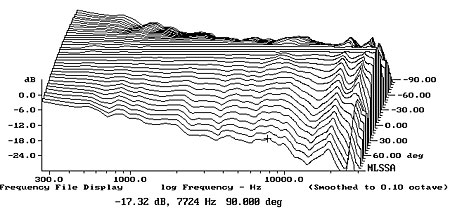

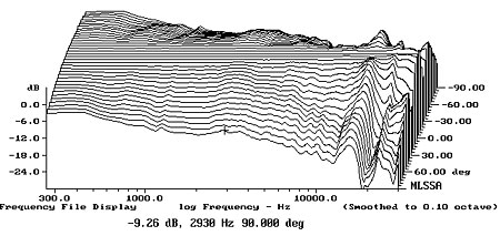

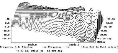

It's not the Q900, but this is a look at the horizontal off-axis response of a KEF coaxial speaker:
and the PSB T6
The KEF definitely has more attenuated reflections, which I guess would mean the direct sound is more dominant relative to the reflected sound. I would presume this is why it would have a wider sweet spot.

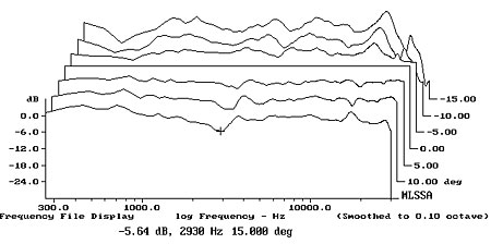

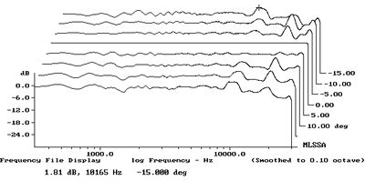

Also, a slight look at the vertical response:
KEF
PSB

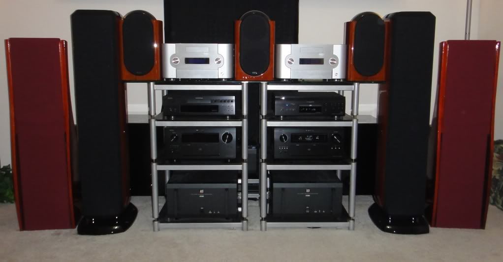

In my limited and humble experience, speaker placements can make difference - not always, but they can. And some of the differences they make can be dramatic, but some of them are minute.
For example, moving the Orions far away from the walls seemed dramatic. Moving the Def Tech BP7000 away from walls and aiming their subs away from walls seemed dramatic.
But moving the KEF 201/2, Revel Salon2, and even Infinity P362 around (close to wall, far from wall, angle/toe in, etc.) seemed to make very little difference.
I also remember that my brother's friend Phillip had his Salon2 6 inches from the walls, not toed in at all, and they still sounded superb.:eek:
So theories are great and all, but in real life they may not be like you think.
That's how life is, right?
Things never happen exactly the way you plan?:D

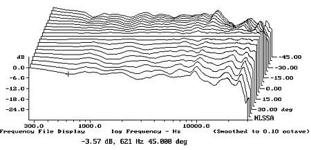

Here is another example of a KEF polar response:
