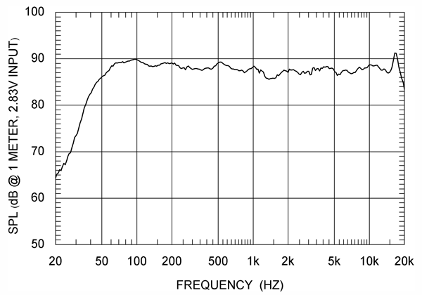

PSB T6 Listening Window
Axiom M80 Listening Window (version 2)
The PSB has a more natural response between the two.
The PSB does look smoother than the Axiom and probably more balanced.
But doesn't the Axiom look pretty good from 200Hz - 10kHZ?
It does, but to me the PSB is a known quantity. I know for sure they sound good with classical music. You are right about them being smooth and balance. In a small room it does not need a sub either. I think the OP can flip a coin to decide going with the KEF or the T6.

Home Theater Magazine reviewed both the PSB T6 & KEF Q900:
http://www.hometheater.com/content/psb-image-t6-speaker-system-ht-labs-measures
http://www.hometheater.com/content/kef-q900-speaker-system-ht-labs-measures
The Image T6’s listening-window response (a five-point average of axial and +/–15-degree horizontal and vertical responses) measures +1.88/–1.74 decibels from 200 hertz to 10 kilohertz. The –3-dB point is at 48 Hz, and the –6-dB point is at 41 Hz. Impedance reaches a minimum of 3.92 ohms at 413 Hz and a phase angle of –59.85 degrees at 69 Hz.
The Q900’s listening-window response (a five-point average of axial and +/–15-degree horizontal and vertical responses) measures +2.25/–0.65 decibels from 200 hertz to 10 kilohertz. The –3-dB point is at 44 Hz, and the –6-dB point is at 39 Hz. Impedance reaches a minimum of 4.02 ohms at 145 Hz and a phase angle of –38.32 degrees at 3.5 kHz.
If you can listen to both in store, that would be great for you.
I think they both have great measurements. They also measure almost the same. Both have a sensitivity of 91dB. Both have minimum Impedence of ~ 4 ohms. Both appear accurate/linear/flat frequency response. The PSB has a 200Hz-10kHz window of 3.62dB (1.88+1.74), while the KEF is 2.9dB (2.25+0.65).
If you are not going to use a subwoofer, the Q900 will give you a little better bass. Otherwise it is pretty much a toss-up as PENG said.
A lot of that has to do with the narrow measurement window, though.
The KEFs are going to have more controlled directivity, and a larger "sweet spot." They will also have lower image width due to the comparative lack of lateral reflections, unless they are properly crossfires.
3db
3db
explain this
GranteedEV
GranteedEV
It's not the Q900, but this is a look at the horizontal off-axis response of a KEF coaxial speaker:
and the PSB T6
The KEF definitely has more attenuated reflections, which I guess would mean the direct sound is more dominant relative to the reflected sound. I would presume this is why it would have a wider sweet spot.
Also, a slight look at the vertical response:
KEF
PSB
Now regarding the crossfire, I believe it's only to widen the sweet spot, not the soundstage. It definitely doesn't increase lateral reflections except at opposite ends of the room.
