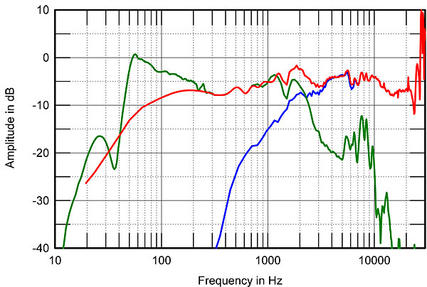

Fortunately for us, Stereophile plotted the curves for tweeter and woofers separately. And in doing so, we now know that KEF does not care about the lower end models. The crossover does not suppress the break up one bit and the metal cones ring like bells. If that region is to be excited by music, it would sound very harsh indeed.
All that those speakers need is just one extra part in the crossover. Just one! And this one part makes all of the difference between a well engineered speaker and one which has severe distortion in the midrange. A savings of $2 practically ruins the entire product. I'm actually very disappointing in KEF, who I ALWAYS held to extremely high standards.

Does Stereophile plot the tweeter and woofer separately on all speakers, or JUST the Q900? :D
JA: I attempted to measure the speaker's (Q900) true farfield low-frequency response by placing it 8' above the ground—easier to say than do! —in the center of my back yard, and positioning the microphone to get the maximum path-length difference between the Q900's direct sound and the reflections from the walls and ground.
So he measured the Q900 differently than all the other speakers.
What would we see if he measured all the speakers this way? More compromises than expected?
IOW, if he had measured the Q900 like he does with all the other speakers, we probably wouldn't even be talking about this issue. :D
But again, it's still just his one measurement in his back yard, 8 ft above the ground. How the speakers actually sound to us is another story.

It's not necessarily how he measured, but what he measured :) The measurements of the KEF900 were actually at tweeter's height and at 50" mic distance. They pretty much measure all of their speakers the same way. But this is what's interesting to look at:
Look at the green trace, the woofer(s) response. Major break-ups between 5500Hz-9500Hz. It even shows up in the red trace, which is what Stereophile usually only posts. By looking at the medium sized wrinkles on the red graph, it's hard to judge the true performance, unless we can see the individual driver's roll-offs, or distortion graphs (which Stereophile doesn't publish for some reason). So yes, the overall SPL looks more, or less acceptable. BUT! If the region between 5500Hz and 9500Hz is excited by music, the distortion would literally be through the roof! And right smack in the midrange, no less.
It's actually a very poorly designed speaker.
P.S. NHT has also been reported to sound rather harsh in it's upper midrange and I suspect the same lack of care in the crossover holds true for the overrated Classic Three. Take a look at these measurements: SoundStage! Measurements - NHT Classic Three Loudspeakers (3/2007)
Notice it has the same break-up visible in the overall SPL graph? Now if you look at the distortion graph, this same region (6000Hz-8000Hz) all of a sudden spikes.

I wonder if KEF ever responded to that Q900 graph on Stereophile. :D
Well, a lot of people seem to think the Q900 sound great, in addition to HTM, John Atkinson, and Kal Rubinson. KEF cut some corners on the Q900, but apparently not enough to detract the SQ.

I'm sure the KEFs sound okay in the midrange from 200hz to ~3khz. Maybe forward though.
I'm also sure your B&Ws sound good in that same range.
It's above there that the KEFs raise an issue with me. Not only the aluminum driver but also the tweeter response itself.
