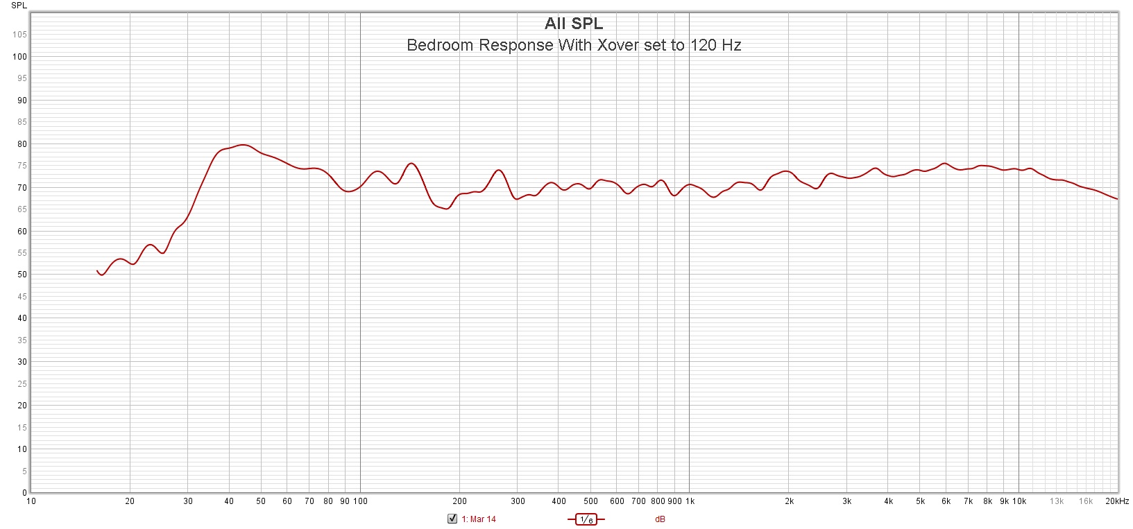

3db

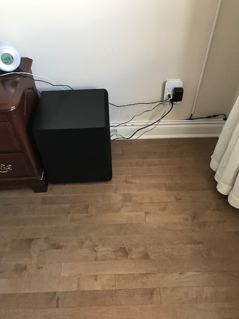

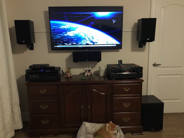

Update to the room. I've been a very busy boy lately with a laptop in my back pocket and a new UMIK1 microphone. The sub used to be located here..
I went location hunting to find a better spot for my little 10" sub using REW. I tired a couple of spots and wondered if the sub would sound better in the opposite corner behind the lazy-boy as shown here.
I ran the measurements for each location and this what I found.
The red plot is where I had the sub before using REW to relocate the sub. The green plot shows the response with the sub at the new location.
3db
3db

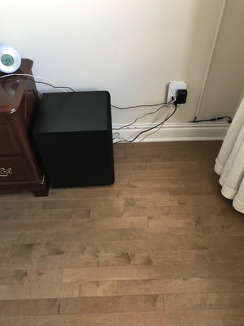

I did some more tweaking on the bedroom and moved the sub to here.
The sub is firing towards the right. It used to be pushed into the corner (left of the curtain and firing towards the curtain. It smoothed out the bass response a little more. This room was sooo much easier to set up then the basement.
Ponzio
Ponzio
If the frequency graphs are accurate, and I don't see why they wouldn't be, it's pretty smooth indeed.

Three weeks ago, I under took a monumental effort (monumental for a 60 yr old guy now living alone) to finish painting the up house interior which was the stair well, and the top floor. I painted the basement and main floor last year. I saved painting the master bedroom for the last as it required me to dissconnect all my speakers and remove them from the wall, disconnect the TV and take it off the mount. I even removed the TV mount its self. Here's the finished picture of the master bedroom looking at the display point of view. A before shot and after shot.
The before shot
Now the after shot

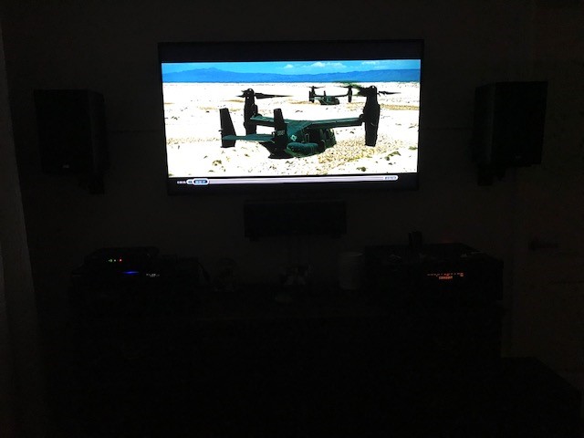

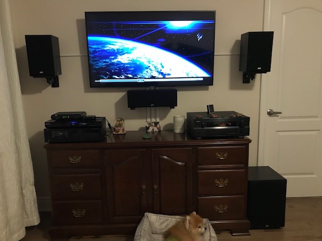

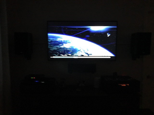

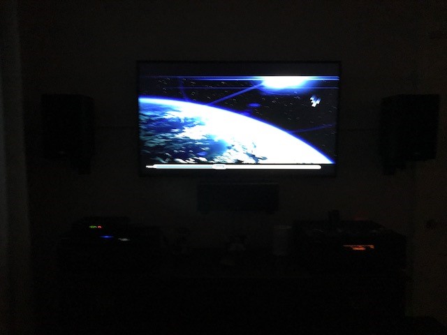

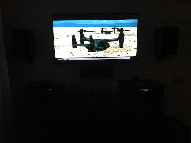

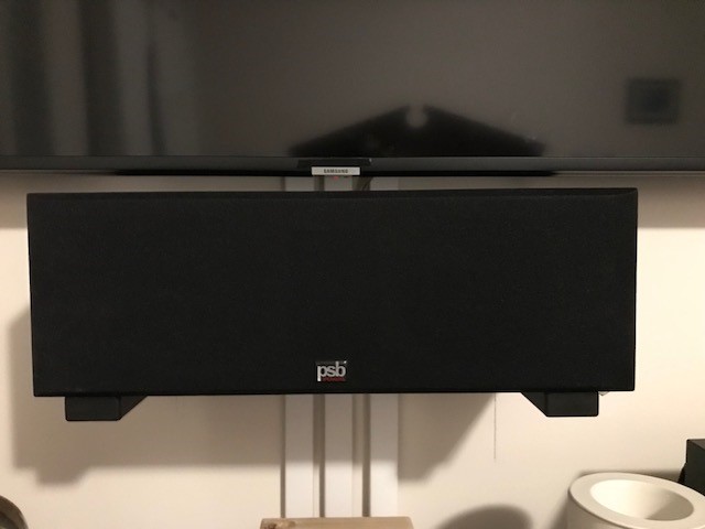

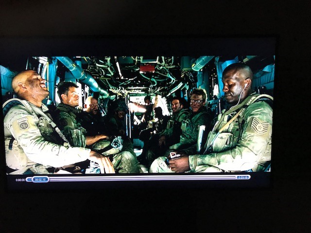

Here are some updated pics with the new Samsung display. I had to lower the center channel speaker a bit and used the opportunity to hang it straight. Those logitech mounts aren't the greatest to square. I squared them initially on the verticle plane but the horizontal plane was slightly crooked. I hung then squaring them on the horizontal plane as its most noticeble there and the verticle plane is slightly off but hidden behind the speaker so its not noticeable.

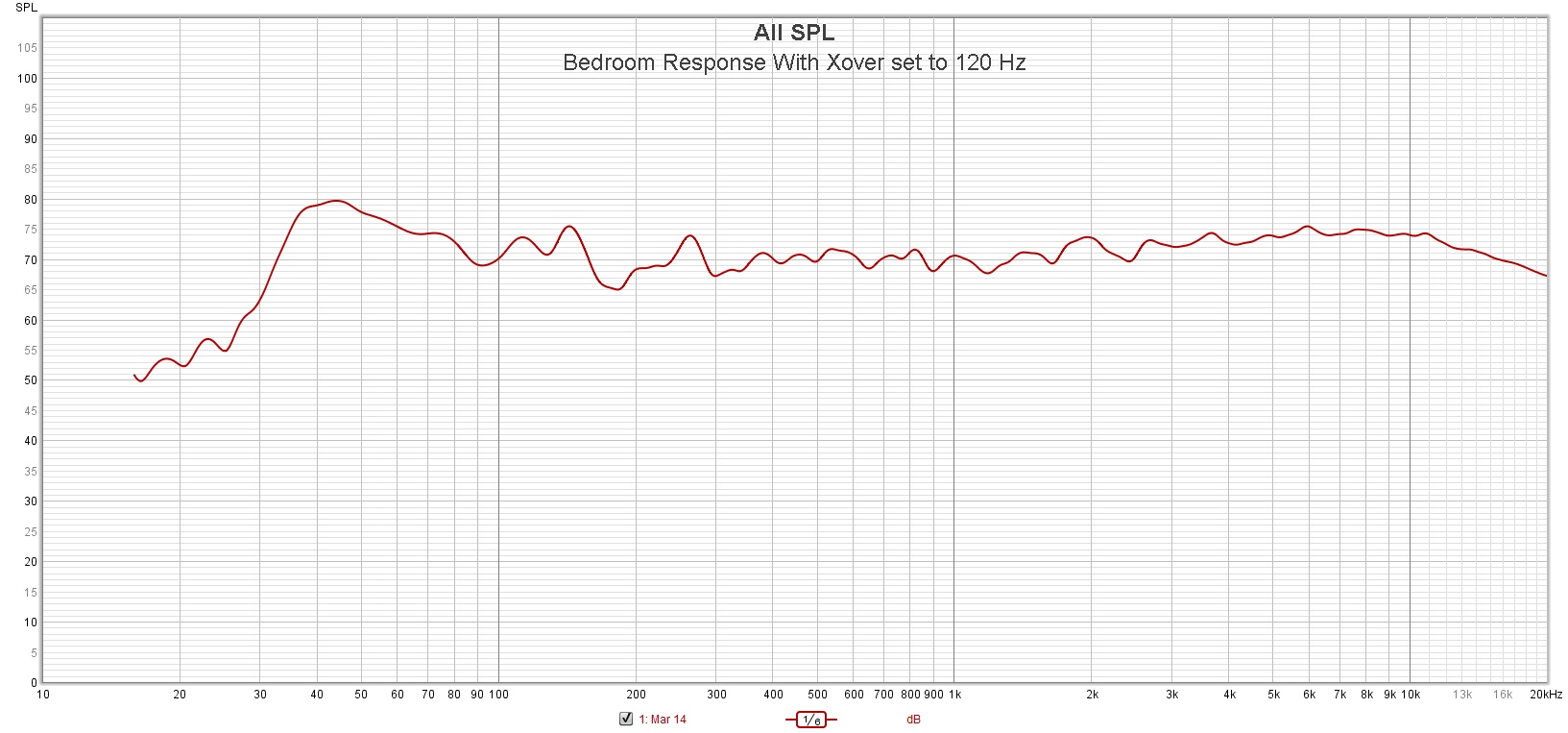

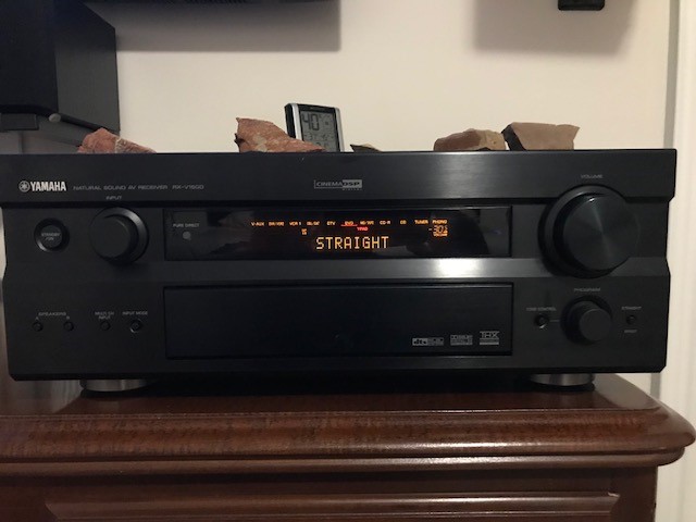

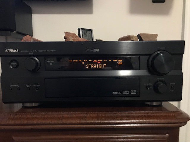

I finally got around to measure the room with new used Subsonic 7 15" sealed sub. I also learned something new in the behaviour of the RX-V1075 and why I was getting sub response from Pure Direct Mode while using an HDMI input.
The first plotshows the difference in in-room response between the Subsonic7 and Subsonic 5. The sub7 was placed in the same location as the sub5.
The next plot shows the response with YPAO set to through (no room correction).
The red curve sets all speakers to small and is running a little "hot" . I have to try some blurays but I suspect I may have to tone it down just a smidge.
The blue curve sets the fronts to large but also uses the sub with a feature called Extra Bass which is only selectable when the front speakers are set to large. I have the sub value set to -7db on the AVR . I use this setting for listening to music. It sounds pretty good.
The green curve is Pure Direct so there is no sub response from the Extra Bass feature.
Now the thing I learned about the RX-V1075 ( I suspect all RX-A models behave the same way) is that Pure Direct does not change the speaker settings from small to large which I believe my old RX-V1900 is doing . The speaker settings remain fixed at the values chosen in the Speaker Config Menu. Depending on weather, I may play around tomorrow with the RX-V1900 and verify that with measurements. And here I thought I had a good handle on Yamaha. :rolleyes: Shitty f'in manuals!! :D

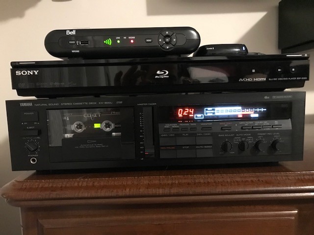

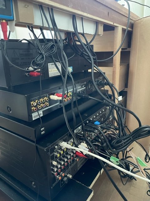

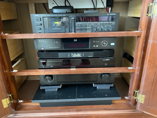

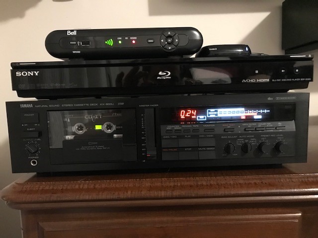

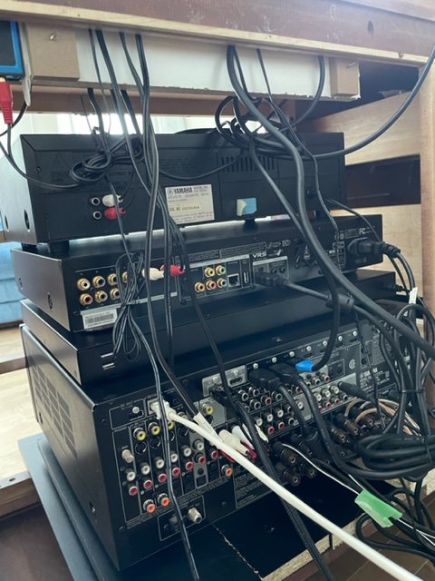

I received my Infinity T10 forward blowing fan yesterday and I read the comments that @ryanosaur wrote about his ability to hear the unit from his seating position 8 ft away. He has the same unit. I placed the unit on top of my dresser/converted media console plugged it in and I was able to hear it. Sooooo, I decided to use it but to place it in my bedroom system for two reasons: 1) I barely ever do any critical listening there 2) I'm tired of the rickety setup I had of a wire shelf being balanced on top of my AVR holding up a cassette deck and bluray player. It went from this
to this
I ordered a rear vent unit for the greatroom setup.
3db
3db

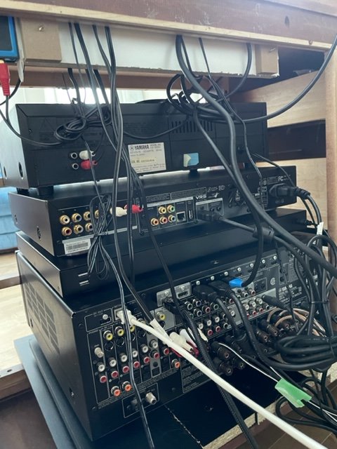

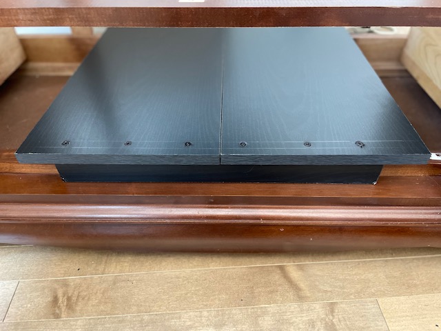

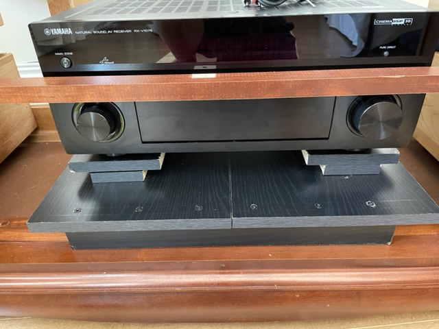

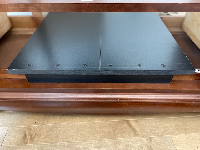

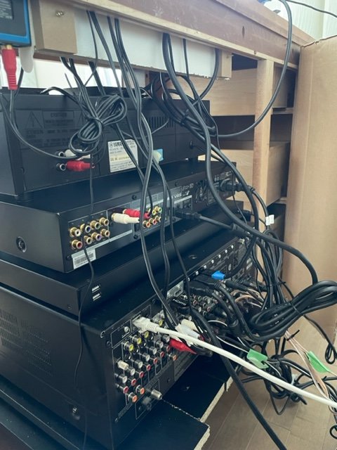

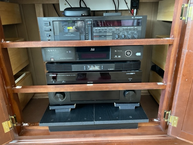

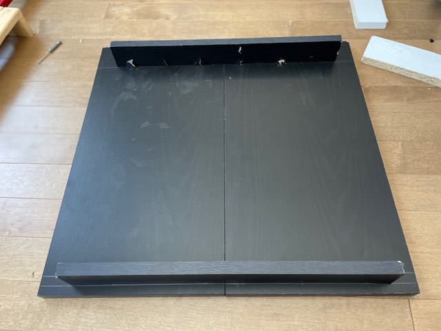

I turned my attention to redoing the shelf support in the converted dresser/stereo stand. I'm so tired despite having stopped for lunch. Here are the before shots
3db
3db
I'm no wood worker and can't cut a straight line with a skill saw if my life depended on it. I guess that's why they call it a skill saw
:rflmao:

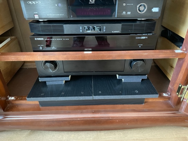

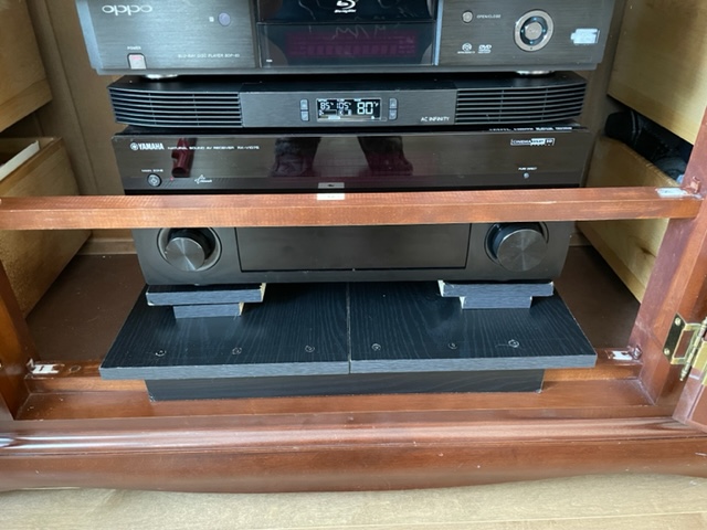

Here are after shots
3db
3db

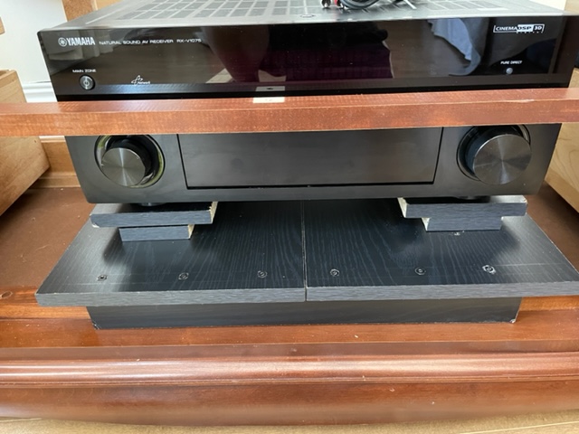

I swapped out the RX-V1075 for an RX-A1060 but never bothered to run YPAO. I took pictures of the old setup and used them to set speaker distances and channel volumes on the new system setting the EQ to through (off).
I have setup this AVR like I did with the other two in that I use two speaker patterns that are available on the AVR. I set pattern1 for movie and pattern2 for music.
I decided to run YPAO to check distances and channel volumes. I then tried to get a smoother integration of the one sub to the mains by playing with the sub distance.
The old Pattern1 setup
The new Pattern1 setup.
The distances and channel volumes were identical from the old and new except for the sub. I manually tweeked the sub distance to get a better integration of sub to mains. The blue trace was measured before playing with the sub distances. The red trace is what I managed to achieve by playing with the sub distances.
The old Pattern2
The new Pattern2 setup
The orange trace is before tweeking, the green trace is after tweeking the sub distance. Pattern2 sets the mains to large but I still augment them with the sub using the extra bass option.
