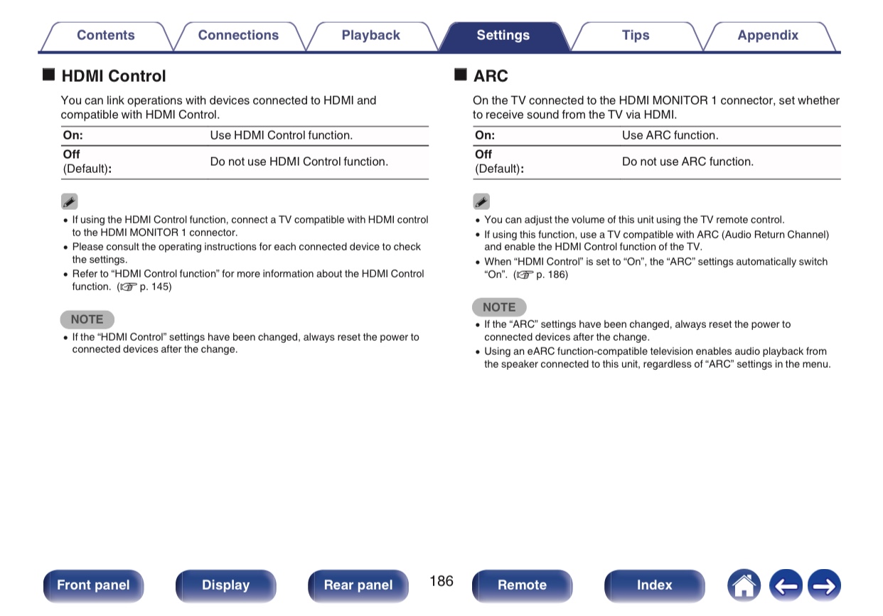

Welp, nevermind. Found this in the PDF manual (page 231):
3115419
