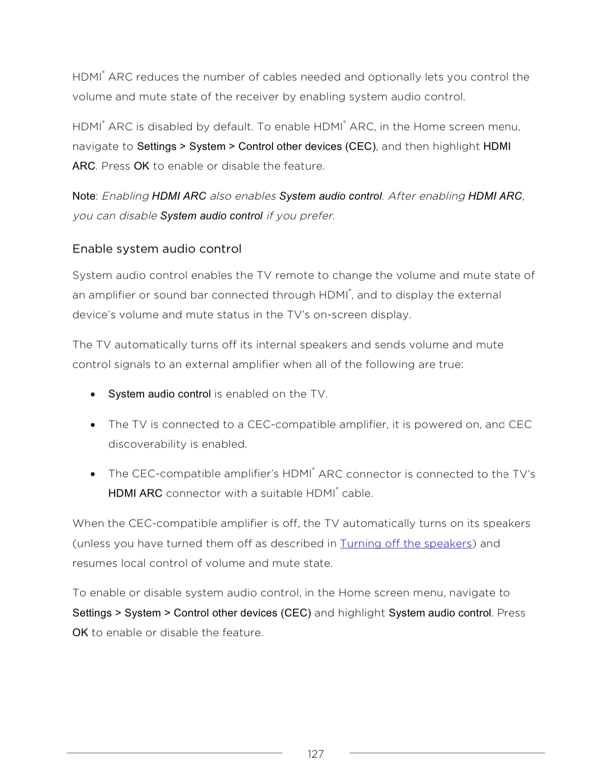

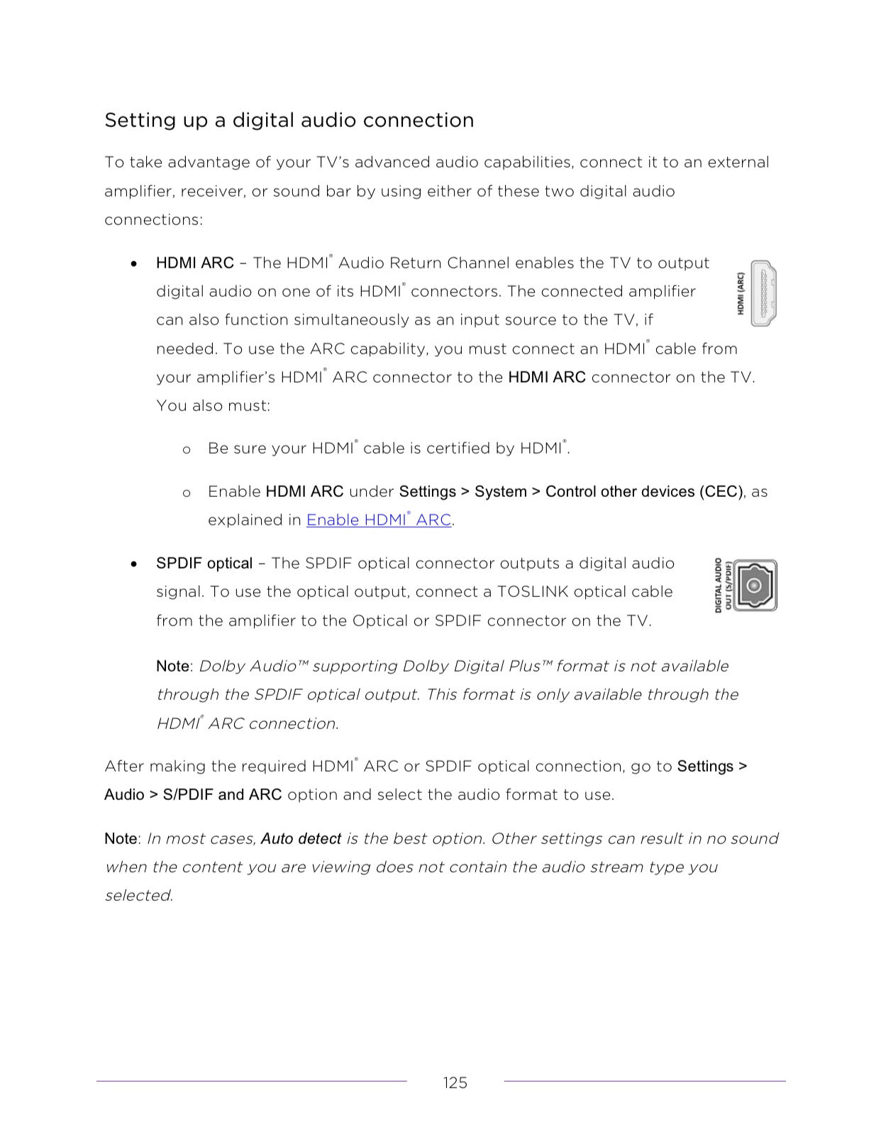

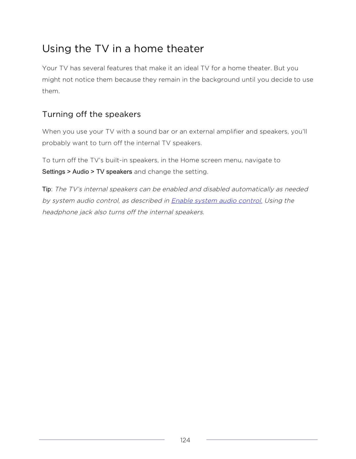

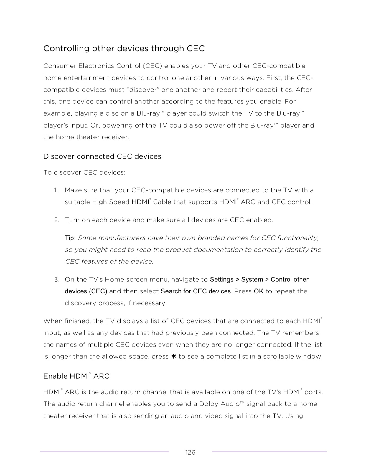

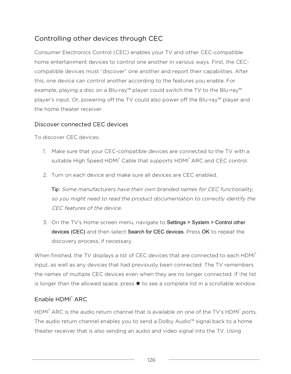

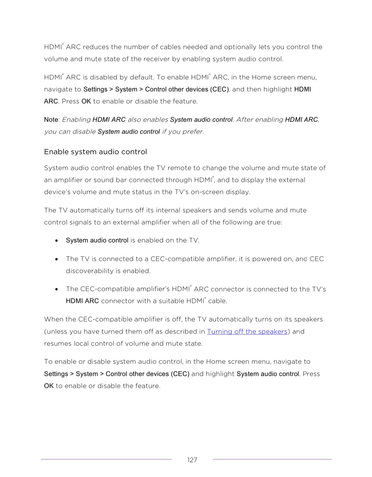

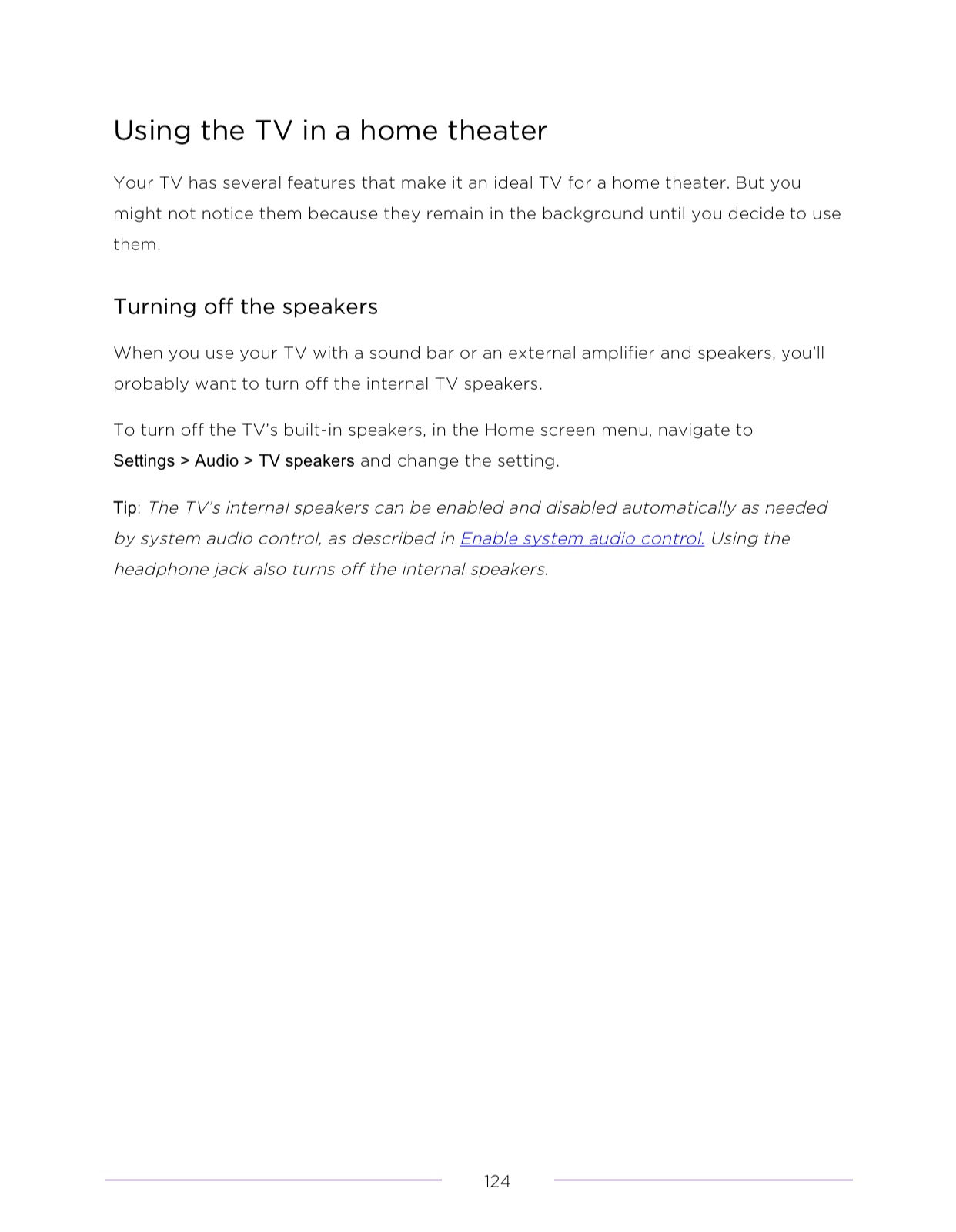

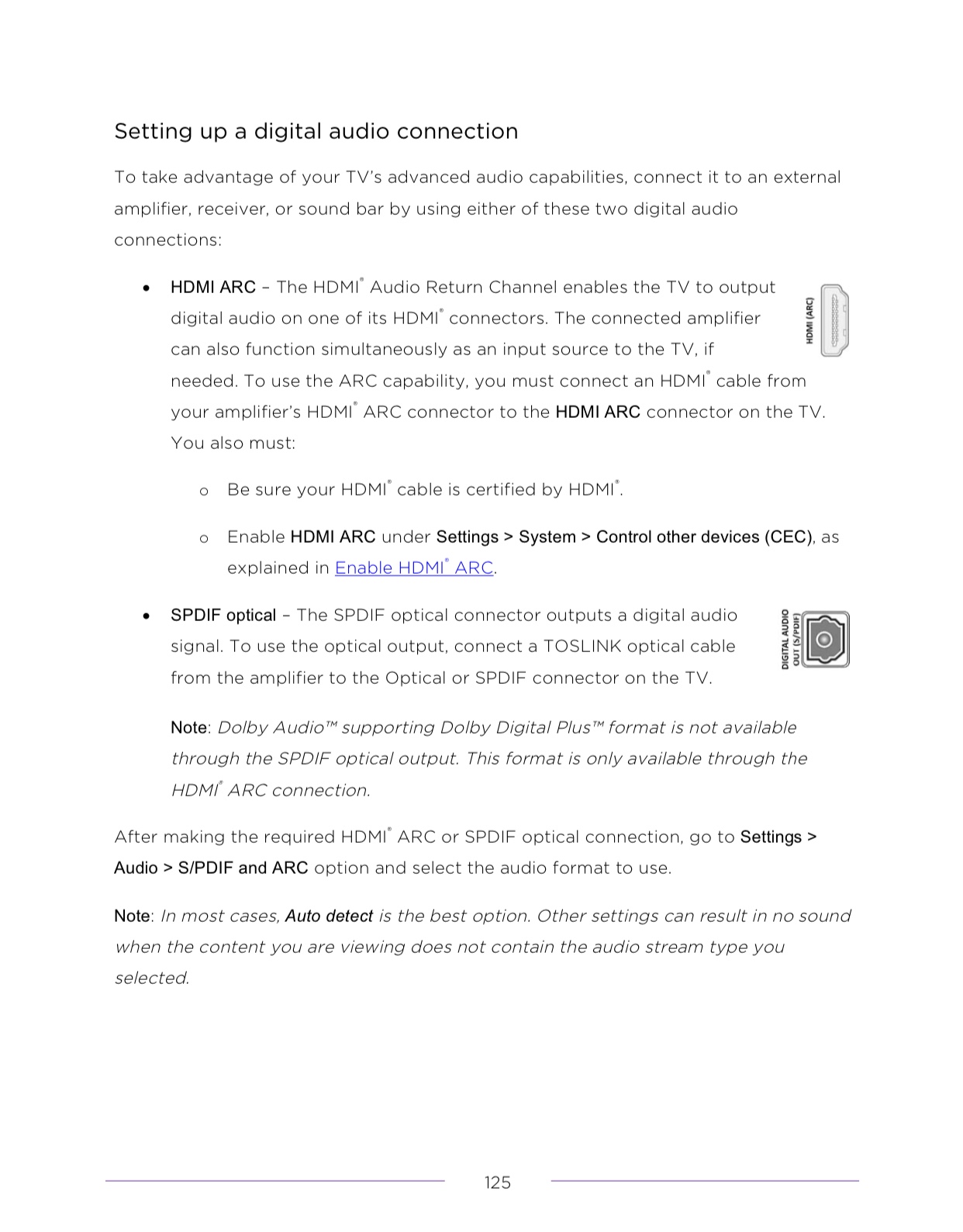

ARC issues can be maddening. I’m sure you have followed the TV instructions for ARC activation but here they are in the event that settings were changed. Good luck with it all.
Panayoti3000
View attachment 45840View attachment 45841View attachment 45842View attachment 45843
So these are amazing and compact instructions for the activation of my earc and CEC through tv. The one big factor I notice here after doing many of these steps is that my tv does not sense any CEC connected devices when I do the scan and I have done this numerous times. I'm feeling that it's my stupid tv that doesn't sense the receiver or maybe an incompatibility with the TCL and my Denon that hasn't been discovered. I've tried all the resets and although Ive had issues with the system staying enabled, I know there is hope because the malaka worked for awhile. I'll follow these instructions yet again one by one and see. What else I wonder?

Ok, so make sure CEC is on in any device that supports it. Connect other devices that support it directly to the TV and scan for devices. If you still get nothing, it is the TV and not the Denon.

Many prefer the receiver to be the switcher as do I. I just wanted to rule out the receiver as being the faulty device in regard to HDMI-CEC by connecting other devices directly to the TV to see if it detected them. Make sure HDMI-CEC is on in each device. The sat receiver may not support it. Any port should work with HDMI-CEC. The ports labeled ARC/eARC are the ones to use to connect the TV to the receiver to get the TV’s audio via built in tuner, apps or directly connected devices back to the receiver. I’m in the “it’s everybody’s fault camp” as their is no real standard for manufacturers to adhere to when implementing HDMI-CEC features including ARC. Hell, they aren’t even under any obligation to call it HDMI-CEC and most manufacturers have their own designation for it. I've chosen to use it but have and surely will continue to have issues with it from time to time.
