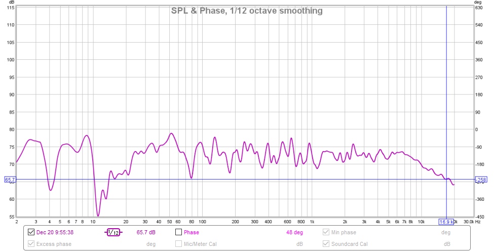

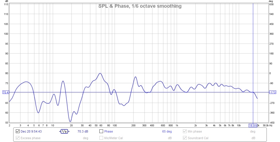

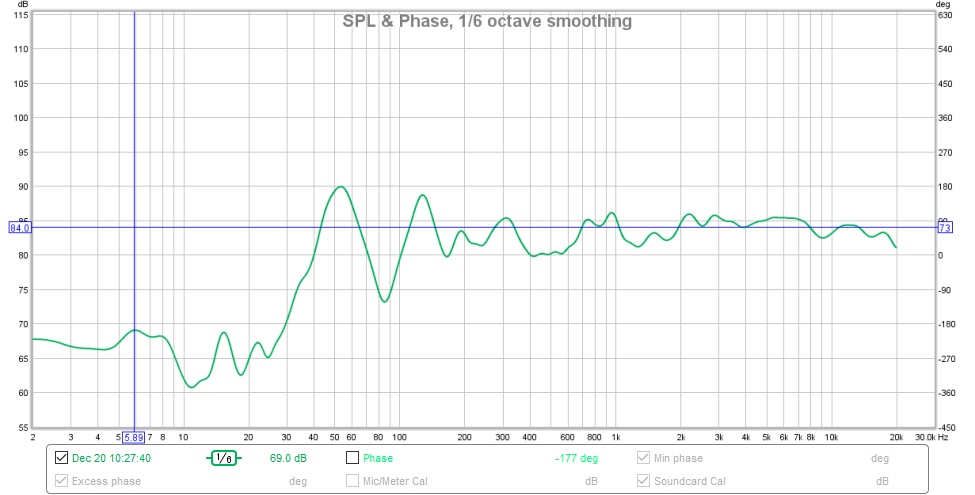

This is probably the 10th time running Audyssey, and it consistently rolls everything off above 8khz, even on the flat setting, to the point where 17khz is about -10dB.
I have no idea why it’s doing this. I’ve attached measurements, two are at the mlp, the steeply rolled off one is Audyssey flat, the one with the minor roll off (-5dB @17khz) is with it off, and the one that looks near ruler flat above 500hz out to 20khz is a close mic measurement. Obviously, the speakers aren’t bright, so there’s absolutely no need for the roll off.
The measurements were taken with the same Audyssey mic used for the calibration, at the exact position, so I’m not sure why Audyssey is “seeing” a bright top end that it thinks it needs to correct
Any clues?

Are you using an audyessey mic to take measurements with software? If so you will not get true readings fyi.
I’ve always used the Audyssey mic, according to several tests done by avsforum members it’s within 2dB of the omnimic. It’s worth mentioning the speakers sound as rolled off as the graph suggests.
You have no calibration file, so measurements are still not accurate. You should bite the bullet and get a mic since you like to take measurements.

Without a non-Audyssey baseline measurement, we can’t tell if the situation is Audyssey or your speakers.

Pssst.... this is what Audyssey IS DESIGNED TO DO!
I see Floyd Toole's 'Measurement and Calibration of Sound Reproducing Systems' was a bit too long for some.
Audyssey was based on the Cinema Industries 'X-Curve' which was a prescribed auditorium response that did not adequately compensate for high frequency propagation loss over the much larger distances between speaker-listener in a Cinema Auditorium vs a home theater. This results in a forced high frequency roll off.
If you read from Toole, you know that our Home theaters are one room, but two sound fields. This results from the large wavelengths of bass frequencies interacting with the boundaries of the room. There is a measurable frequency in any room where bass frequencies stop being omni directional, and gain an increasing forward bias, known as the transition frequency. Below it, the room is firmly in control of what bass you will hear, and when you will hear it. DSP can only correct a portion of this issue.
Above transition, the shrinking wavelengths must be properly aimed at the listeners. Audyssey has no idea what size room it is in, where it's speakers and listeners are located, or what speakers are used. Those shrinking wavelengths result in an increasing directivity meaning that the further off axis the listener is, the larger the change in SPL will be. DSP cannot correct this. Yet Audyssey is attempting to, and your measurements are proving it.
Yep, just use Audyssey for level balancing and distance and NOTHING else. Never ever use it for frequency correction. A good system in a good room does not need Audyssey which just ruins good systems. If you do have a troublesome room then correct by ear, that will be much more effective than Audyssey.
So you should update all your posts that include those incorrect measurements. You wouldn't want them to be misinterpreted.
There is a calibration file on avsforum I use.
I just need the bass problem fixed really. I may just have to bite the bullet and go with external amplification and something like a minidsp.

You could try the Flat setting instead of Reference for the Audyssey curve. Also, if you have a newer receiver you can download the Audyssey app. It allows you to shape the curve as well as to cut off at what frequency it runs its' correction. For instance, I have Audyssey running equalization up to 300Hz to help with the bass response, but then leaving the speakers alone after that.

That still leaves you with a mic having unknown manufacturing tolerances and a calibration file made by a hobbyist that presumably doesn't have access to a wide sampling of Audyssey mics to be able to make a useful "generic" calibration file. Maybe in combination with your ears, that's OK to get your system up and running to your liking. OTOH, if you want the measurements you post here to be taken without some massive grains of salt, like lovinthehd said, get a real mic.
If you go with the minidsp, your gonna need a real mic FWIW. If your just concerned with the low frequencies, as mentioned, don't eq anything else.
With your listening habits, your bass issues are not going to get insanely better with external amplification or eq, you need a better sub/s and start using a higher crossover.
Your current findings of your mains and sub are not objective.
I’ve had issues with the app doing more harm then good compared to the receiver.

If I remember right, some AVRs have a “Theater EQ” or “Cinema EQ” that rolls off the high end too, doubling the problem.

Audyssey has a "flat" mode that doesn't roll off the highs. It's easily selected between "Reference", "Flat" and "Off" in my Marantz AVR menu. If anything, Audyssey INCREASED the treble in my system to the point where "flat" sounds too harsh compared to "off" for a lot of music (sibilance increased). "Reference" still has more treble than "off" here, but it generally sounds good (dialog clearer, etc.).
It was too harsh my first try. I moved my main speakers a bit and tried again and it sounds great now without resorting to "bass only". Even so, it's not night and day from 'off' so the idea that it automatically "ruins" the sound seems a bit absurd to make such a generalization. Certainly, bass is a fair bit more even and 20Hz is now down just 5dB from reference with my relatively ancient sub from 1995 and it's flat at 22Hz.
My only real complaint about Audyssey is how long it takes to do another measurement. If I added a second sub, it would be nice if I could just have it take the measurement for the added subwoofer (and how it relates to the other subwoofer) instead of starting from scratch on everything when it's everything else that stands to get a potentially worse result (hard to put mic in the exact places that worked well and you never know how a dB or two could make the sound harsher or whatever).
