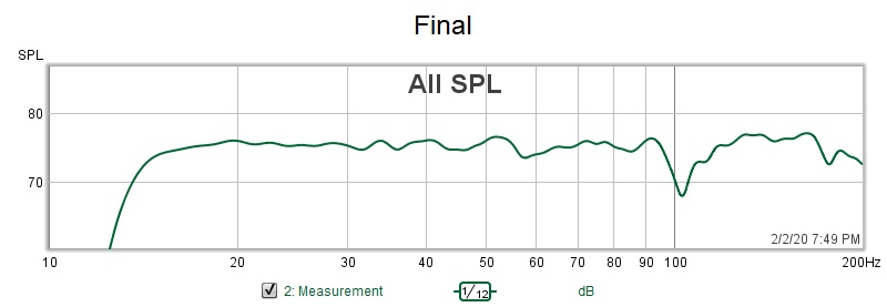

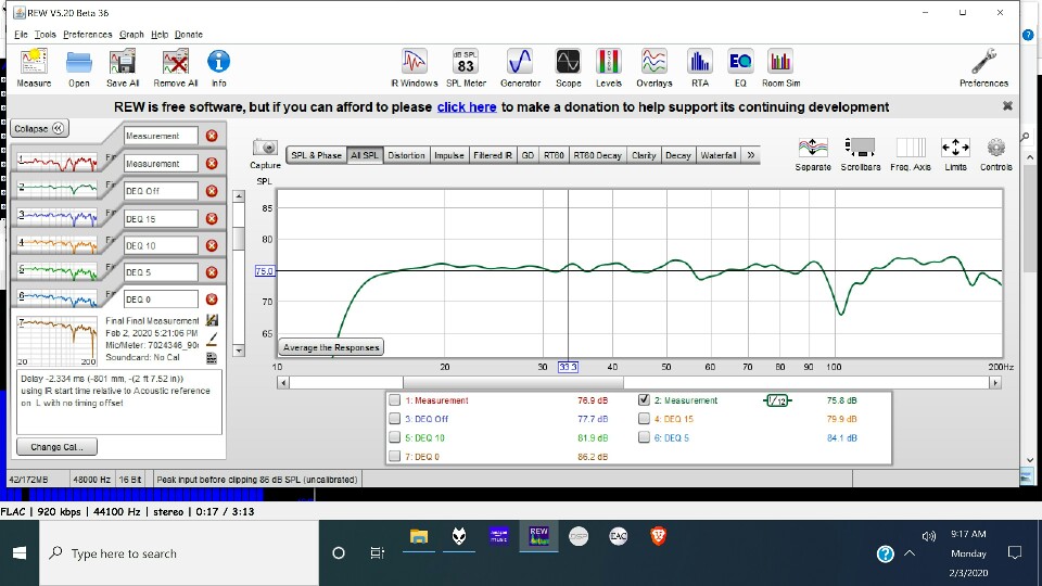

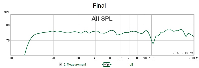

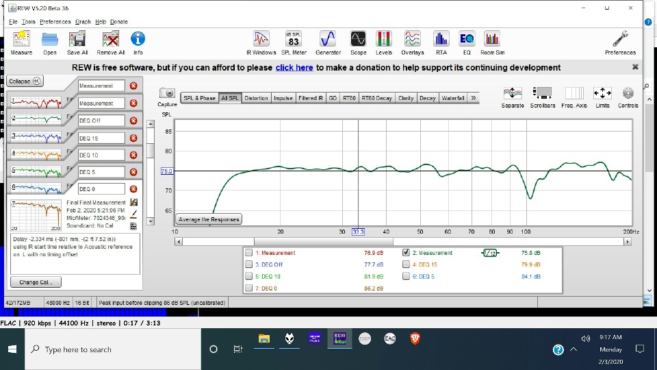

And yes, I really like being able to save multiple files and switch them in and out. It does save a ton of work. Here are the results of my tweaking.

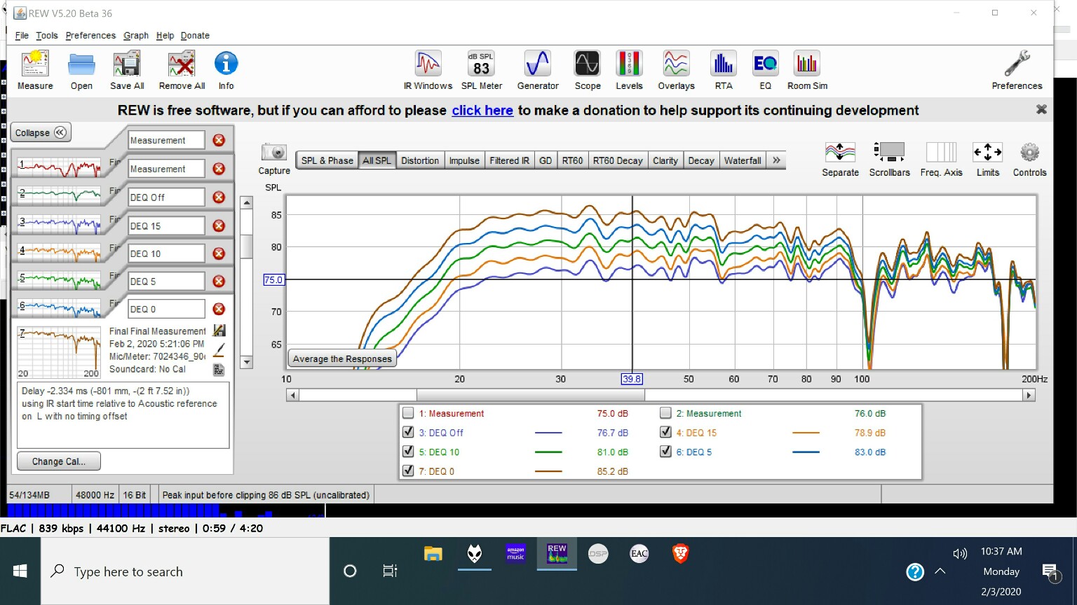

Why did it change the scale?! I had it set at 5 dB increments. Here's the screen of the exact same chart.

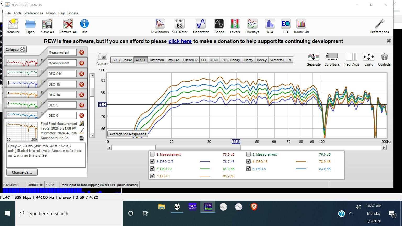

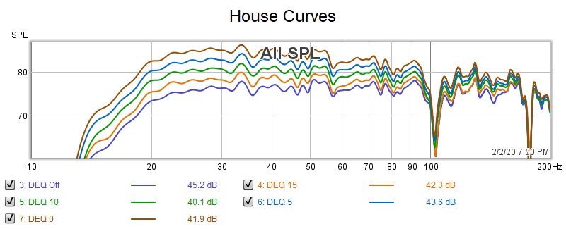

And some house curves!
Wow, virtually flat from 15 to 95 Hz. That's the suwoofer(s) right?
Pogre
Pogre
It looks like a huge improvement but it also created a huge dip at around 84 Hz. Did you apply that 9 dB boost with the mini, if so, I wonder how it would look like with Audyssey turned off? If that boost worked, then in theory it likely is a "null" but what could that be?
All of the sweeps I did at your request were with no Mini adjustments at all so no, I didn't apply any 9 dB boosts to anything. In fact when I did go in manually and made adjustments the highest I boosted anything was 3.5 dB.
I'm thinking you meant to say:
If that boost worked, then in theory it likely is not a "null"
... or am I missing something!
He might be thinking of the 9 dB boost I posted that I did with the editor app. That's not the profile I used tho. Those sweeps were untouched and 100% Audyssey.

My understanding of a null is that it is where the waves cancel each other, so applying a boost at that frequency would not do much of anything - it would simply make for bigger waves cancelling each other!
Since you eliminated to a good degree the dip (null?) you had, it would follow that either it was not a null or that you may have changed the phase/distance/timing so the waves do not cancel at the LP.
At least that is my understanding!
Right. The dip that was left after Audyssey I was able to EQ out. Then I finessed the rest to get that flat response. Once I had that then I started working on the house curve(s). But yeah, I'm in line with your thinking as far as the null situation is concerned. I'm not sure what's going on, but it does sound good to me again.
Oh, and I am going with an 80 hz crossover. I get more information at 100 hz but it sounds thicker and less detailed. I've determined that I'm not losing that much at 80 and I prefer the extra little bit of detail.
It is a weird one. I have those nulls too as you can see in my posted graphs. I knew there would be nothing I could do to help much, but I tried, and indeed nothing worked.

That's even more impressive!!
Well thanks man. After I bumped the house curve in there I can say it sounds really good to my ears too. I'm glad I got the stuff out and recalibrated. It's hard to say for sure, but I think it's at least as good as it was before this weekend. Nothing seems off. Subjectively, after a full day I've convinced myself it's even improved. At least I'm not hung up on the 120 hz crossover anymore.
You should measure the closet.

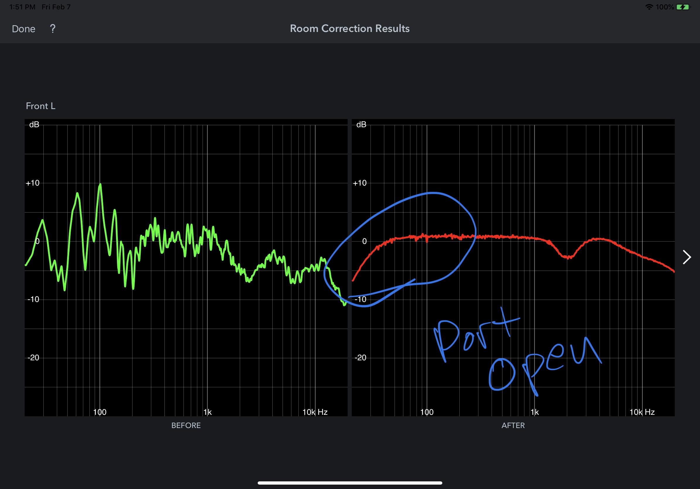

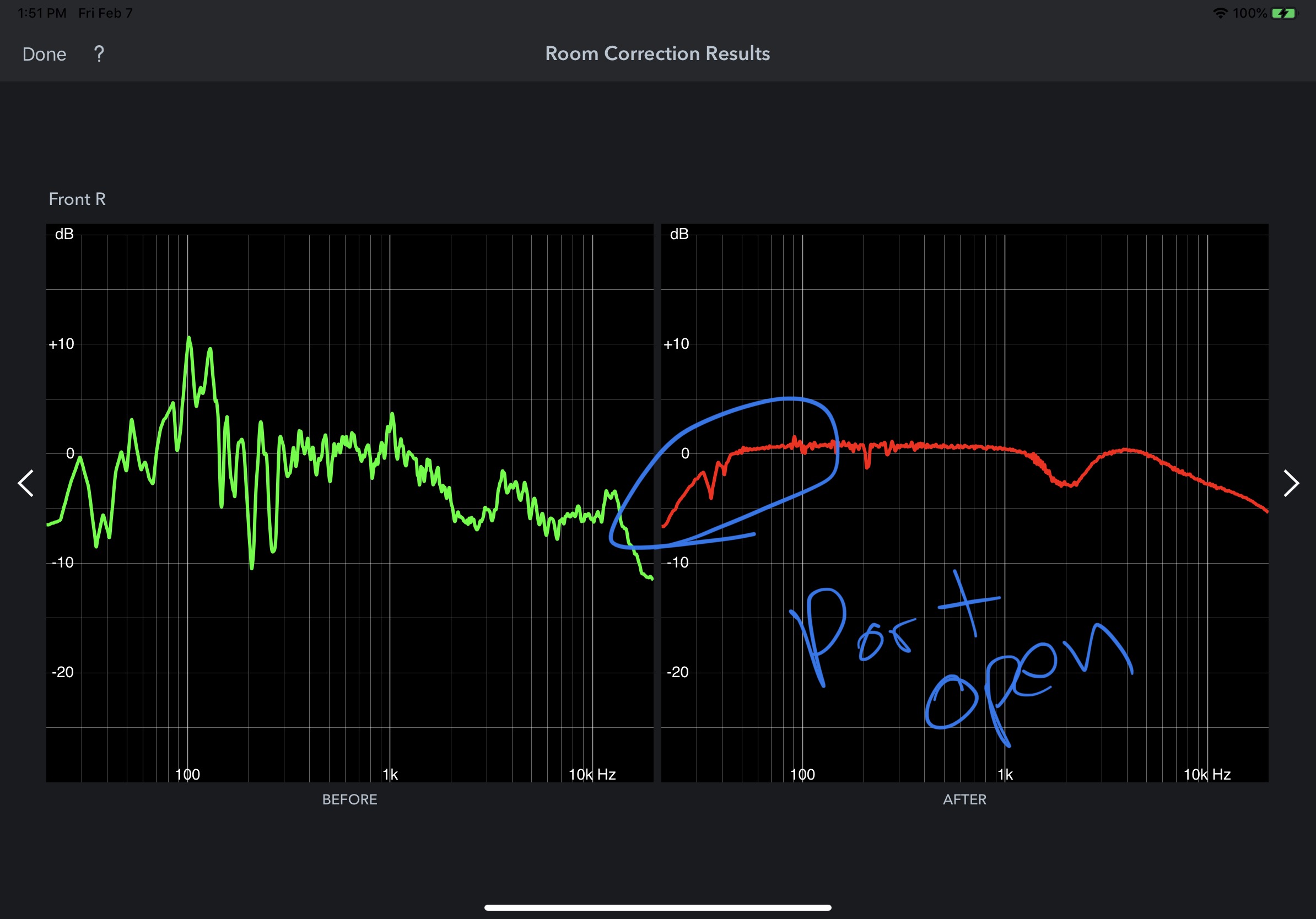

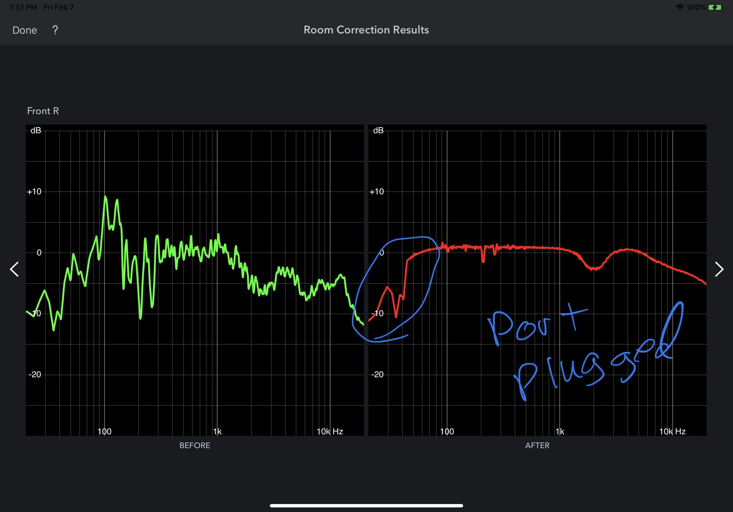

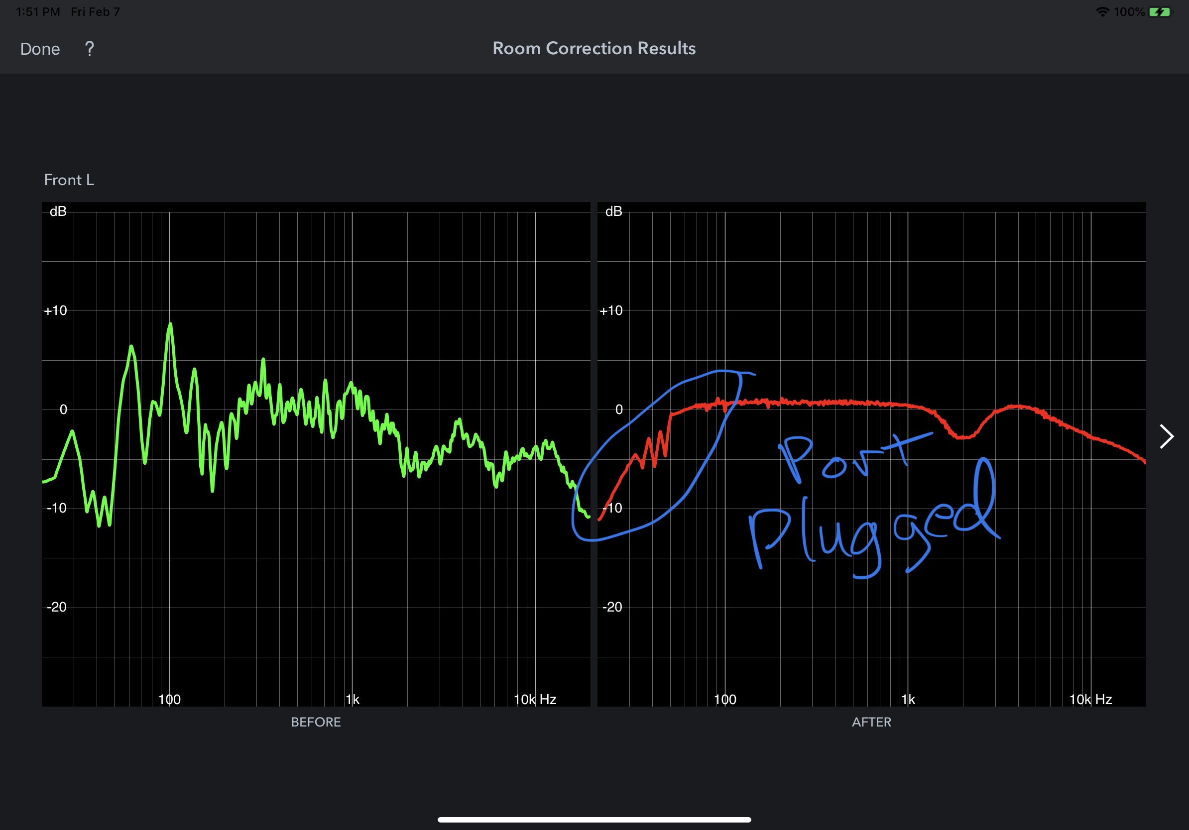

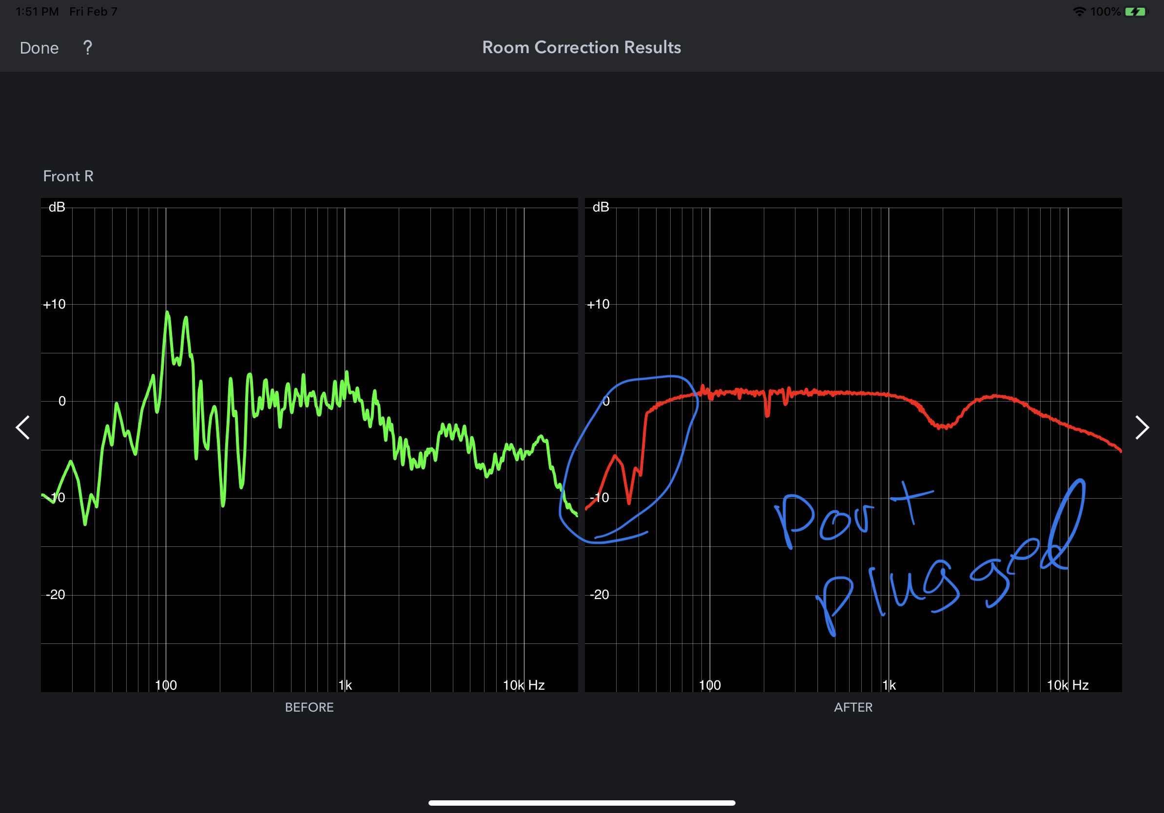

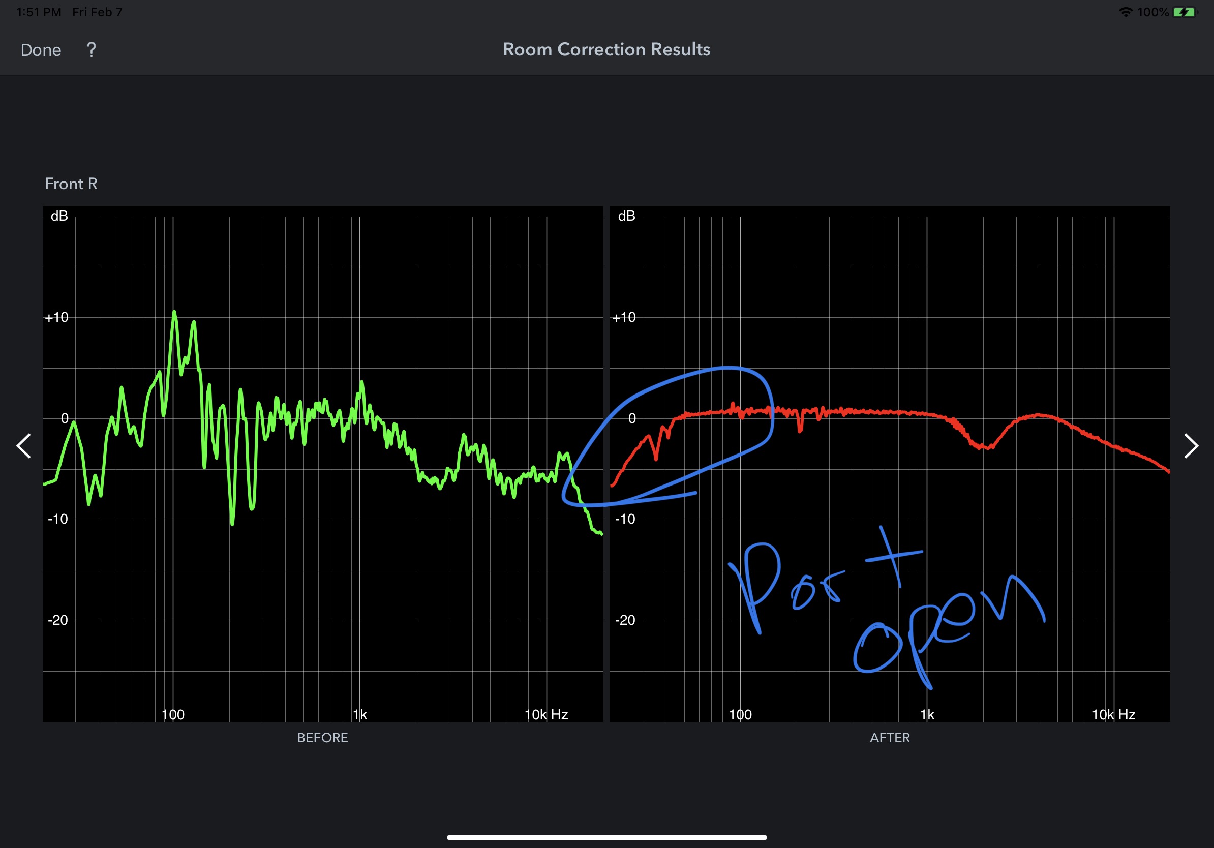

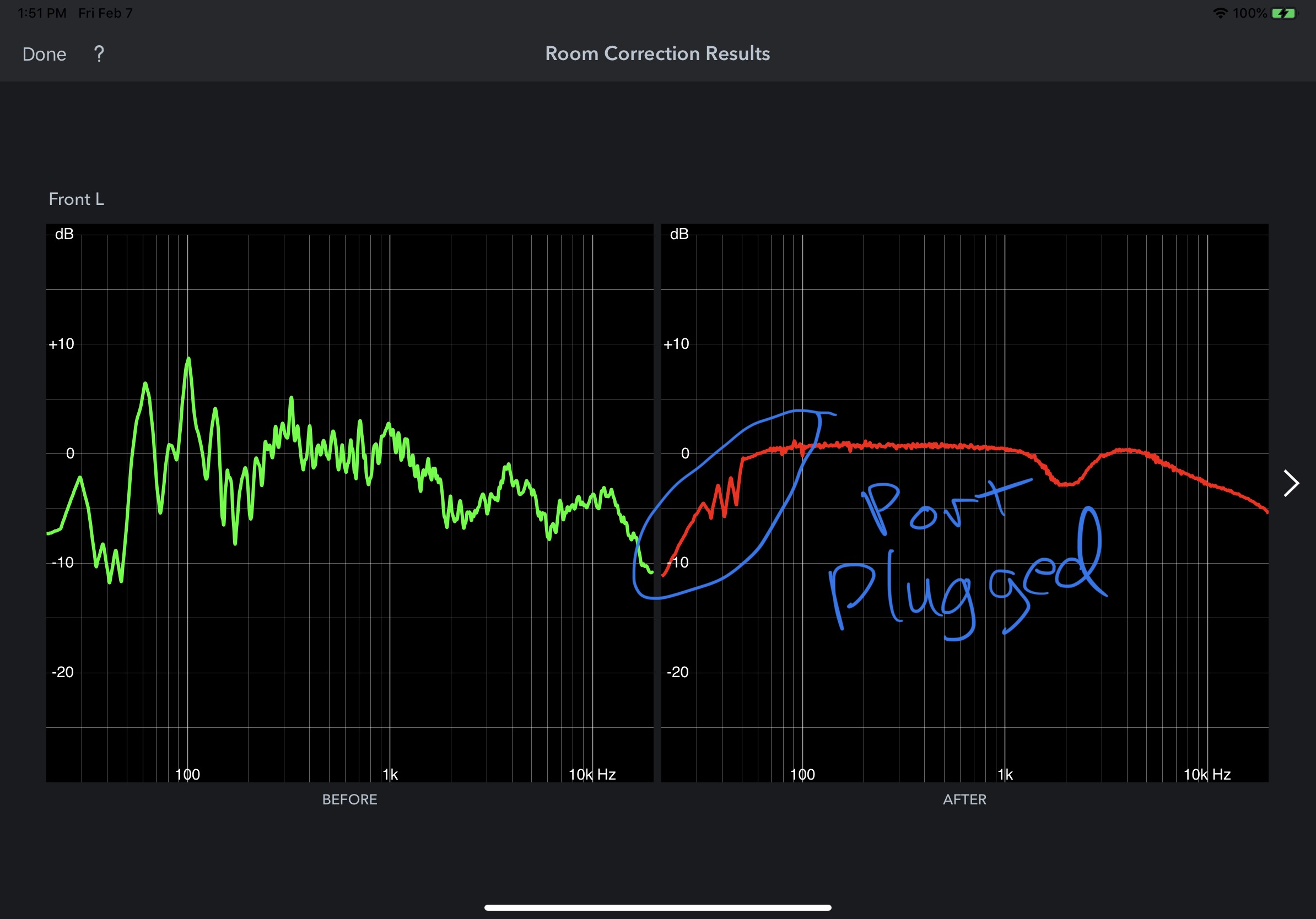

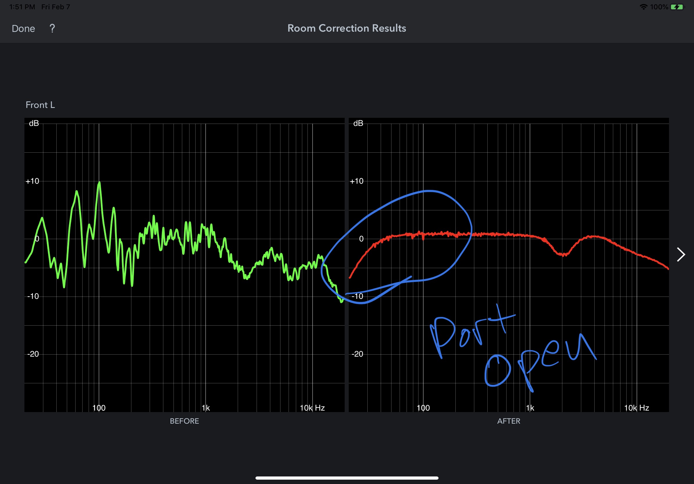

I found these room correction results interesting. I ran Audyssey calibration with my B&W 683 S2s with and without the ports plugged on my Denon X3500H.
I decided to run the speakers without the ports plugged since it looks like Audyssey had better success with this config. Without the new Denon/Audyssey app I would have never known this information.

You've got some strong room modes working in your room. I wouldn't even push those towers lower than 80, def not full range, but as they will still output low, crossed at 80, so solving for some of that cheese is important.
Fortunately you aren't looking at any 20-30dB suck outs.
Your front Right might benefit from some placement experimentation. It might only take inches in one direction or another, but you might be able to clean up whats happening there in the 30-40 Hz area...
More worth looking at is if you can effect a change in your 150-250Hz area. It could be floor bounce, but its pretty strong to be showing up in the red graph still.
Either way, I wouldn't plug the ports unless you really need to push those tight onto the front wall. After that, I'd run some experiments to see if moving them a few inches forwards or back, left or right, and possibly changing the toe angle makes any difference. I'd also recommend experimenting with just moving the Front Right by itself. A little asymmetry can work wonders... not a lot, but just like an inch or too. ;)

Pretty textbook behavior for ported vs sealed. I agree with Ryan, I wouldn't plug the ports either (even my own beloved speakers came with plugs and they just messed things up when I measured). I would think a speaker that's designed to work well ported wouldn't do so well sealed up. Likewise, popping a port into a sealed design doesn't sound like a great idea either.
What do your sub sweeps look like?

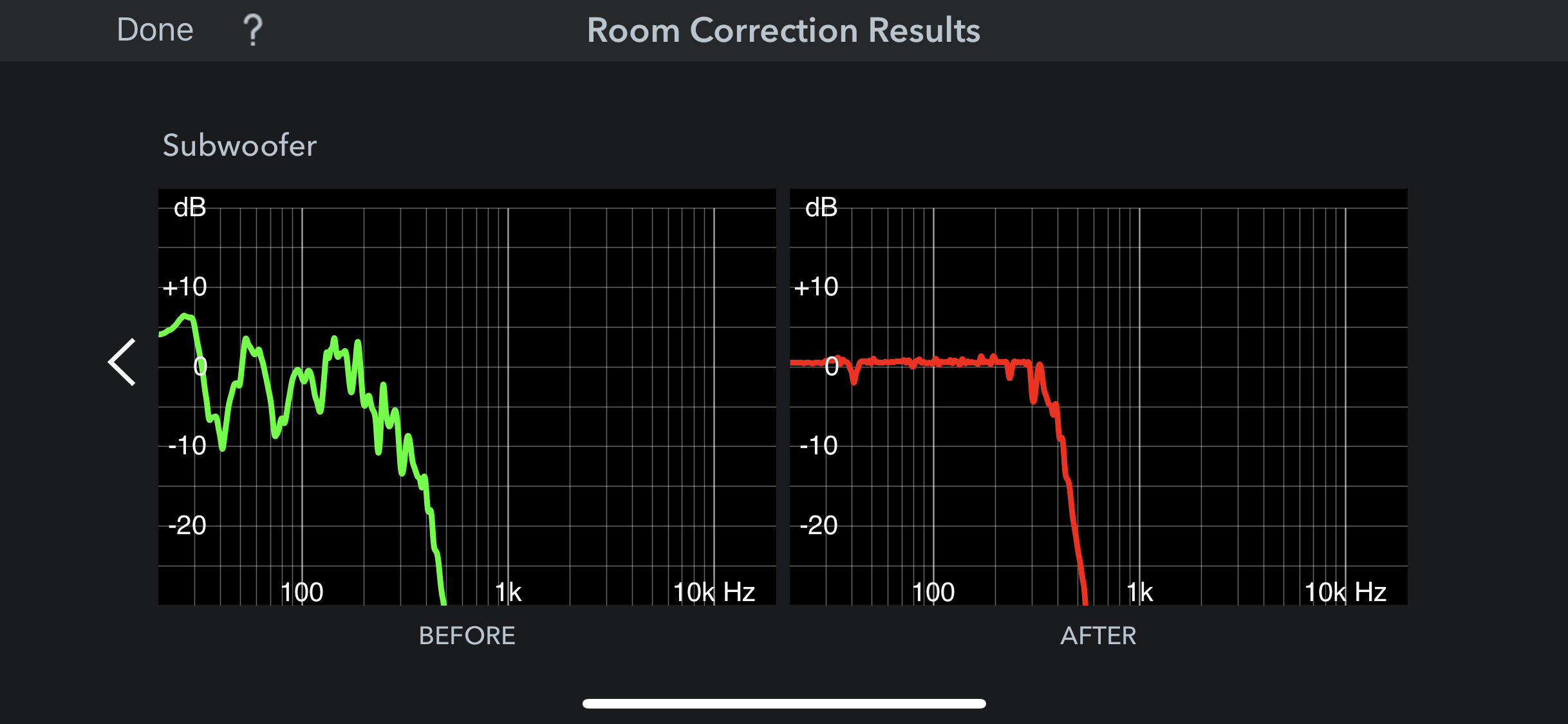

Sub results:
