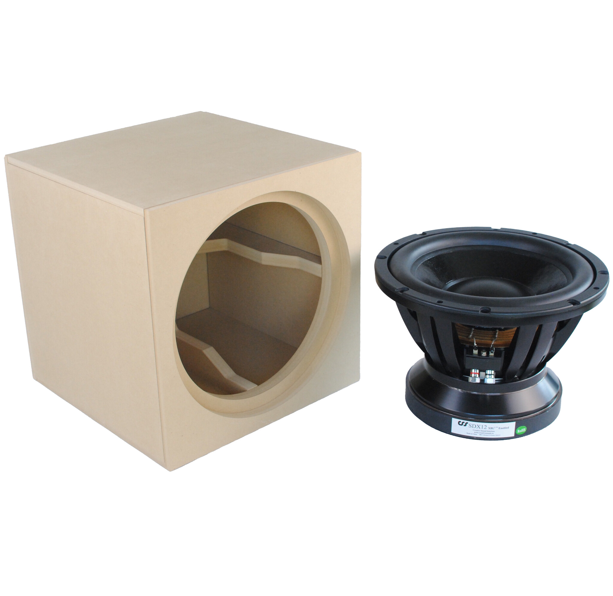

Have you ever wondered how typical DIY subwoofers stack up against the commercial competition? With DIY subwoofers being one of the first DIY projects enthusiasts take on, and certainly one of the first speaker designs I took on, I was very curious how a DIY subwoofer would compare to a commercial offering in value and performance.
I finally got my opportunity when CSS loaned us a prebuilt sample of their SDX12 driver in a small sealed enclosure. This mighty driver is a very high excursion driver, likely with more linear excursion than most moderately priced commercial offerings. Further, it is optimized for a very small enclosure. In many ways, this DIY subwoofer matched the size and style of many sealed commercial subwoofers and I just happened to have this subwoofer at the same time as I had access to a handful of similar commercial offerings.
We at audioholics put this subwoofer through it's paces in exactly the same way we would have for any commercial subwoofer. This included full CEA-2010 testing. To see what we found, review my review in the link below and come back here to let us know what you think.
