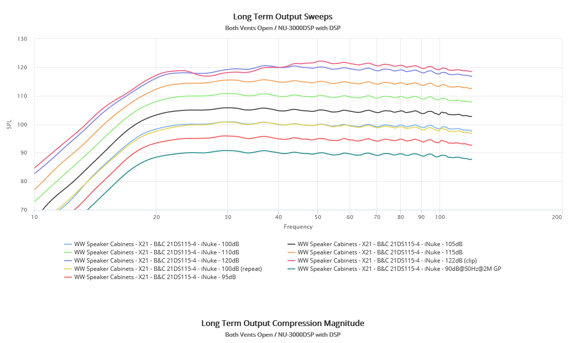

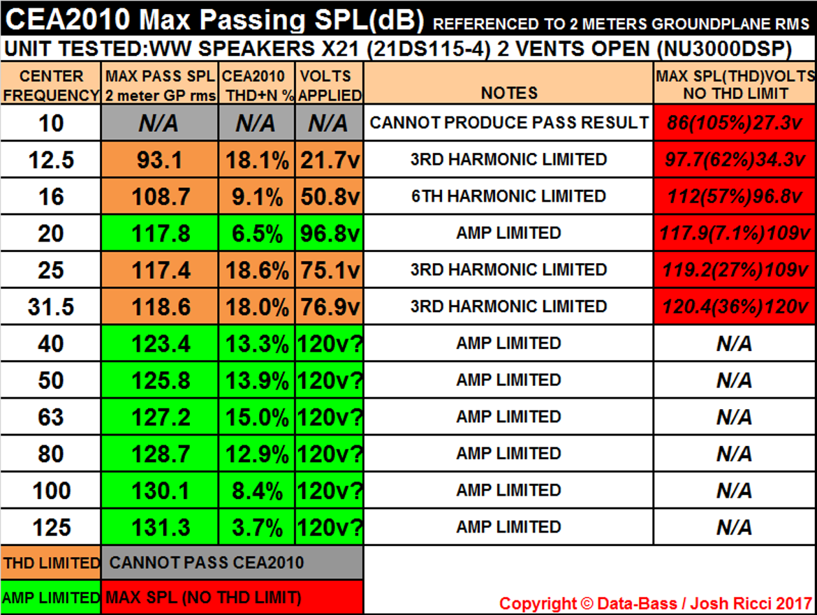

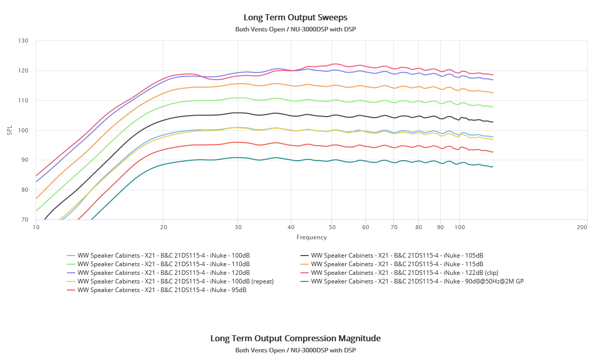

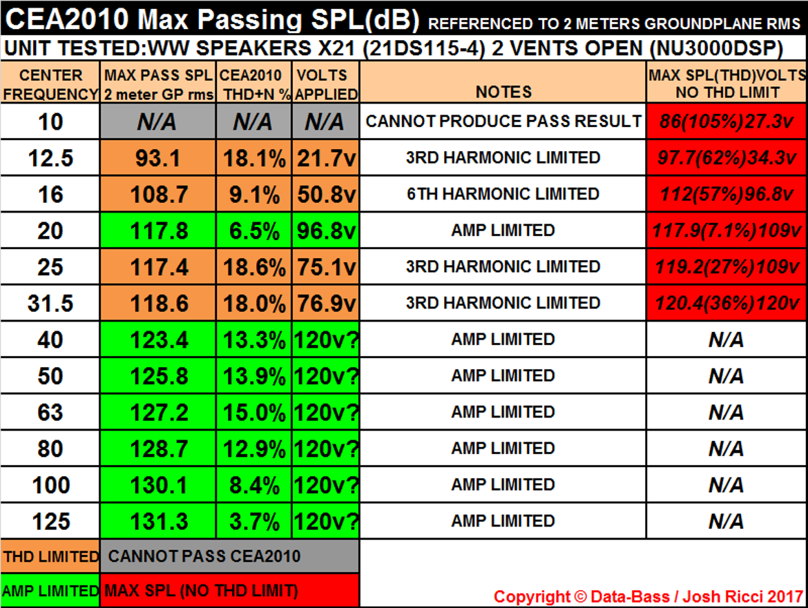

Thanks for the excellent review, Matthew. Nice to see some DIY love. Posting about those GSG Marty flatpacks and Eminence drivers hits close to home as that's the direction I'm most likely headed. If you test one of those, I'll help pay the medical bills if you throw out your back!
My problem is I'm not really sure that there are savings to be had (or that the savings are so small as not to be significant or be readily offset by factors such as warranty.
As with many things, the bigger and more numerous you go, the more savings there are to be had. Let's run through an example:
Four of the excellent GSG Marty flatpacks (if you don't have room for all four, split the order with somebody in your area--there are threads about doing this all the time). You're at $280 for each, including shipping.
Add a 21DS115-4 for each, another $600.
1/2 an Inuke6000 (using one amp to power two), that's $300 each.
Another $100+ for paint, wire, connectors, glue, etc.
That's $1300 total for each sub.
the HSU ULS-15 mk2 and the Outlaw X13 Ultra (which seems to go on sale for $1,000 or $1,100 on a regular basis)!. I am not sure a DIY sub can hang with either of these!
While I'm not aware of any published testing of that exact combo, for a rough idea of the capabilities of such a sub, Ricci did test a combo not too far off from that (similar sized box, slightly higher tuning) so it won't be exactly the same but will give you a ballpark idea ( https://data-bass.com/#/systems/5afdc4a68a2a8000041c7999?_k=eu9vw6 ) :
Another $150 each to use the Eminence NSW driver Matthew posted about above will outperform this driver by a good amount in the lower frequencies. But this gives you an idea. Those B&C drivers have actually been on sale recently for much less than $600 so a budget minded shopper may save even more if he looks for a deal.
Compare those numbers with the HSU ULS-15 mk2 you mention, measured by Shady https://www.audioholics.com/subwoofer-reviews/hsu-uls-15-mk2/measurements . The HSU is a very nice sub, and a good one for the money, but as you can see it's not even on the same planet performance-wise. If you can find a commercial sub that rivals the above numbers of the $1300 combo for less than double the price, please do tell us all what it is! A JTR Captivator 4000 will best it in some areas, but for three times the price.
Multiply that by four (we all need at least four, right?) and you can see many, many thousands of dollars saved going the DIY route for similar performance.
