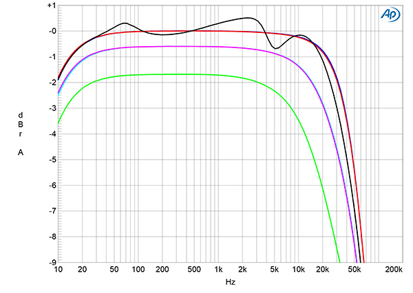

^Speaking of coloration, I'm pretty sure if I got to pick the music I could easily identify this amp from other solid state ones with all using a speaker's load connected (see the black "gray" trace, below) similar to what Stereophile uses, not a resistor:
"Fig.1 Audio Research I/50, 8 ohm output, frequency response at 2.83V into: simulated loudspeaker load (gray), 8 ohms (left channel blue, right red), 4 ohms (left cyan, right magenta), and 2 ohms (green) (2dB/vertical div.). "
The ear is very sensitive to 3kHz so having a sudden -1 dB droop at 5k compared to that peak can stand out with (some) content there.
DrMorbius
DrMorbius
Is that blue right behind the red at 8 ohms? I think I see a slight bit of blue starting at around 10k hz.
