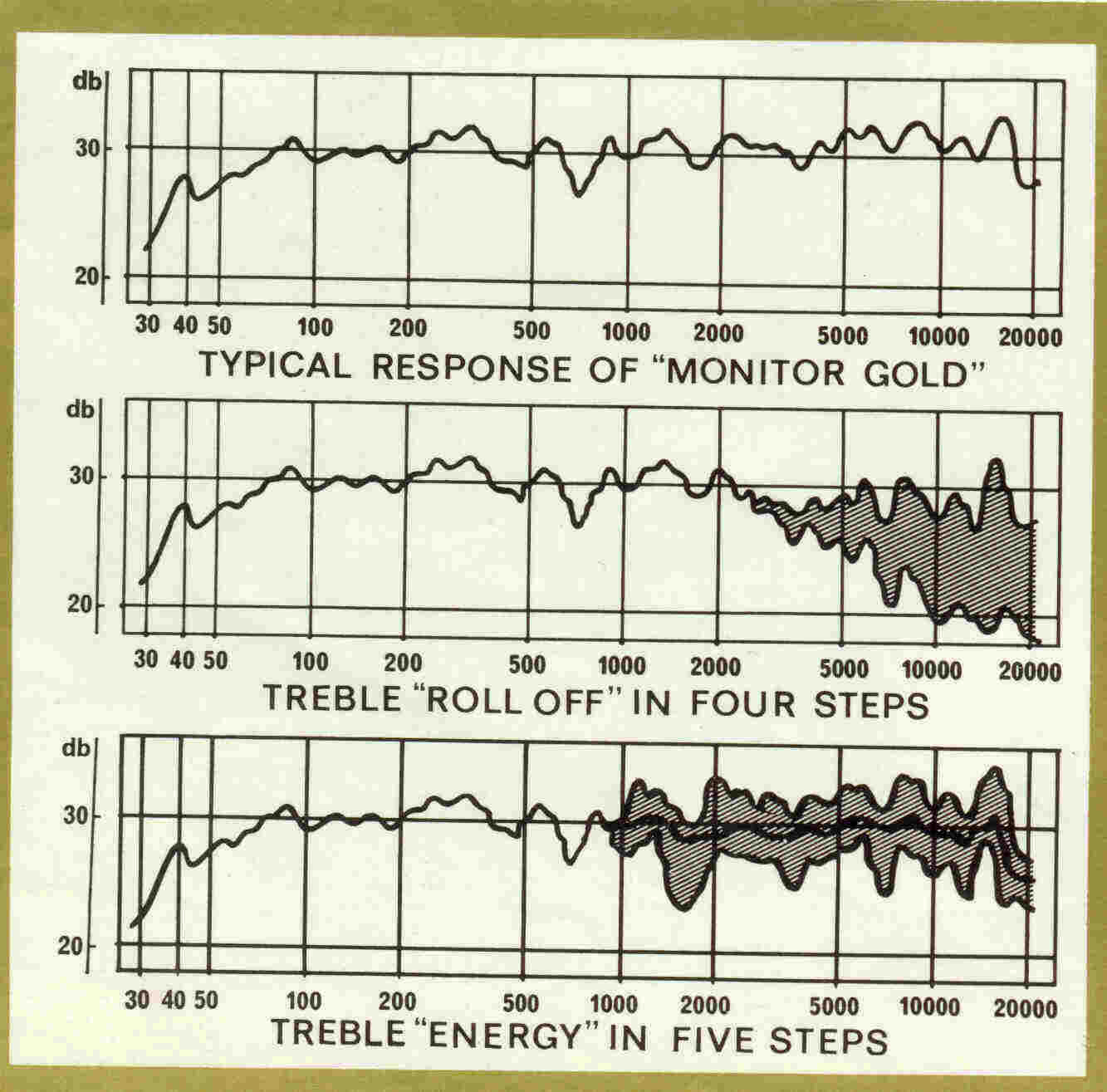

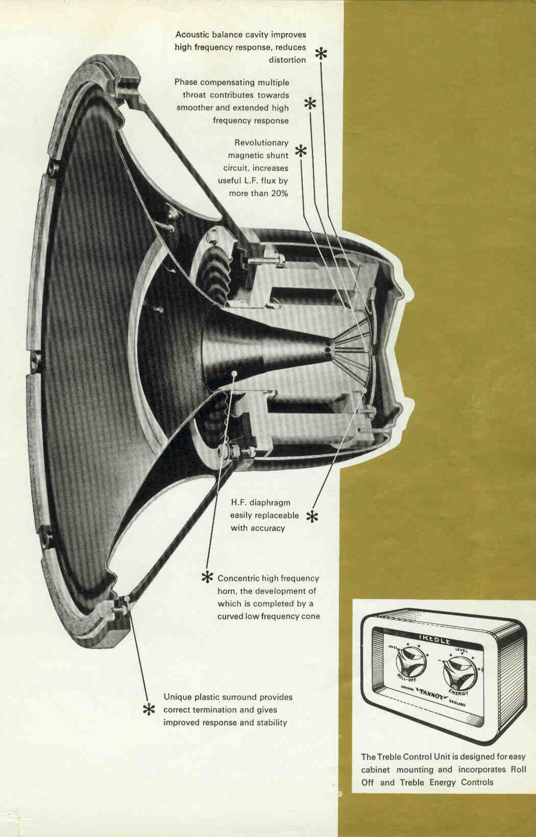

OK TANNOY's designs...
SURE LOOKS LIKE MODERN TRANSDUCER DESIGN TO ME!
:rolleyes:
no comment
And some Englishmen still think they have an empire
:rolleyes:

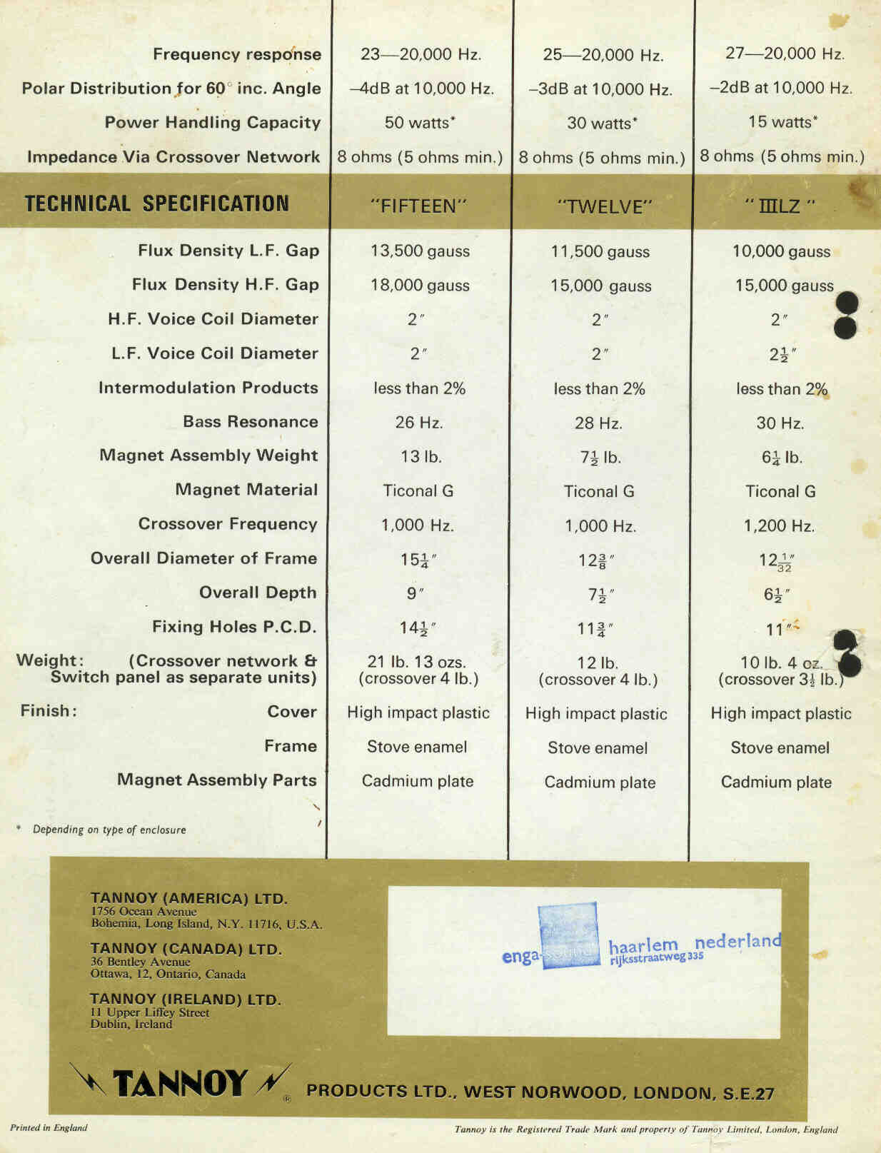

:rolleyes:
no comment
You really should've just stuck to that "no comment."
Of course it doesn't look modern. That's because it isn't, and you're not knowledgeable enough to know that it isn't.
Tannoy retired that design long ago. Their current designs feature an improved phase plug (the "Tulip" radial design, as opposed to the pictured "Pepperpot"), and many other functional enhancements compared to the old Gold.
Again, someone who knew something would know that Tannoy (like KEF, Quad, etc.) are now Chinese...
