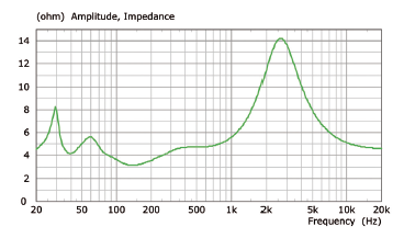

The R7's nominal impedance according to KEF is 8 ohm nominal, but many of us would say treat it like 4 ohm nominal for the purpose of sizing your amp.
Amp power recommended (by KEF) is 15-250 W, so the SR7011 should be adequate but if you want to cover all conditions of use, any amps rated for 250 W/350 W 8/4 ohms should have you covered. If you currently listen to music/movies with volume of the SR7011 no higher than say -15 90% of the time, then I doubt you will hear "better sound quality" using external amps but you will, unless you compare them without being subjected to the unavoidable bias/Placebo. People will say the difference they heard was so obvious that there is no need to do it "blind", but in all available serious studies, even people who were so confident, failed.

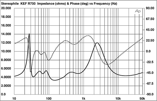

I wonder how different the Kef R7 is compared to the Kef R700 which Adkinson did measure. From what I got from my Kef dealer the R7 is just an updated R700 with a newer cabinet and driver.
He noted;
"My estimate of the KEF R700's B-weighted voltage sensitivity was 87dB(B)/2.83V/m, which is 2dB lower than the specified 89dB/2.83V/m. KEF specifies the R700's impedance as 8 ohms with a minimum magnitude of 3.2 ohms. My own measurement (fig.1) shows that the minimum impedance, which includes the impedance of 10' of speaker cable, was 3.3 ohms at 145Hz. The impedance magnitude (solid trace) remains between 4 and 6 ohms for almost all of the audioband, but the electrical phase angle (dashed trace) is generally benign.
PENG
He noted;
I think the crossovers are quite different too. The R meta series are now rated 4 ohms. The old R100 through R900 were rated 8 ohm nominal, with dips to 3.2 to 3.7 ohms.
