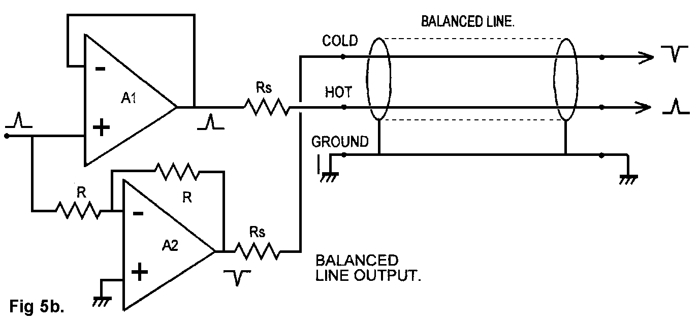

Even more research and asking people on GearSlutz gave me an idea for question I'm looking for:
Behringer is possibly cheating with providing real balanced TSR out.
https://www.gearslutz.com/board/showpost.php?p=13317694&postcount=7
The right of doing balanced output is described (using inverting amps) here:
http://www.douglas-self.com/ampins/balanced/balanced.htm -
