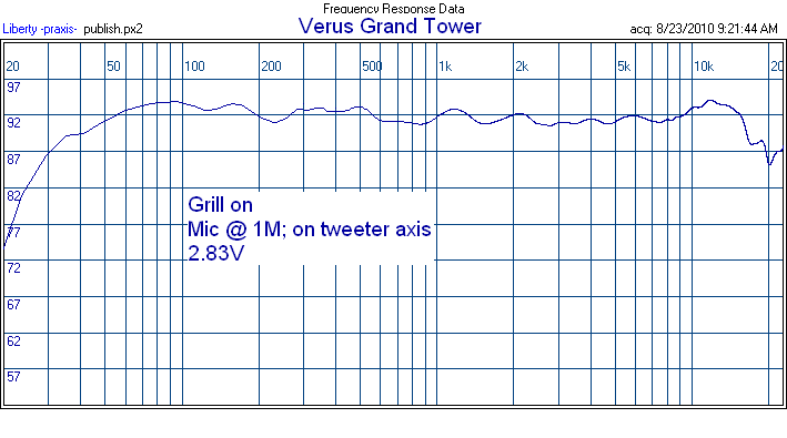

Aperion Verus Grand Towers - FR Plot On-Axis

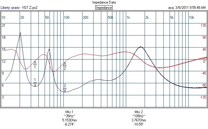

and here is a little Impedance with Phase that most have not seen out there, just came in... looks great to me.
You can see the phase at 0 deg. where the VGT's cross over to the ASR Tweeter at 1.8kHz. and notice the saddle down at 35Hz.
Where those two Markers are you'll notice the phase is Close to Zero ... good thing for sure.
C
cschang
Looks good. Roll off after 10khz, so it won't have the "airiness" of speakers that extend beyond that. The HT Mag measurements show a rise after 10khz with a drop off after that (very different than what was supplied to you by Aperion). It would be interesting to see off-axis plots from both sources.
Phase and impedance looks good, but for the price, I am sure you have seen better. :)

Alphaiii --
I did not notice that SoundStage had run the plots on the Verus Grand Towers, only the bookshelves.
What is the URL for Soundstages Measurements on the VGT's?
BTW -- the previous FR and Imp/Ph. plots are from Aperion and as you can see are at 92dB the speakers sensitivity rating.
Why aren't the Soundstage measured at 92dB for their Reference?
I do know the HT Mag plot is NOT the red curve, but the PURPLE curve for the Verus Grand Towers.
The Red curve is for their bookshelf.
I wonder if both were measured with the Grill ON, or off and at 1 meter on tweeter axis at 1 Watt (2.83V)?

The Soundstage measurements are for the bookshelf, the sensitivity rating is much lower. I believe Soundstage measures with the grille off.
For HT, the related text says they measure with the grilles off, and at a distance of 1 meter with a 2.83-volt input.
