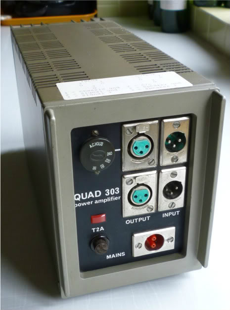

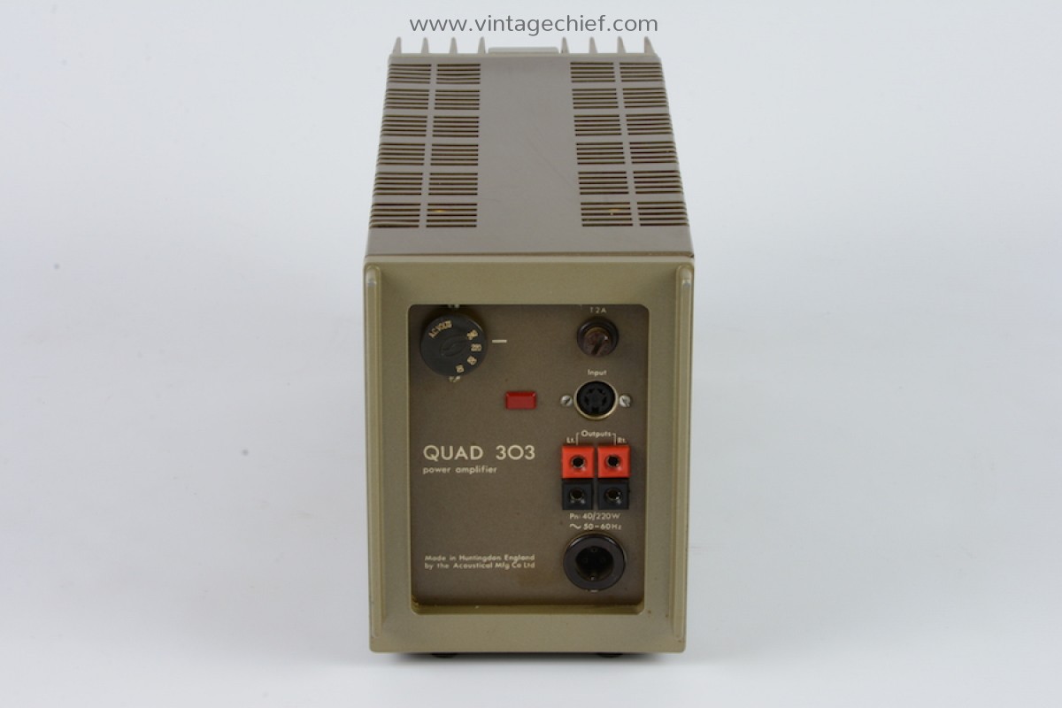

Peter's achievement was to design and build the first really reliable solid state amp, the Quad 303 in 1969. These amps are incredibly reliable and seldom fail. The BBC replaced all their line amps with 303s. I bought my first 303 in 1970. I used it for years. I have not used it in a while, but as far as I know it still works. I have two of them.
Quad 303 domestic version.
Quad 303 pro version.
Those amps are so stable that you can parallel the inputs and outputs to bridge them. I know of no other power amp you can do that to. The rest blow up instantly.

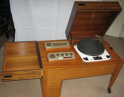

I have finally found a picture illustrative of the sort of cabinetry with high WAF seen in the 1960s

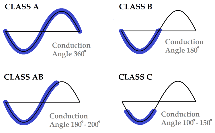

ClassAB always operate in ClassA at lower power levels and use B at higher levels with some brands operating in ClassA until ~5W? Are you saying that you only use ClassA or ClassD amplifiers? Perhaps ClassG/H, with additional sets of output transistors that are only used at the higher power levels?
Because you stated the same before. That is not quite correct, or at least misleading.
Yes, class AB and class B amps have the same kind of push pull configuration, but with class AB, there is always some bias current to ensure both output transistor in the simplest form of push pull would conduct for more than 180 degrees, thereby minimizing crossover distortion.
There are plenty of articles to read, below is just one example:
