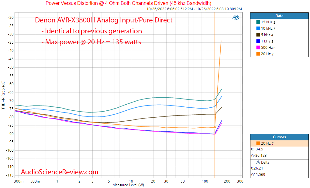

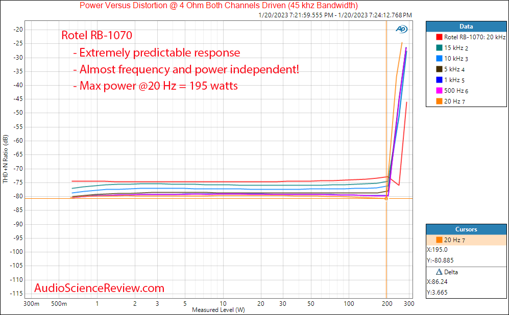

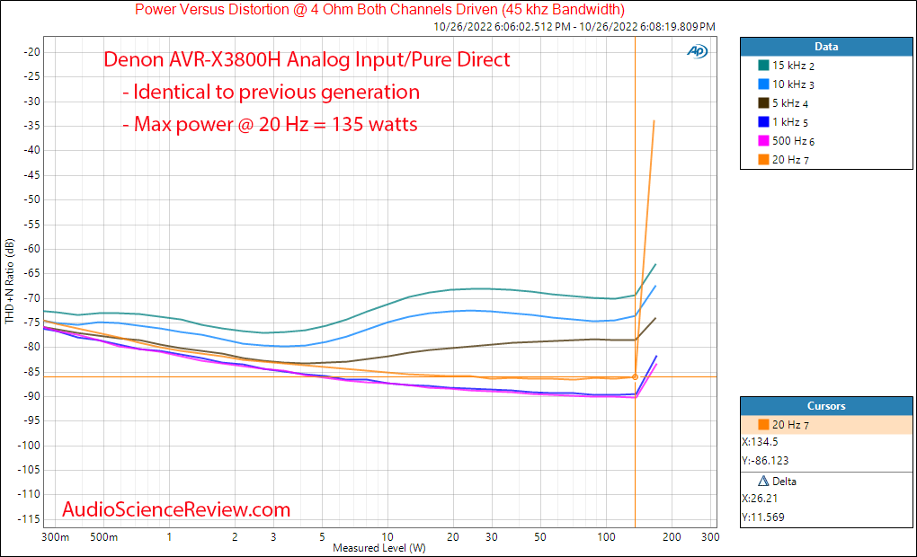

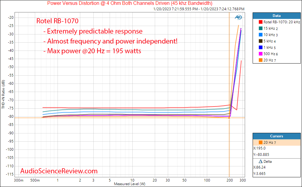

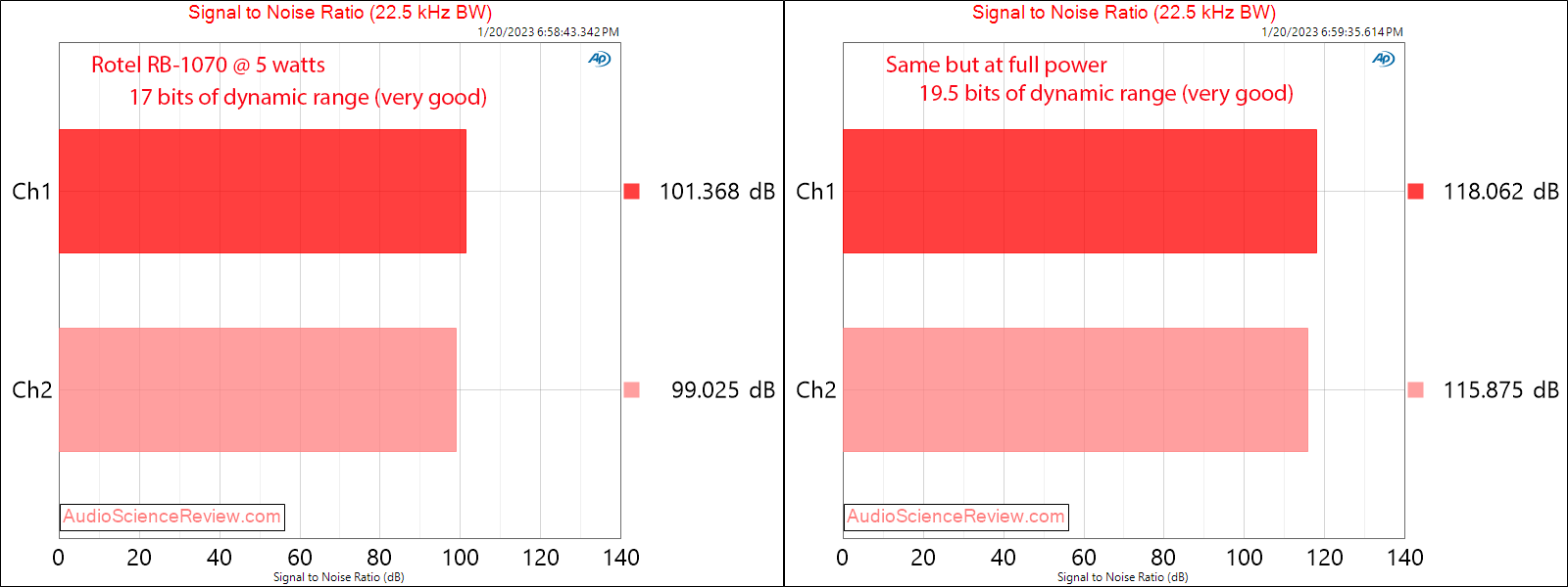

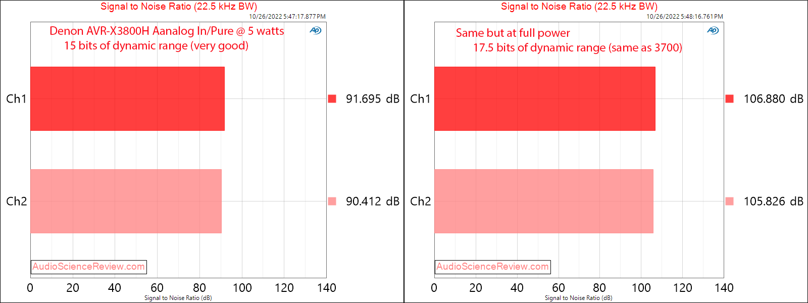

With that in mind, please compare the following, that I have also posted using ASR's measurements as example. You can used Gene's too, but it is easier to find Amir's simply because he has done so many.

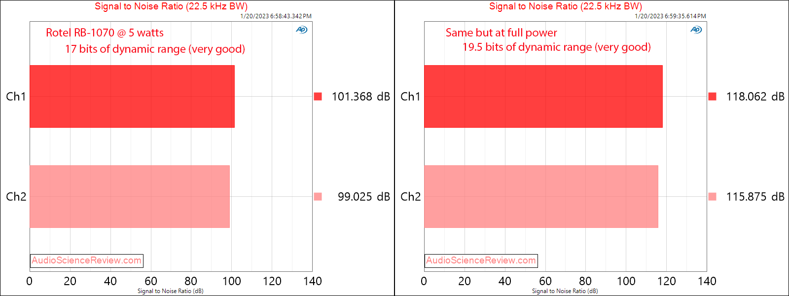

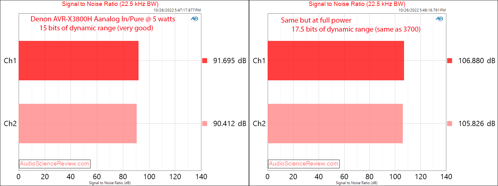

I remember you suggested that we should look at SNR in conjunction with THD+N so now let's compare their SNR:
See that the Rotel is at least 10 dB better, and by the way, the example RX-V377 you cited showed very good SNR but S&V did not specify the output level, so it could be (most likely) measured at rated output, and their figures were almost always "A weighting", ASR's are for 22.5 kHz bandwidth, unweighted.
Cautionary note: Here we are comparing SNR measured on an AVR versus that measured on a power amp, I don't what the SNR would be if the AVR's power amp itself was measured.

1. SNR. So the Rotel amp does have better SNR than the X3800 (worst case is 99dB vs 90dB).
2. THD+N. And although the x3800 THD+N is better than the Rotel at 1kHz, the Rotel’s THD+N is better from 5-20kHz, especially above 10W? Should we care about the measurements above 5W?
I am not sure if the difference is that much because while both were measured at the speaker outputs, one is an AVR and the other is a power amp. I would think the accumulated noise in the AVR case might be a few dB (2, 3 dB or less?) higher due to the preamp's noise contribution. I tried calculated it before but too lazy to do it now, but I remember it would not be much. May be @gene can show us, or he might be able to give us a approx/rule of thumb number when comparing SNR of an AVR vs power amp at the 1 W/2.83 V output level.
