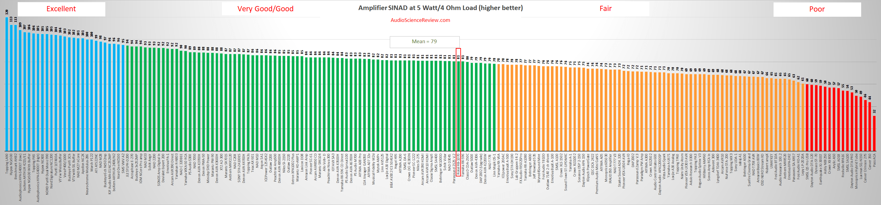

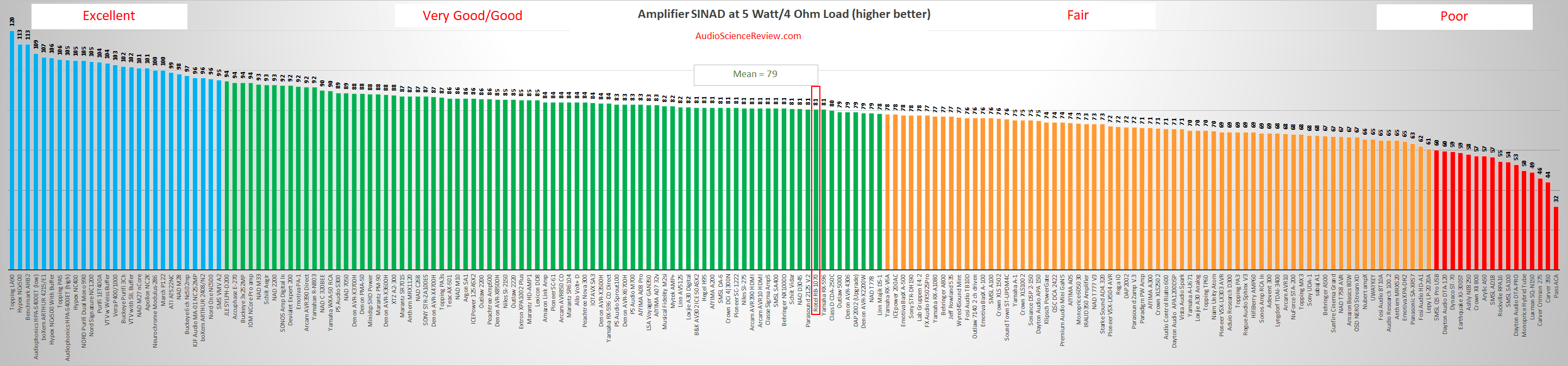

ASR finally measured one of the popular power amp, a Rotel:
Rotel RB-1070 Amplifier Review | Audio Science Review (ASR) Forum
First, the usual ranking chart by SINAD that seems to be a target by other reviewers (such as some Youtubers) who often cited ASR's obsession of SINAD blablabla. In this review, SINAD was well below many AVRs:
Yet the Rotel did get on his recommended list. If you read the whole thing, you may understand why he would recommend this amp, yet not the very popular AVR-X3800H or the Onkyo RZ50, also reviewed not long ago.
Or forget reading the whole thing, just jump to his conclusions:
Conclusions
As one of my favorite (looking) brands, I was very anxious to measure a Rotel amp, hoping it would not let me down. Fortunately it did not. No, the SINAD doesn't break new ground but the rest of the measurements are very good with plenty of power available. It is a great choice for people wanting good amount of power in an attractive package with competent performance.
I am going to recommend (used) Rotel RB-1070.
So the man can be (or has been, if people read the fine print every time) reasonable!:D
