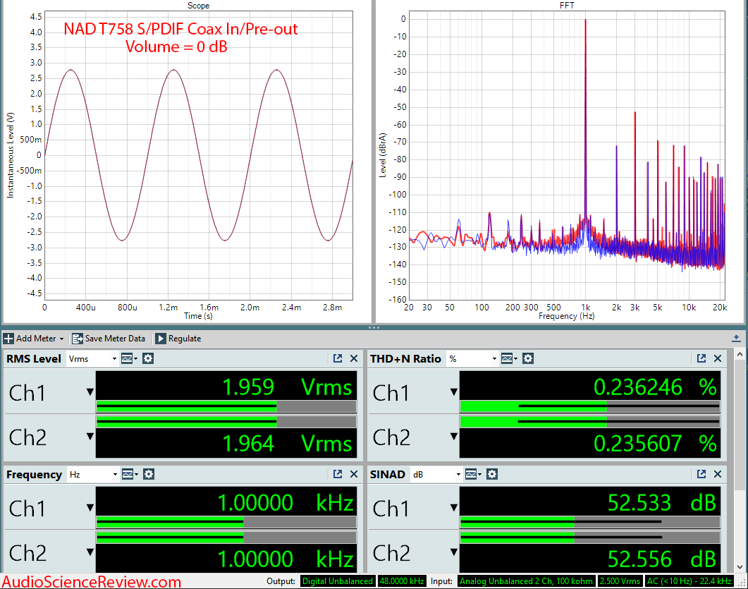

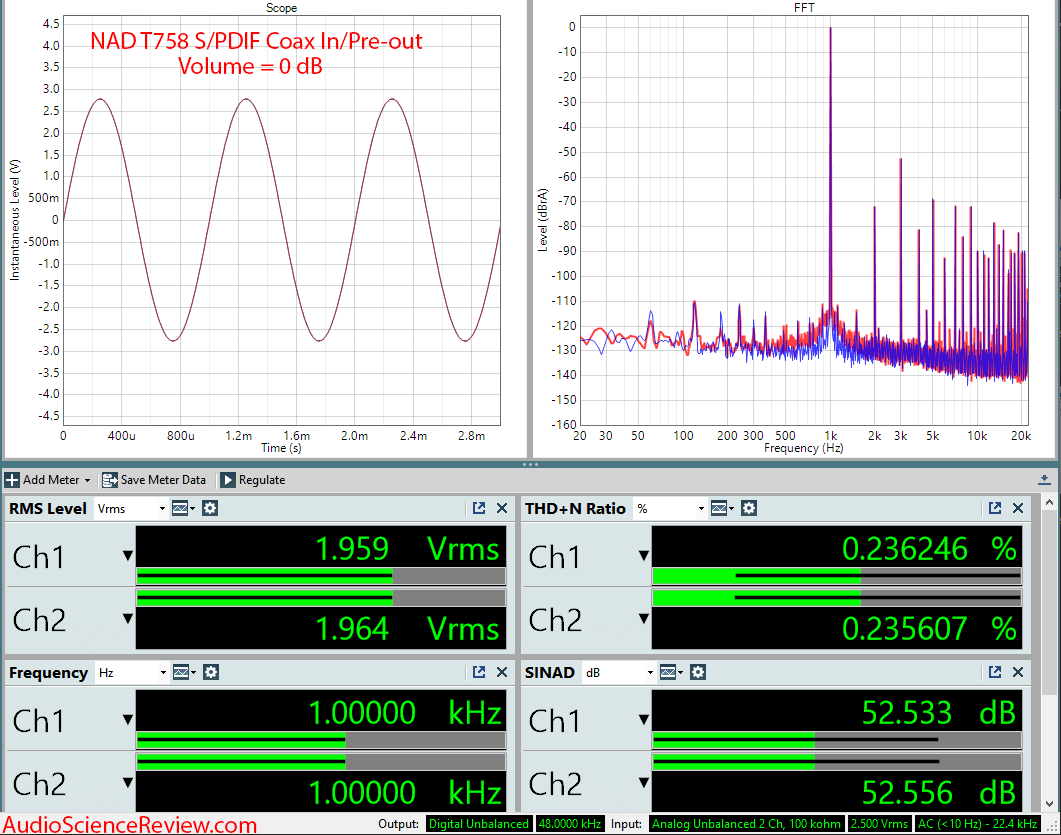

That sounds about right and predictable, but the real issue is about the pre out voltage needed for the power amp it feeds to reach the specified rated output. In this case, 250 W into 8 Ohms according to the Rotel's power output specs. Calculations shows it will be almost 2 V, that is a fact, and reality.. And we already know how poorly the NAD T758 V3's pre out perform at 2 V, unlike your X4700H.

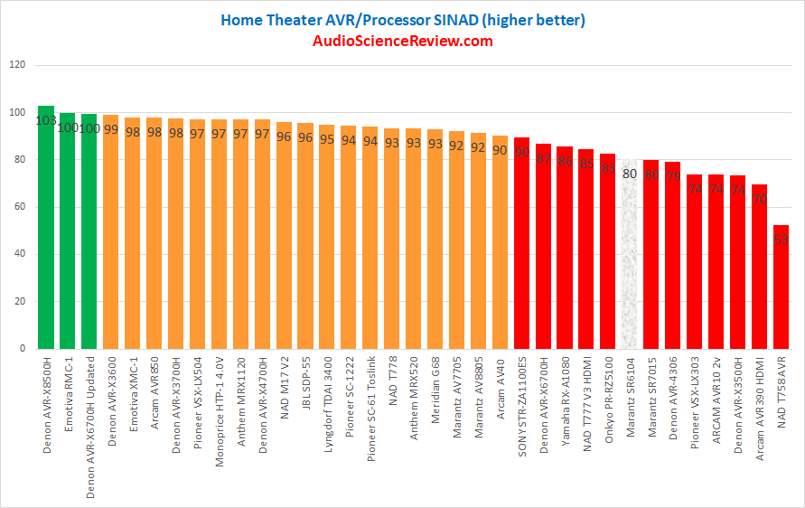

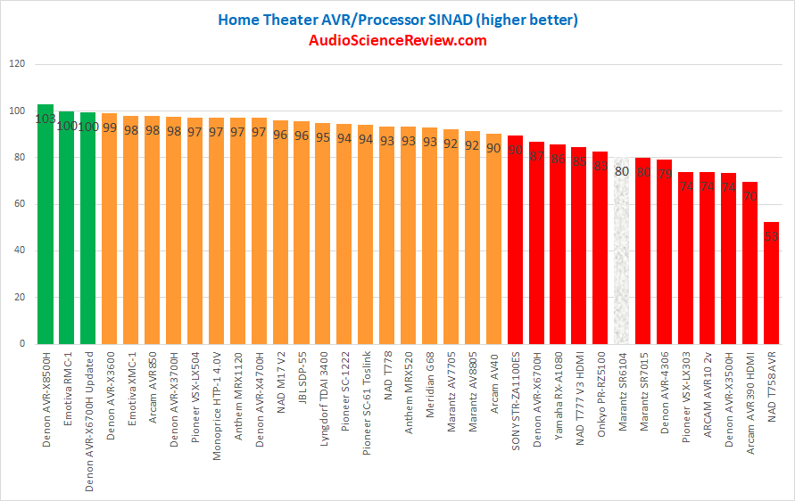

The NAD sits right at the bottom of the ranking chart lol!!

But it's a shame that an AVR with an msrp of $1400 or so can be such a dud with real world, reactive loads, or exhibit such mediocre performance on the pre/processing side too.
