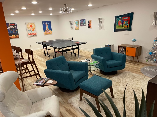

Listening from either of those two blue chairs should be fine as they are shown in the photo.
The NAD isn't Audyssey equipped, so that's a non-starter regardless. I did run Dirac but can switch the correction off for now and see how it sounds.

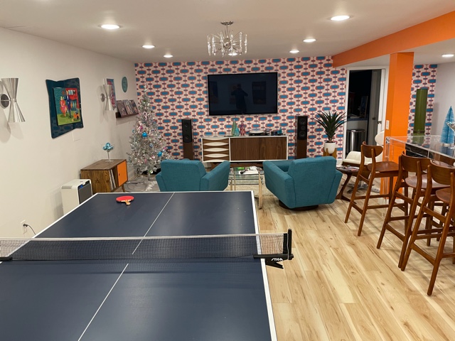

he's not Doc, look at the pics he gave us, half the room actually. Regardless, I'm starting to think Swerd was right and as a 'retiring railroader' we've 'derailed' the thread ........

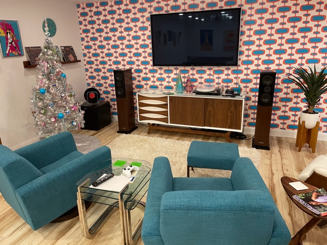

Here’s some pics of the room from multiple angles. The three posters at the back of the room ( the Los Angeles, Miami and Hawaii ones) are actually acoustic panels from ATS Acoustics. I know it isn't much in terms of softening, but trying what I can....
View attachment 42661View attachment 42662View attachment 42663View attachment 42663

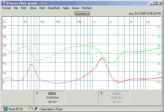

SongTowers are clearly 4 ohm speakers. Look at the red trace in the 200-300 Hz range. Their mild phase angle changes, less than 90° in that range, are what makes them relatively easy to drive – for a 4 ohm speaker.
People are suggesting EQ to the 20-200 or may be up to 200 Hz range only because he seems to want to thicken the sound. Also, that thing has Dirac Live, that should make it not too difficult to customize the curve for that range of frequencies. My BMR are also designed by Dennis, and I found Dirac Live (was using the trial version at the time) did improve the low to lower mid range. With Dirac, like Audyssey+App, you can limit the range for EQ, so no harm needs to be done.:) Based on what I can see, yes the room is big but he's seating close enough to the Song Tower for me to say his issues with "thin" sound is not due to not having enough power for the Song Towers, but the room acoustic conditions that could benefit from Dirac Live and setting crossover higher, in case there are cancellation going on between the sub and the bass capable Song towers that may be a little too tricky for even Dirac, at certain frequencies.
