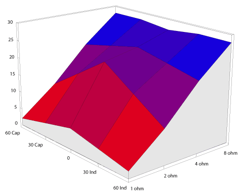

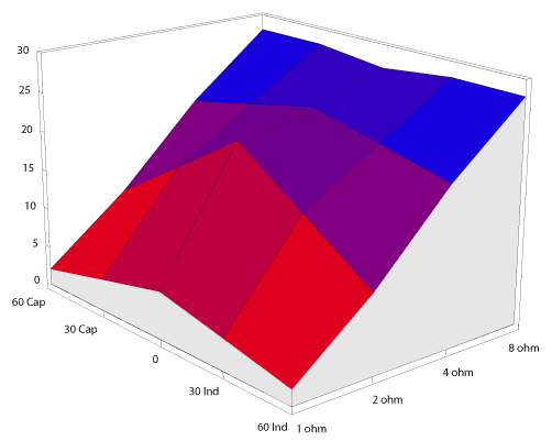

@AcuDefTechGuy, the above is an example of power cube measurements for an amp that is current limiting. I suspect that the OP's NAD exhibits this sort of behavior. Note the fairly good results into a resistve load (what S&V measure), and poor results when compounded by phase angles (which characterizes the load speakers will present to the amp).
Now, this is still all conjecture, but AVRs are notorious for current limiting, heavy handed protection circuits, and thus generally poorer performance. If the NAD were the exception I would be very surprised. Anywho, the Salks 4 ohm load already has the amp sailing pretty close to it's current delivery limits, and the 2khz dip probably enough to trigger current (thus heat) reduction safety mechanisms.
Those back of the unit impedance switches typically simply reduce supply rail voltage, thus heat, and unfortunately output power, to keep the units from cooking their other parts to death prematurely. The high impedance settings defeat some of that current limiting (the amp still has thermal protection that would kick in at some point), hence the suggestion to @tmurnin to try that. (I'm not sure if his NAD even has such a switch, but the most recent NAD I have direct experience with did.) That way, the amp may more closely reflect the sort of power that S&V measured. Your expectations are not too far off base, as the S&V measurements make the amp look pretty good, ditto the asr measurements by Amir (it was the pre section that earned the headless panther).

I assume you meant that colorful power cube ski posted. If so, the following should help, if you take the time to read the whole thing.:) To me, that's an overkill. For most applications, whatever those online calculator says you need, double or triple it and you are good for probably 99% of the moving coil loudspeakers.:D
Measuring Power Amplifiers with Reactive Loads - Audio Precision (ap.com)
PowerCube_12p_brochure_complete.pdf (audiograph.se)
Building A Reactive Load for Amplifier Testing | Page 3 | Audio Science Review (ASR) Forum
