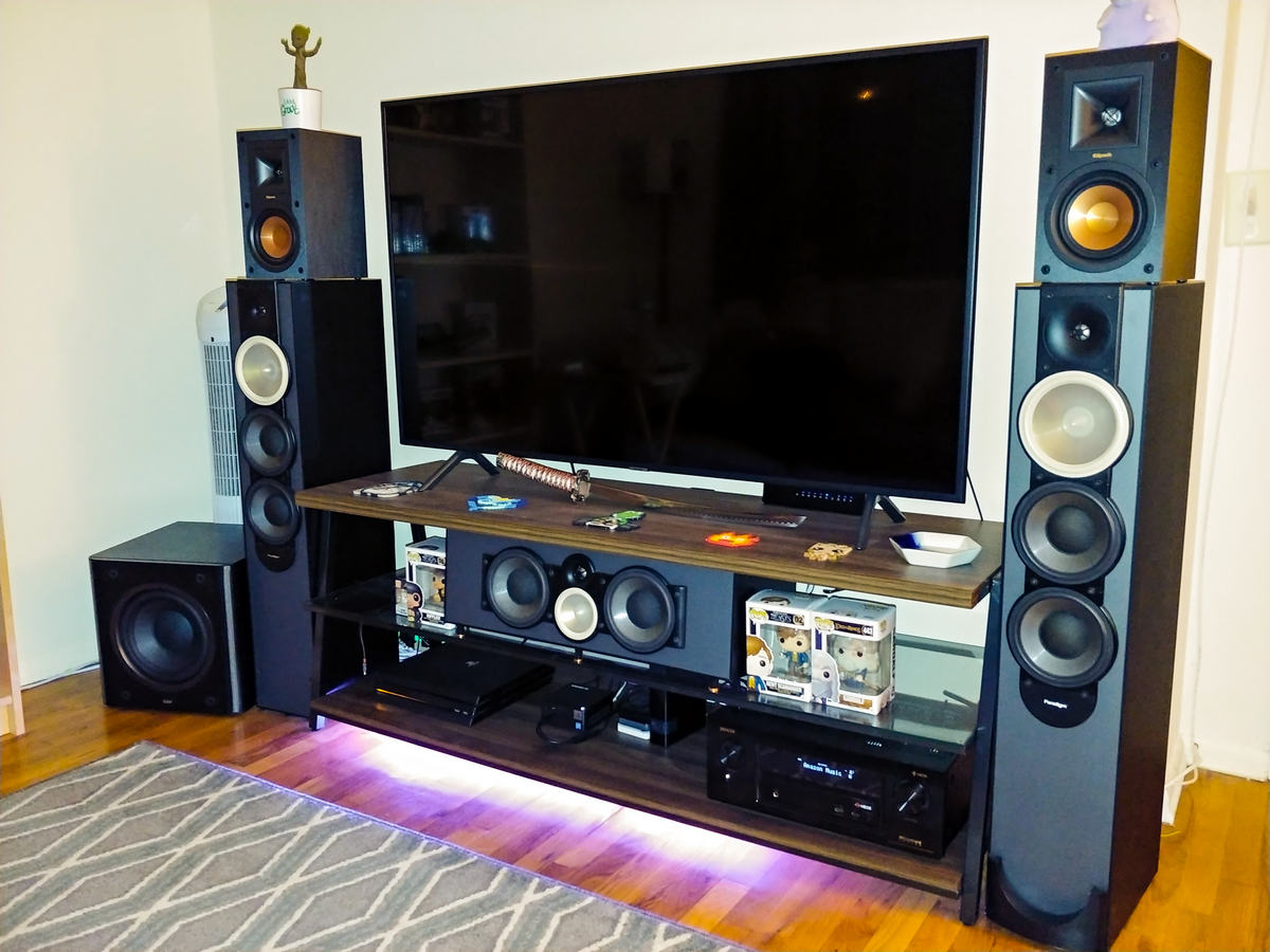

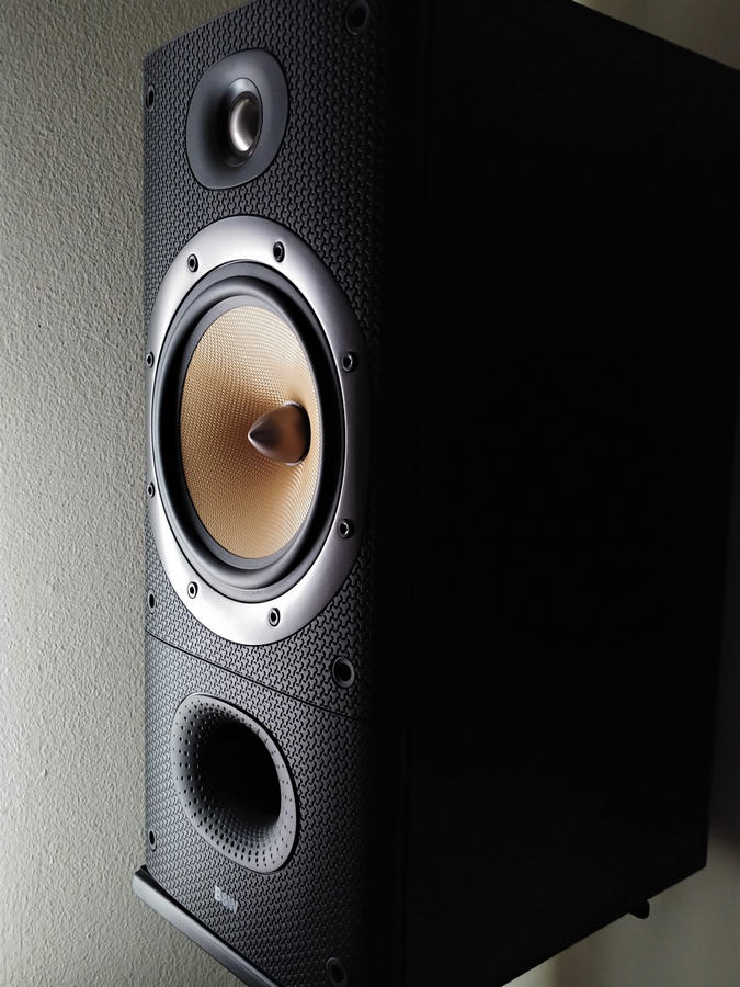

I have the 2400 not the 1400, but that's cool to know. I want to eventually go separate amps once I find a decent deal. I will have to nix the x2400 though and get something with preamp outputs.
But here is my setup, Paradigm Monitor 9 v5 & CC-290 v5 (96dB & 94dB), Klipsch R-15m (94 dB), B&W DM602 S3 (90dB ) surrounds. All are somewhat decent sensitivity:

What do the Klipsch do?
