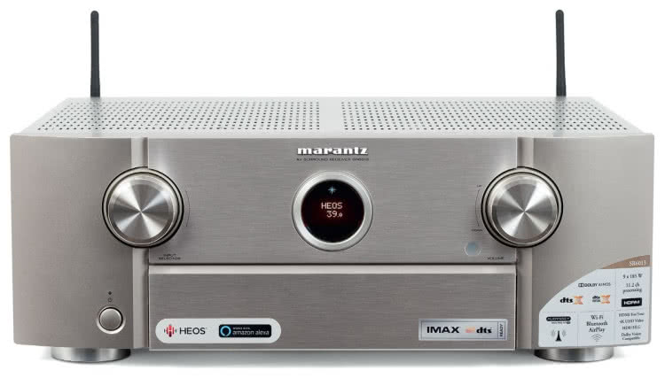

True. This is the first site i see doing 9channel ACD tests though. :) As people are often thinking how much it will drop from 7ch to 9ch, well 9x50w for SR6013 / X4500H. There is also some intresting picks like Arcam AVR550 which isn´t cheap. When tried to measure power for 4ohm load it went in to protection, for one channel it showed 65w. Reading few other forums i noticed NAD V758 V3 and this Arcam model shutting down when listening loud with higher end B&W speakers that drop around 3.5-4ohm. You don´t hear that happening with D&M / Yamaha receivers.:rolleyes: High price to pay for Dirac Live and lacklustre performance, but this is what we get with todays receivers. Lot of features which leads to compromises being made with internal components. I hope we get to see these measured by ASR soon. Nad and Anthem were disappointments.
PENG
Measurements for 9X50W is not very useful, though I agree it is good to have.
For comparison purposes:
- We don't know if it is just the difference between how the unit's protection system operate.
- One that did 9X50W, but 2X150W, 3X135W may be better than another one that did 9X70W, but 2X90W, 3X80W for real world use.
In the old days, some 7.1 AVRs managed very high output into 2 channels (like 150 to 180 W) but would drop to 50 or even 35 W into 5 or 7 channels yet some of those weighed 40 to over 50 lbs, indicated very strong power supplies were used, so the lower ACD results were likely due to the way the protection system operated and if so, it would not be a negative when used for movies and music contents.
Where did you get info stating that the SR6013 will only supply 9 X 50w? In the specs on their site, Marantz specilfy that their receiver will guarantee 70% of rated 110w for ACD. That would be 77 watts, wouldn't it?

Well, yes and no. 2 channel driven may have the same power output in each channel both driven same time. But, as you add more channels to drive, as stated above, simultaneously, power starts to drop.

The following bench test results should give you some rough ideas:
S&V measured the AVR-X1200W:
5 channels continuously driven, 8 ohm loads 69.9W/78W 0.1%/1.0% THD
7 channels continuously driven, 8 ohm loads 47.4W/57.9W 0.1%/1.0% THD
Audiovision.de measured the AVR-X2400H:
154 W X 2 into 4 ohms
88 W X 2 into 6 ohms (this seems low, likely a typo, it was 128 W X 2 for the X2600H and 100 W X 2 for the X2500H measured by the same magazine)
98 W X 5 into 4 ohms
80 W X 5 into 6 ohms
73 W X7 into 4 ohms
60 W X 7 into 6 ohms
No THD specified, I would assume 1%.
