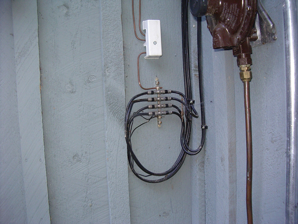

Any by the way, my grounding system allowed me to use the grounding blocks on my satellite system and FM aerial, without the system roaring like a banshee, which it did before construction that carefully planed grounding system.
Here are the grounding block, tied to the grounding rods along with the grounding of thee fiber cable.

I do have a question on your setup there. What is that thing on the right of the block? Is that a gas feed?
I ask because of the following: My wife and I were in a kitchen of a house when a storm passed over. The bolt that hit the house next door (50 feet or so away), scared the livin daylights outta us. The house had a fireplace which was modded to include a gas insert, and they put a metal pipe up the flue to a metal cap. The bolt hit the cap (bypassing trees less that 10 feet away and 20 feet taller), then tried to follow the gas flex line to ground. Unfortunately, the flex line had a big loop in the living area, and the bolt found it easier to bypass the loop because of it's added inductance, thereby going flex pipe to flex pipe. In doing so, it punctured the flex and ignited the gas. Luckily, the owner came out from the city a day earlier and was sitting in that living room reading the paper. He averted the house burning down.
You have a grounding system which provides a potential path all the way to the cable block, but then nowhere. A bolt might find it easier to ionize a path to that pipe right next to it rather than to the grounds you went out of your way to make. So I'd recommend that you call in a professional to look it over, and you'd be really well served to tell that pro that some internet "yahoo" (me) thinks it might be a concern..
