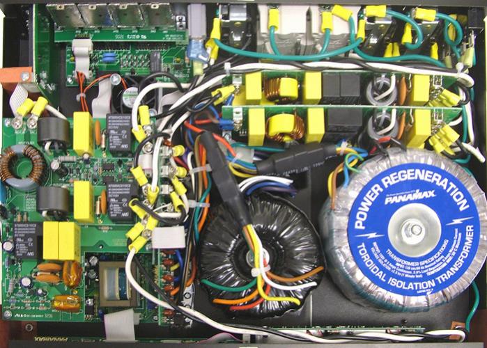

Hello, got an image from the Panamax site of their flagship power centre. Anybody able to find out what the second smaller non-marked torodial transformer would be used for? Is this a dual balanced power transformer configuration?
The datasheet for this power centre claims this:
"At the heart of the MAX® 7500-PRO is an advanced power filtration system featuring a 720VA isolation transformer, that
provides power for digital source components and displays."
"Voltage regulation and Balanced Power"
So Im not sure what it could be...any guesses? Engineers?
Here is the link to dataspec sheet:
http://www.panamax.com/PDF/Datasheets/L576_D_M7500_PRO.pdf
I figured out the answers by myself. FWIW...and to anyone who cares....The secondary torodial transformer-looking device is actually the device that automates the voltage regulation. The larger looking thing is the real torodial transformers that gives this power device the balanced power feature.
Thanks for nothing *****es!
W
westom
Which means it is doing what is already done better inside electronic appliances.
