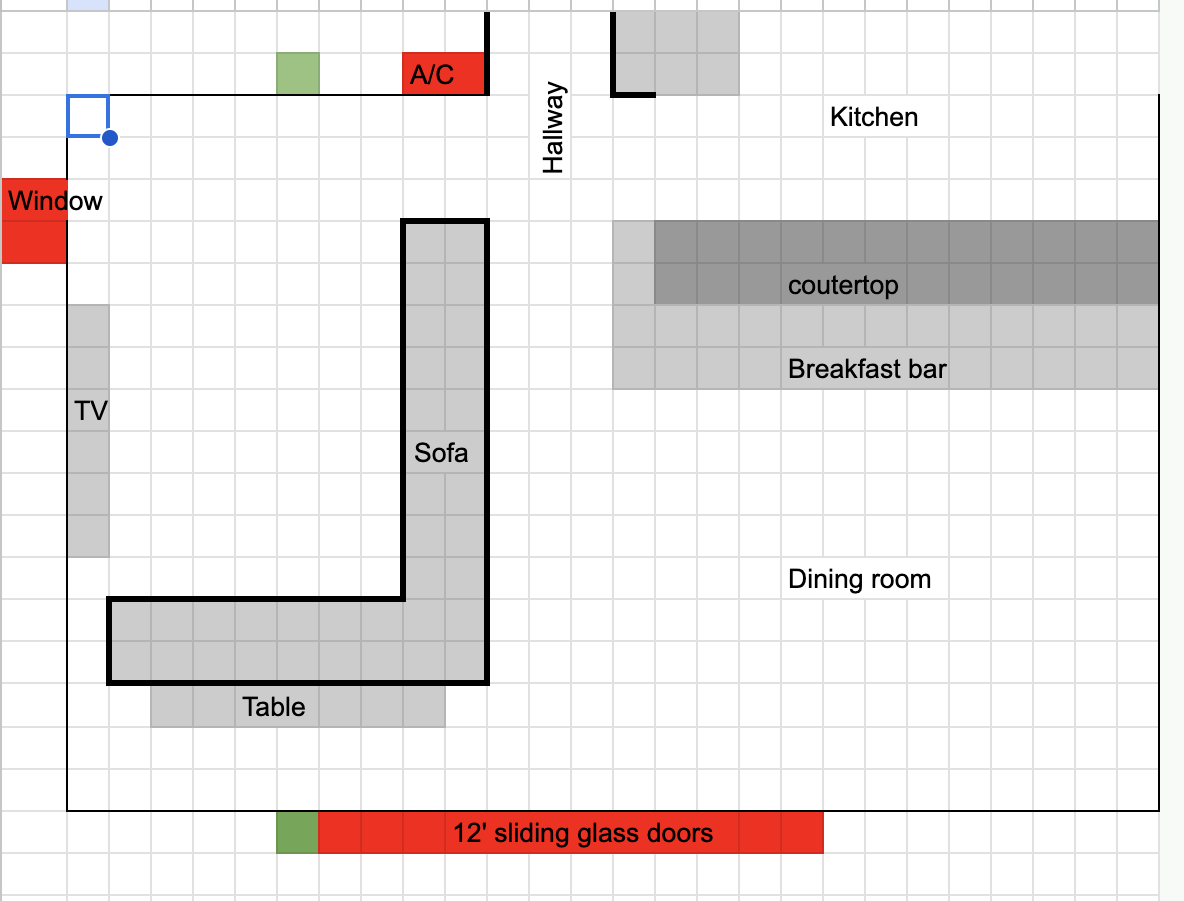

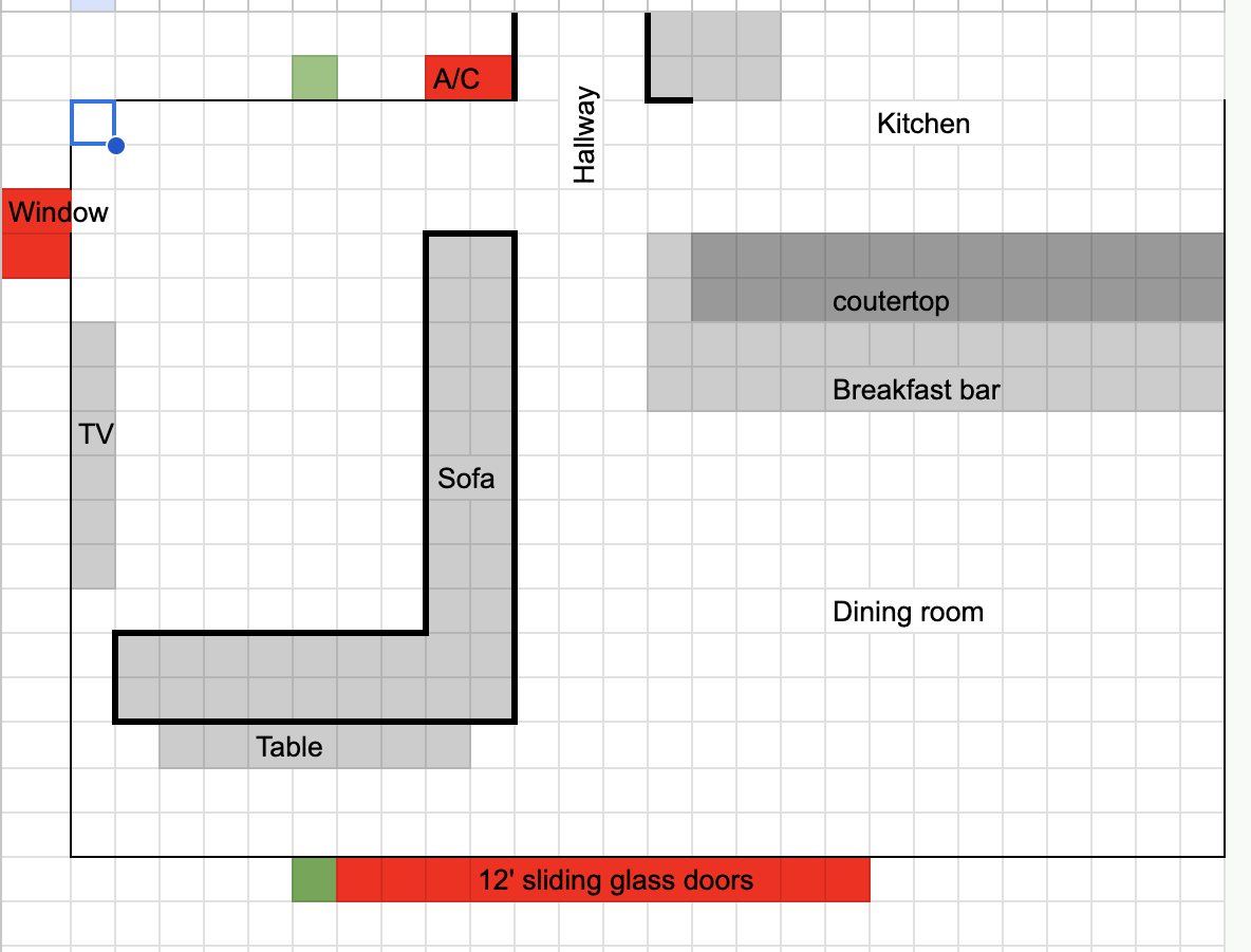

Green are suggested in-wall placement
Those positions are not ideal.
will they work?
…perhaps?…
Is it worth the risk?
I wouldn’t cut holes in my wall for that.

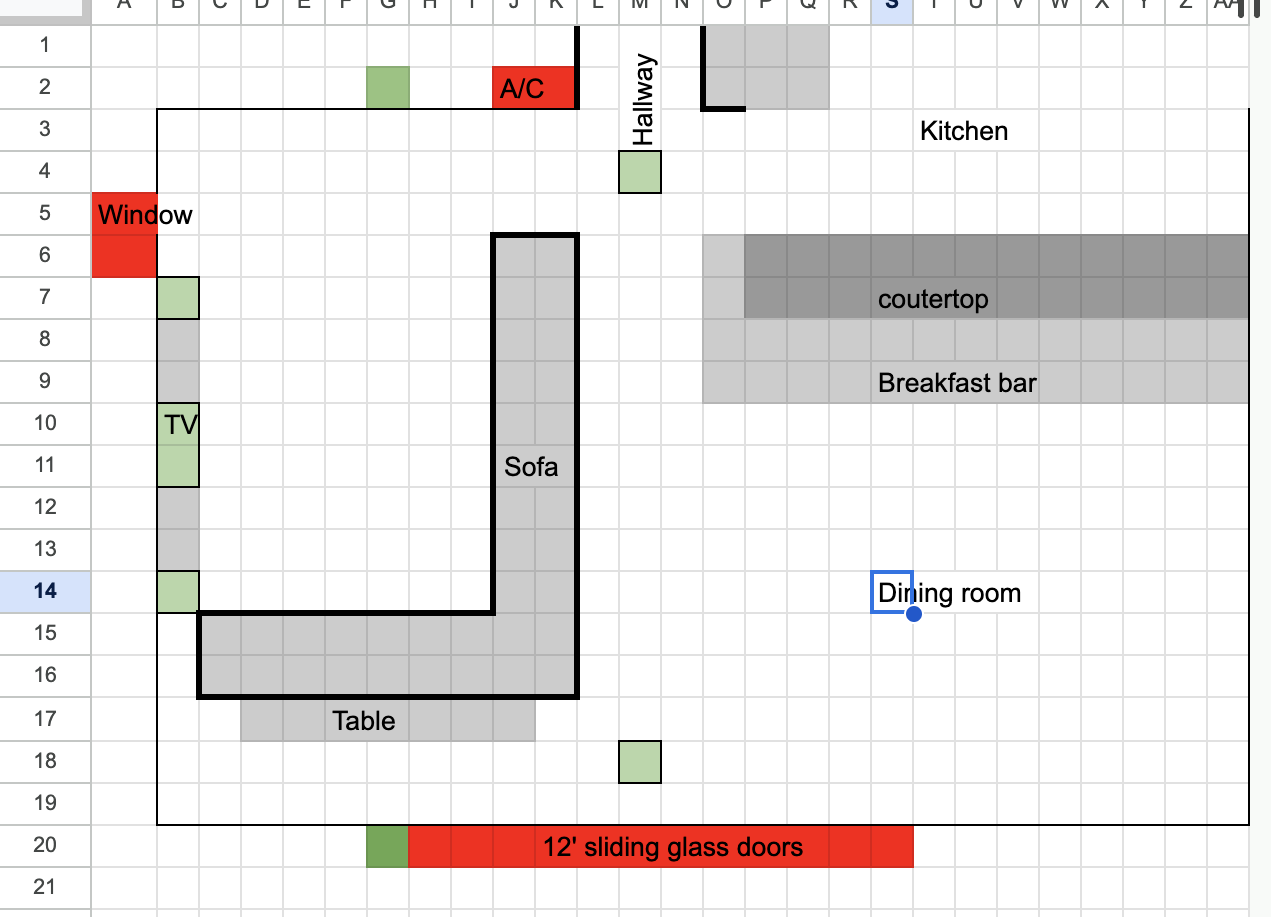

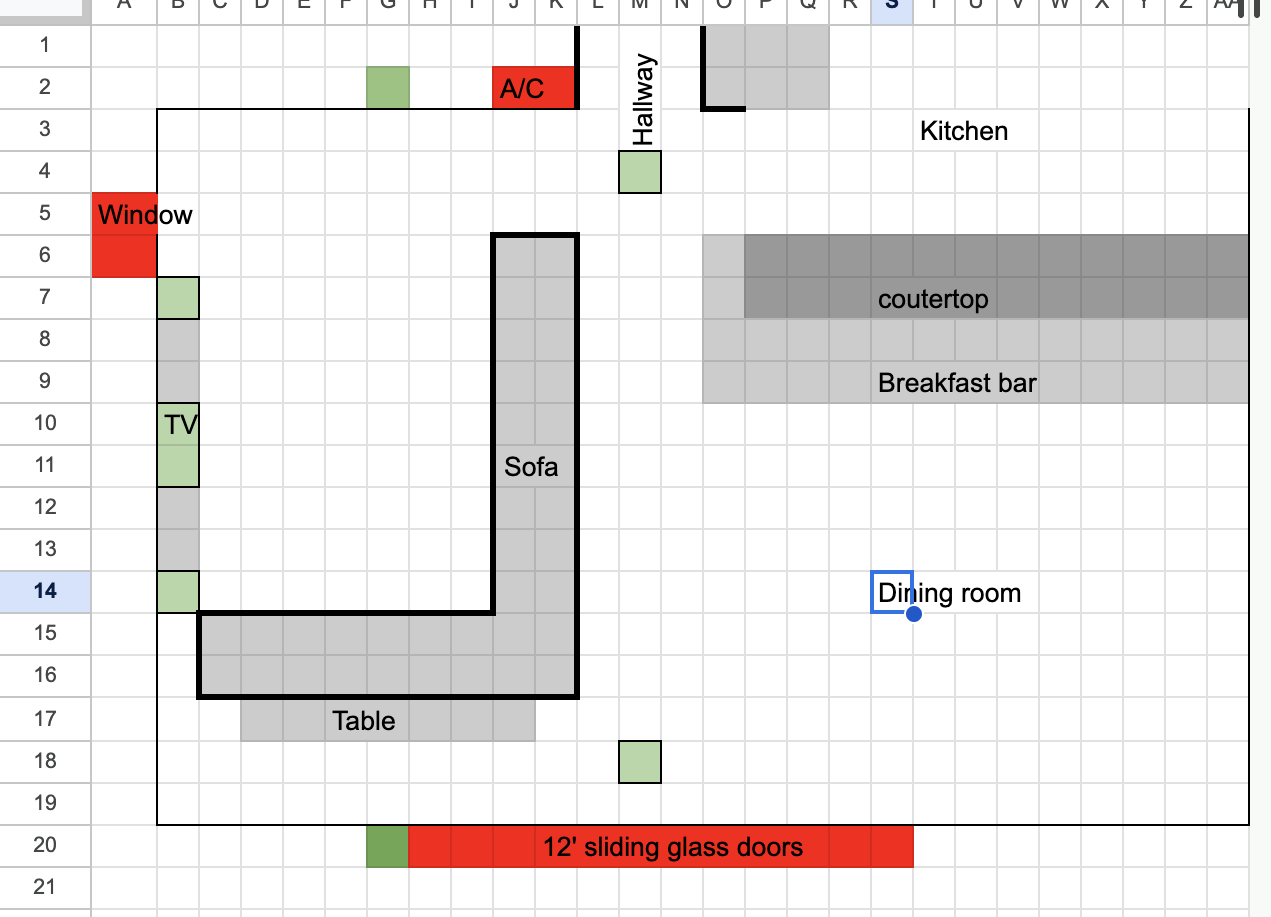

Thanks. To clarify one last time before we sign-off. I don't need to invest any more money, everything is already here. The stand bookshelves have been placed next to the sofa on each side without much of a problem for a 5.2 (I have 2 subs). The question is will this 7.2.2 layout improve me experience, or degrade from it? I was considering adding two ceiling speakers too, so could go 5.2.2 or 7.2.2. I could make a dedicated theater in the basement but I know I'd rarely use it, and that would truly be a waste of money.
You can add all the speakers you want, but I would bet that the room will sound best with just a front sound stage. I suspect the more speakers you add, the worse the result.
