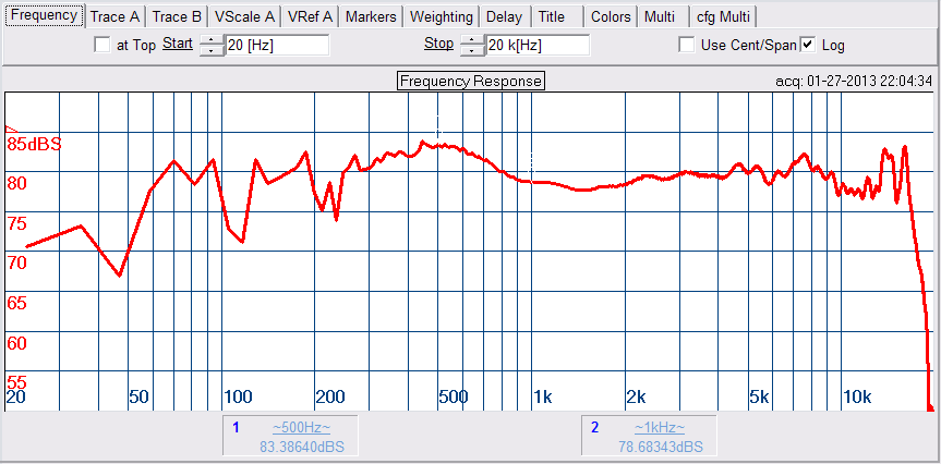

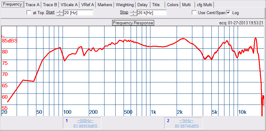

The on-axis response is plagued by dips and peaks introduced by the wave guide. These smooth out nicely off axis (at around 45 degrees), but the damage has been done as far as early arrivals and tonal accuracy.
When you say waveguide, is it a GedLee/Revel style waveguide or a honky Klipsch type horn?
That is unfortunate to say the least!! I'm surprised you can last 37 seconds! :)
To be fair, I don't think that's the majority of speakers with waveguide. LSR6332 sure doesn't look like that, nor does the Salon 2, Studio 2, Dave's Echelon, GedLee Abbey, etc. :)
I ain't talkin', but I will say that what you see is what you get, and perhaps some of those other measurements you've seen aren't quite what you get? For the record, I will say that these are not Salons. The Harmon group knows how to implement wave guides.
If they were Salons I'd say you make a bit more money from Phil audio than I realized! :)

There's also this chart for comparison, though it doesn't have the descriptions.
Let's just say you might be surprised which speakers those measurements are from.;)
