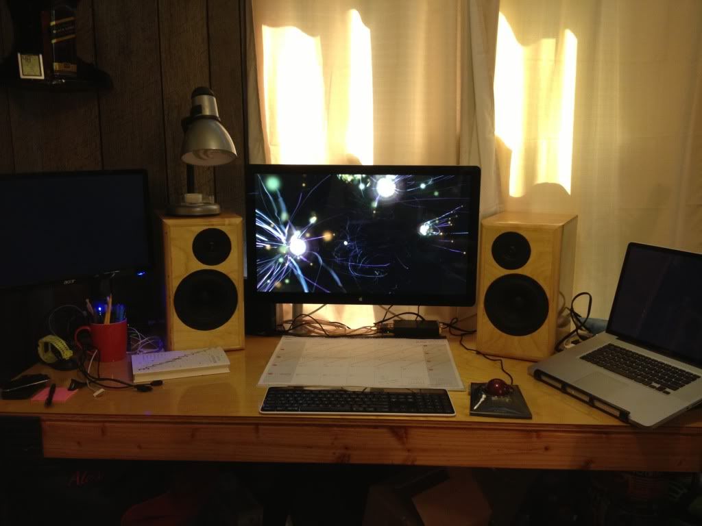

Well after doing some far field listening to them (where they sounded tremendous) I decided to set them up where they'll actually be going. The monitor pads are on order which should get them up to ear height and decouple them from the desk. If you were wondering how they sound, lets just say they haven't been off since I finished buttoning them up. I don't see them being off very much in the future either.

It's amazing how good these little bookshelves can sound once you get the right finish on them. :D

Fuzz I think you have the right on the left and left on the right, lol...
If they sound half as good as they look Im sure they are great... good job..
I didn't go for a mirror finish, just super shiny. However, I can definitely see why a mirror gloss costs extra and guys like Del hate doing them. My arms are numb.
I'm pretty sure tweeter offset goes towards the inside. Either way they're like a foot from my face so it can't matter that much :p :D

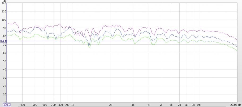

Anywho, purple is right channel, blue is left channel and green is averaged, all from the LP which is about 2.5ft from each speaker.

Nice frequency response, btw. Is the average lower than the individuals because of interference? Yes...I'm that ignorant.
