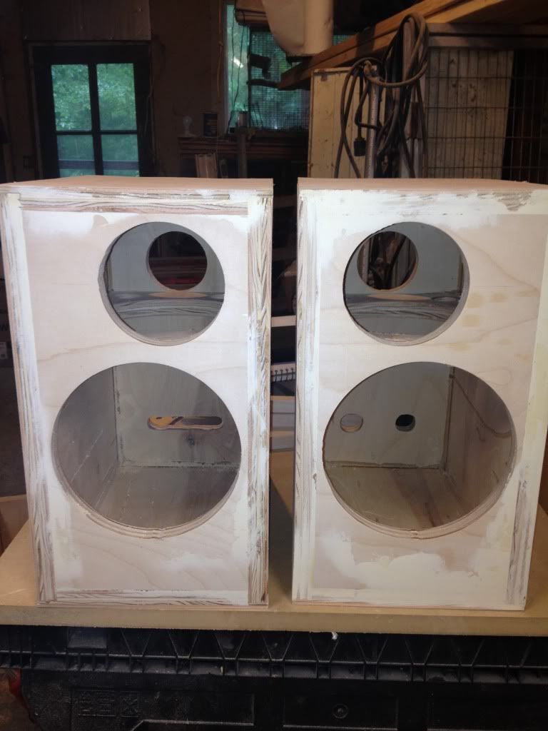

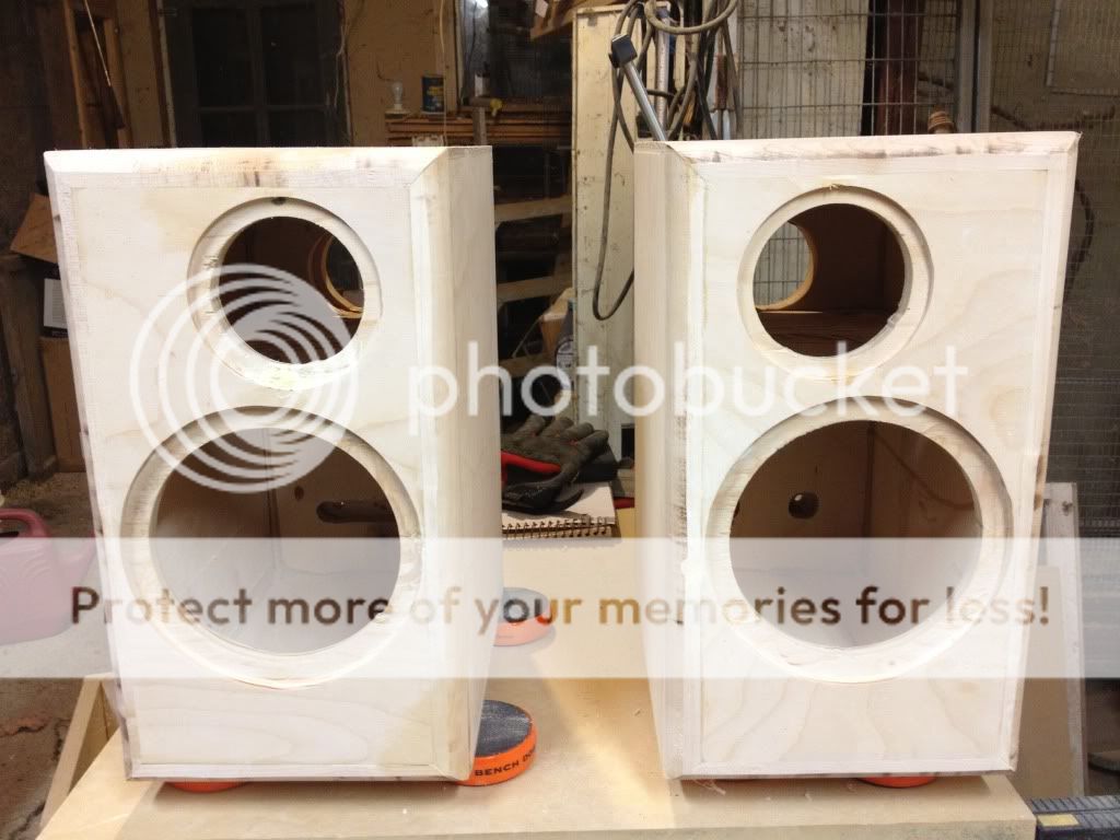

Cracks filled and sanded. Ready for the outer baffles.

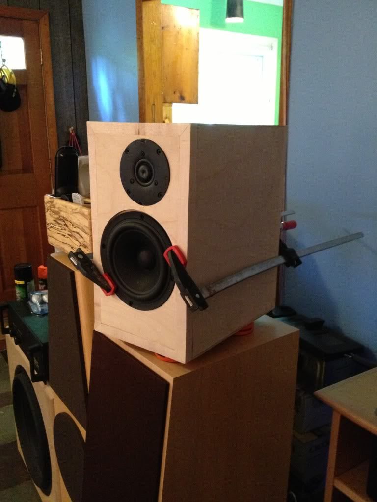

Getting some of the trim pieces fitted.
fuzz092888
fuzz092888

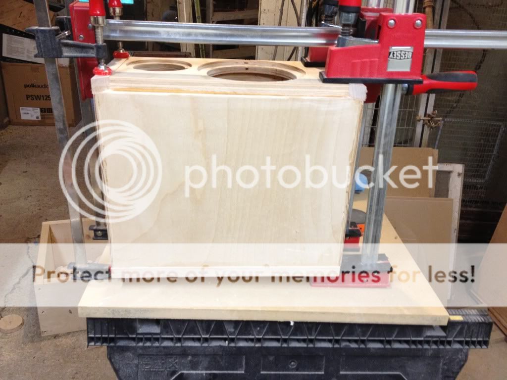

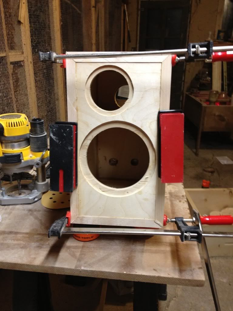

Well, the rear baffles and trim are on and the outer front baffles are glued and clamped. Tomorrow, hopefully I'll be able to get the trim on both cabs depending on how many clamps its going to take per speaker. If it all works out tomorrow, then on Thursday I'll be able to do a little trimming with the flush cut bit and then I'll bring them up to the apartment for a little test to see how it all sounds. If all goes well I'll start filling in the last minor cracks and sanding by the weekend. Then the arduous finishing process begins.

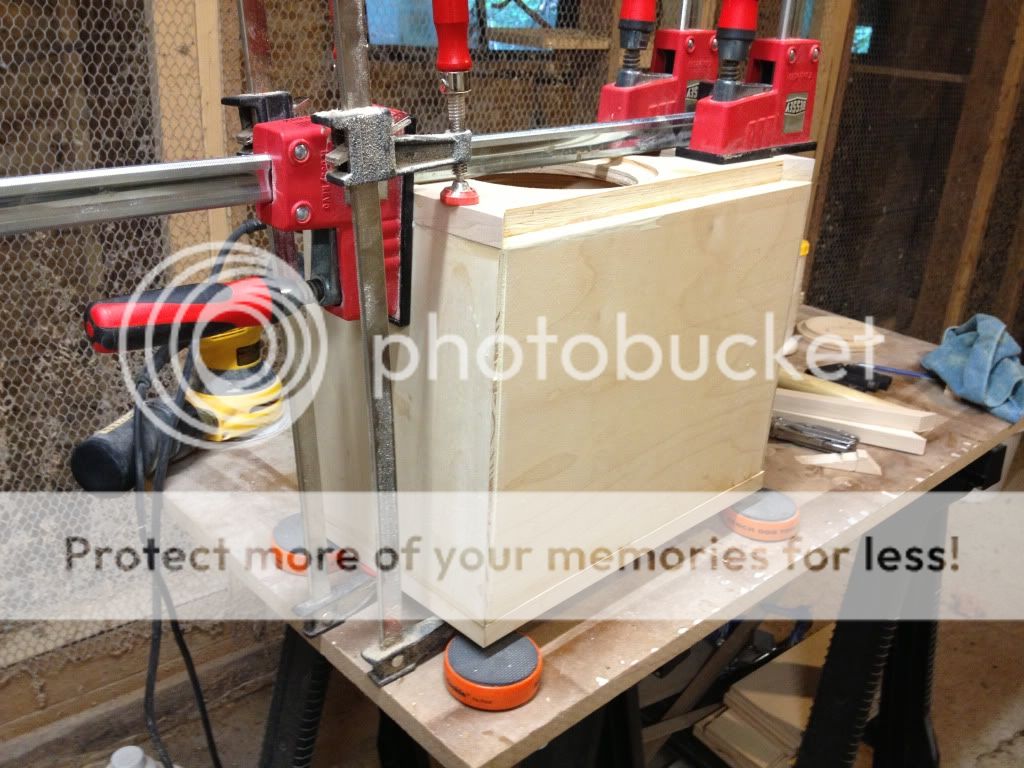

As I suspected, not enough clamps to do all 8 pieces of trim.
fuzz092888
fuzz092888
I always take it slow with the glue up. It's the easiest time to destroy a good box IMO.
Very true. During my first build, the 18" sealed sub, I went too fast with gluing some side panels together and I ended up having to break the joint, sand, and redo it. What a pain that was. With these trim pieces I purposely had them a little big because I knew things would be a little off. No matter how many times I measure and calibrate that table saw it's still not accurate to within more than a 16th of an inch, but at least it's consistent so I can at least plan for it, for the most part. I'd really like to get a digital meter for the fence, which will at least hold me over until I can upgrade it someday. I've also considered the incra fences, but they're more money than the table saw and I keep wondering if it won't be something like putting lipstick on a pig.

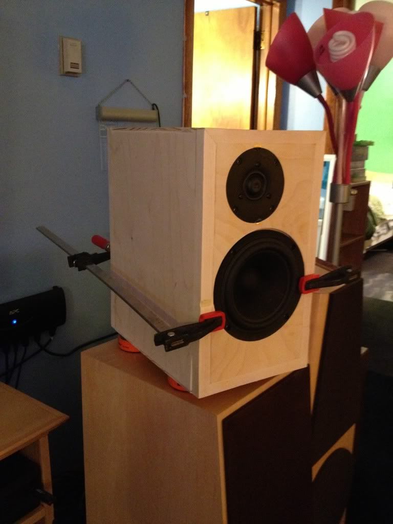

One more day of work until I get to dry fit the drivers and give the speakers a dry run. If all goes well, they'll be apart, tested, and back apart for finishing by Friday.

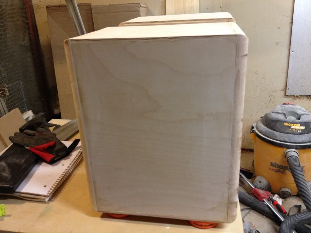

Roundover complete. I decided not to go all the way with the round over and instead left a little trim untouched. I actually undershot the round over, liked how it looked and so I left the bit height where it was. They look pretty good to me :D Can't wait to get the first coat of Danish oil on tomorrow, however I'm sure my shoulders won't appreciate all the rubbing that is to come.
