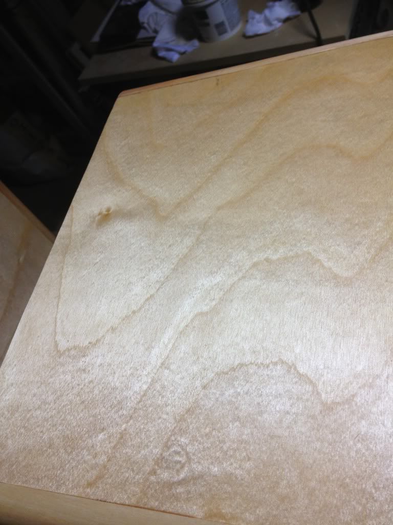

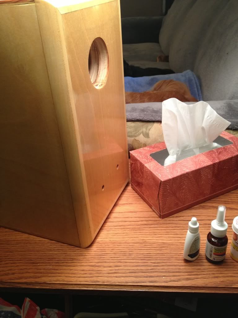

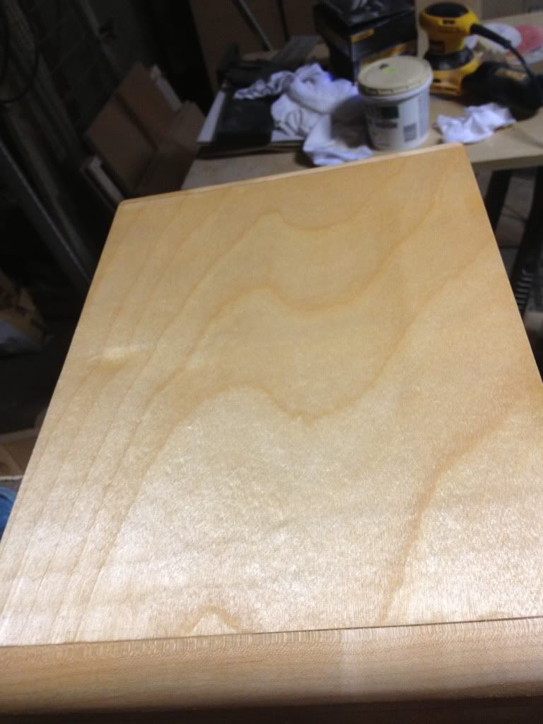

Progressively sanded from 80-600, then two coats of Danish Oil. I'll let them sit for 24-48 hours then do another two coats.

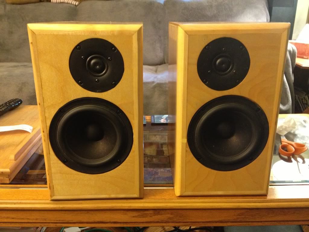

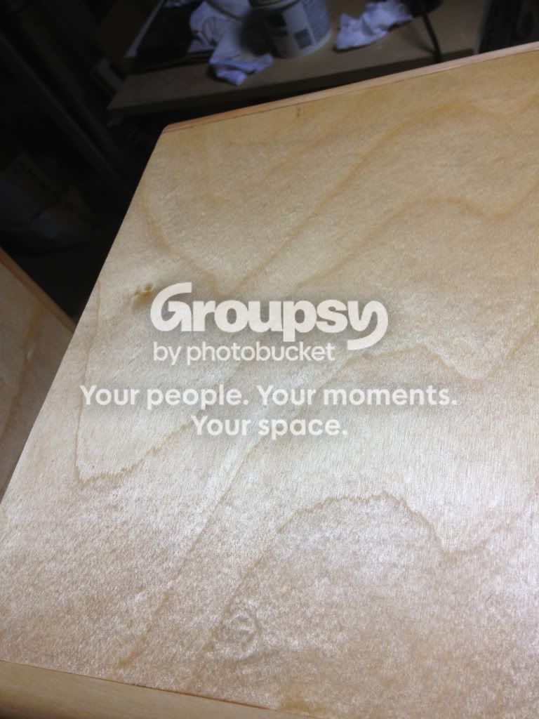

Let me pretend that I'm a Maritime dwelling Canuck (GO-NAD! :p) and ask you about the plywood end grain left showing after the most excellent rabbet used in your panel joint. Is that a tooling burn just to the right of the woofer?
Your work has gotten to a level where small detractions are all that separates you from the big leagues. Don't get me wrong, I could and would easily live with that level of finish and I know you're just starting out in this finishing madness. It will be interesting to see where evolving taste leads you. Light wood and Maple were also my starting points taste wise. It's like you're following in my footsteps but are a couple of light years ahead all at the same time.

Well at first I was planning on doing more hardwood trim, then I wasn't sure I had enough and ended up buying more so it was a whole fiasco. In the future I already know how I'm doing it differently so there should be zero end grain, at least until I break into veneering.
Yes that is a burn mark and there are more. I purposely left all burn marks and tried not to sand them all out. I might be super weird, but I kind of like how they look and add a bit of dark to all the light wood. As to the light wood, it has more to do with what's allowed into the house at this point. When I have my own dedicate space all bets are off :)

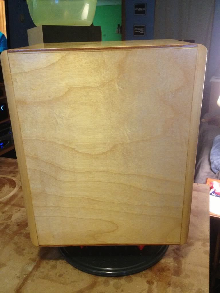

Almost ready to start the last leg of the finishing process. Just giving the Danish Oil a few more days to dry since its been so humid here lately.

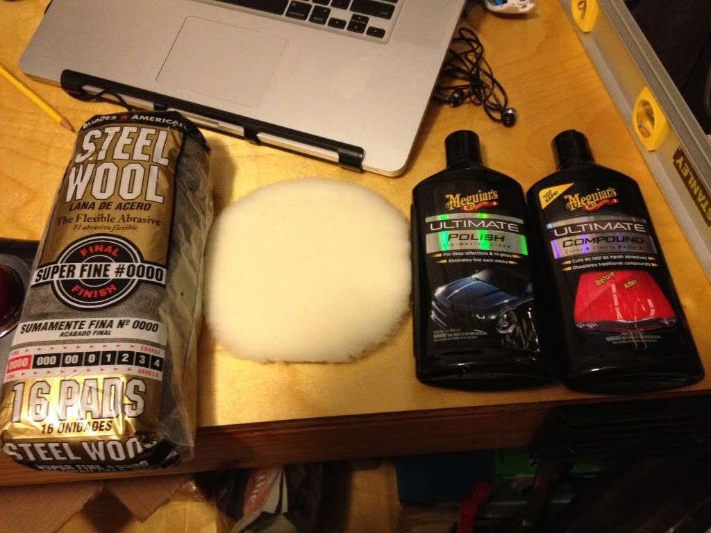

After using the steel wool, be sure to vacuum out the cabinet well, inside and out. If you have a hand-held magnet, cover it with a thin cloth and rub it all around the cabinet, inside and out, before you mount the drivers.
It's amazing to me how those tiny steel wool bits accumulate everywhere – and eventually find their way to the woofer magnet!
Steel wool bits have also been known to get stuck in brushed on varnish finishes, and rust with time. I don't think this will happen with a thin finish like Danish Oil, but it never hurts to look out for that. Rust stains wouldn't look good on your light maple finish.

Looks good. Next set you build, try some pure tung oil. I build a lot of furniture and my go to mixture for a deep, high-pop, long lasting finish is a mixture of tung, poly and mineral spirits. (33% each)..as many coats (1 per 24hrs) as the wood will take.
If you're looking for a truly high gloss finish, I start with a couple of coatings with an oil poly, thinned with mineral spirits, wiped on with tack cloth, then hit it with the sprayer, get it good and thick on there, then a quick over with 2000g wetsanding and some buffing.

Isn't that basically what Danish Oil is? I thought I read somewhere that Danish Oil is more or less thinned tung/poly mix. Is there a difference between Danish Oil and doing the mix yourself?
Whitey80
Whitey80
Most all shelf-available Danish oil is 2/3 linseed, as it is far cheaper than tung oil. The remaining 1/3 is most often an oil poly.
Starting with a real, pure tung,(which can be somewhat expensive) instead of linseed, will provide a noticeably higher contrast in the grain. Mixing with mineral spirits just thins it for deeper, more consistent penetration.

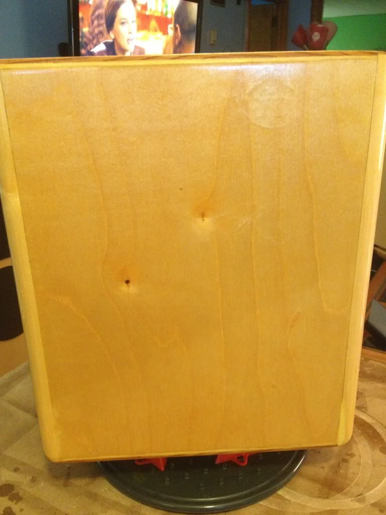

My least favorite part, not because of the work, but because of the waiting. Anywho, first coat of poly. Now I just need to leave them alone for a few days.
You weren't kidding. There are so many steel wool bits, it's like the pad is just disintegrating, but darn it that cab is squeaky smooth afterwards.
