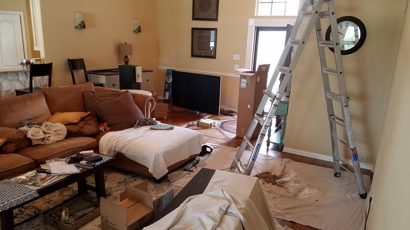

Getting a 80 lbs sub up in the attic, taking it all the way to the opposite side of the house while balancing on 2x4's and the holding it on the drywall but with only a little bit of it's weight pressing down as your buddy screws it into the joists was not fun at all.

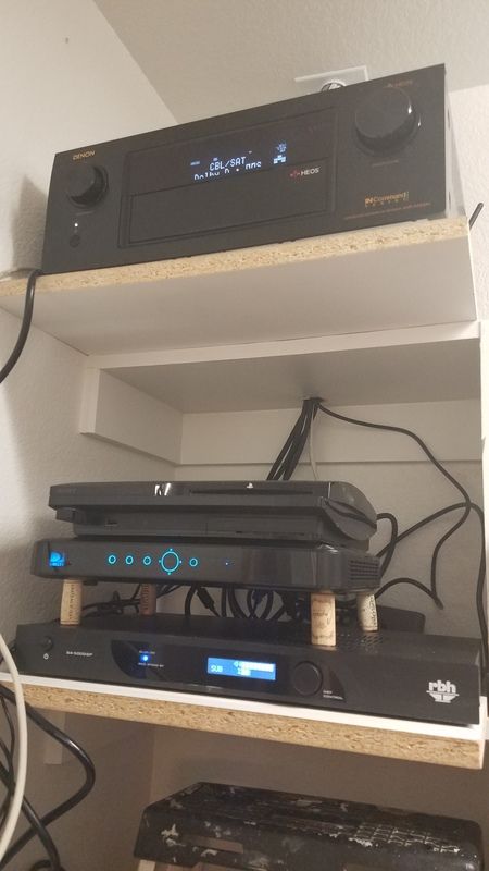

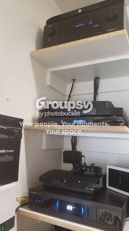

I have a lot of other stuff going on with coordination of the remodel so I just threw the gear in the closet where it will stay but I will go back and properly tidy up everything with cable management. I just wanted to have some music and TV in the meantime.

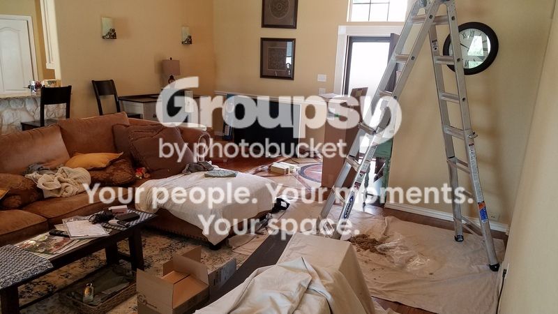

Getting started:

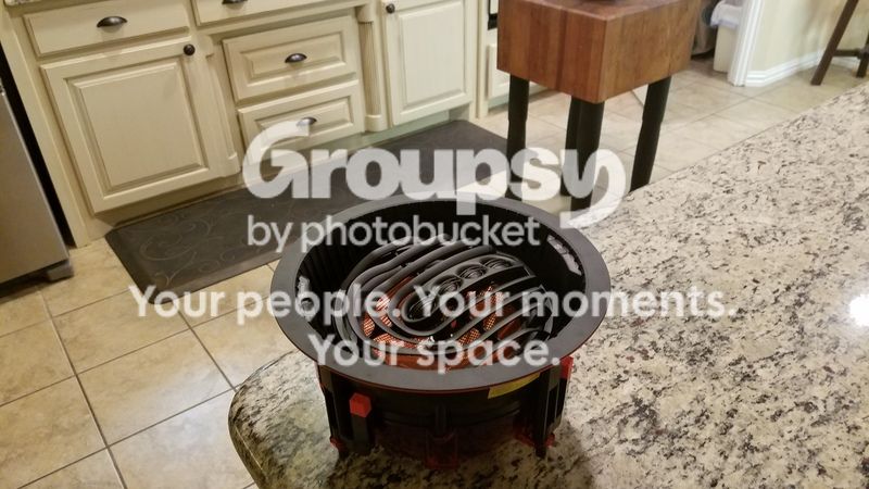

Some huge in-ceilings:

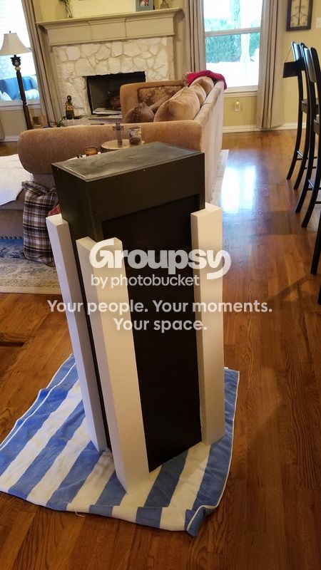

Sub before install:
Sub after install:

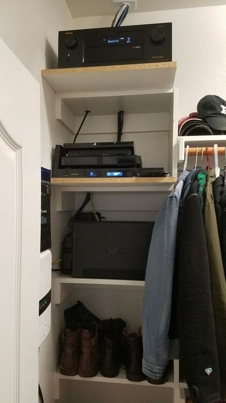

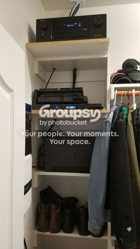

Sloppy gear closet:

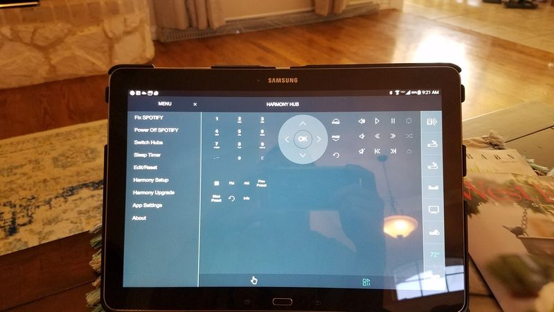

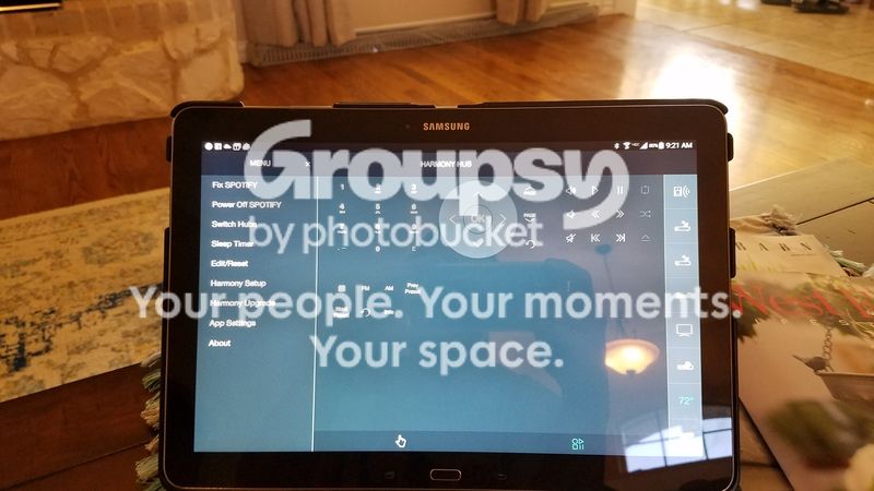

The best control system I have had to date:

Getting started:
Sub before install:
Sub after install:
Sloppy gear closet:

They definitely did their homework on the new remotes and hub.

I have a cable track to completely hide the rest of the wires/cables but I got this far yesterday and was like "who cares, it's in a freaking closet"...
I will go ahead and finish out the end of the shelves so they are at least white. I think you can just buy some iron on veneer, correct?
I use this stuff on my diy subs
If you have a Rockler store near you, they'll have some kind of veneer. If you decide to paint it, rub some drywall mud into the end, let it dry, prime it and paint it.

SpeakerCraft AIM 8 TWO Series 2

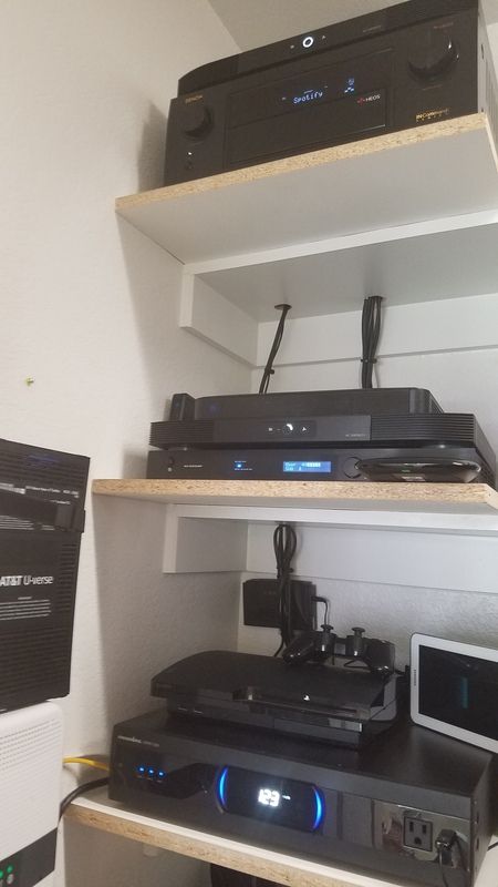

We are in between phases of the remodel so I went ahead and ran 8 point calibration and this system just sounds pretty darn good.
I also added active cooling and power conditioner. The reason is....I felt like buying something since I gave up so much...lol...

Looks sharp all tidied up like that. Is that out in the garage or in the office?
