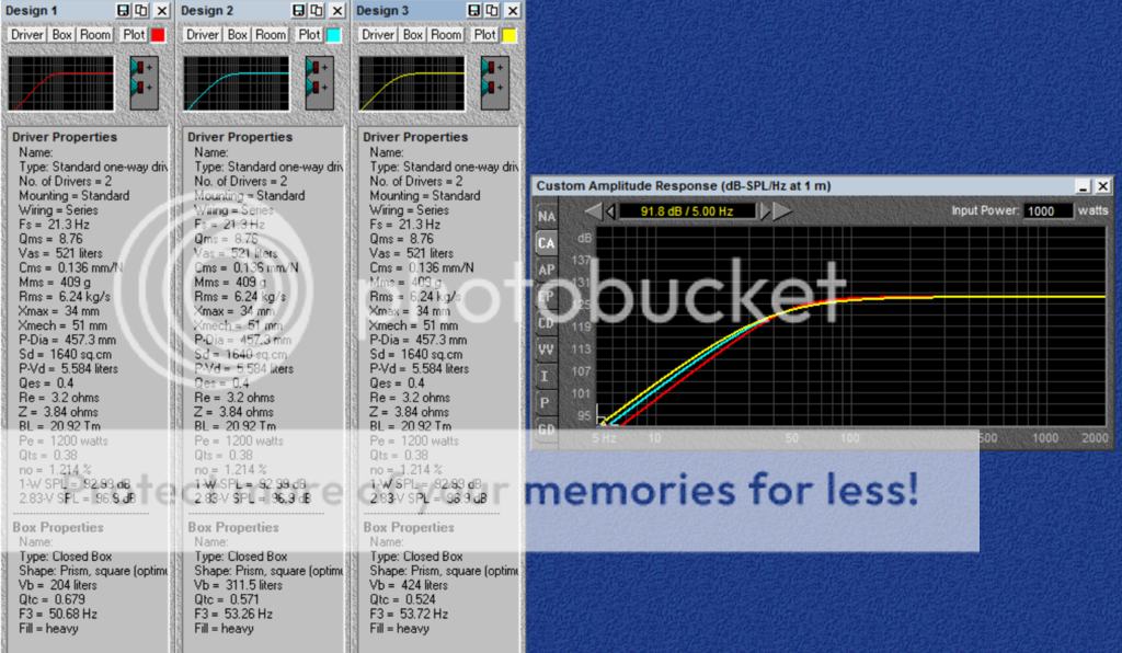

New question: how much Vb do your LMS's and UXL's currently get?
fuzz092888
fuzz092888
LMS are currently in 4cuft flat packs from diysoundgroup and UXL's are sharing about 4 cubes after bracing and whatnot.

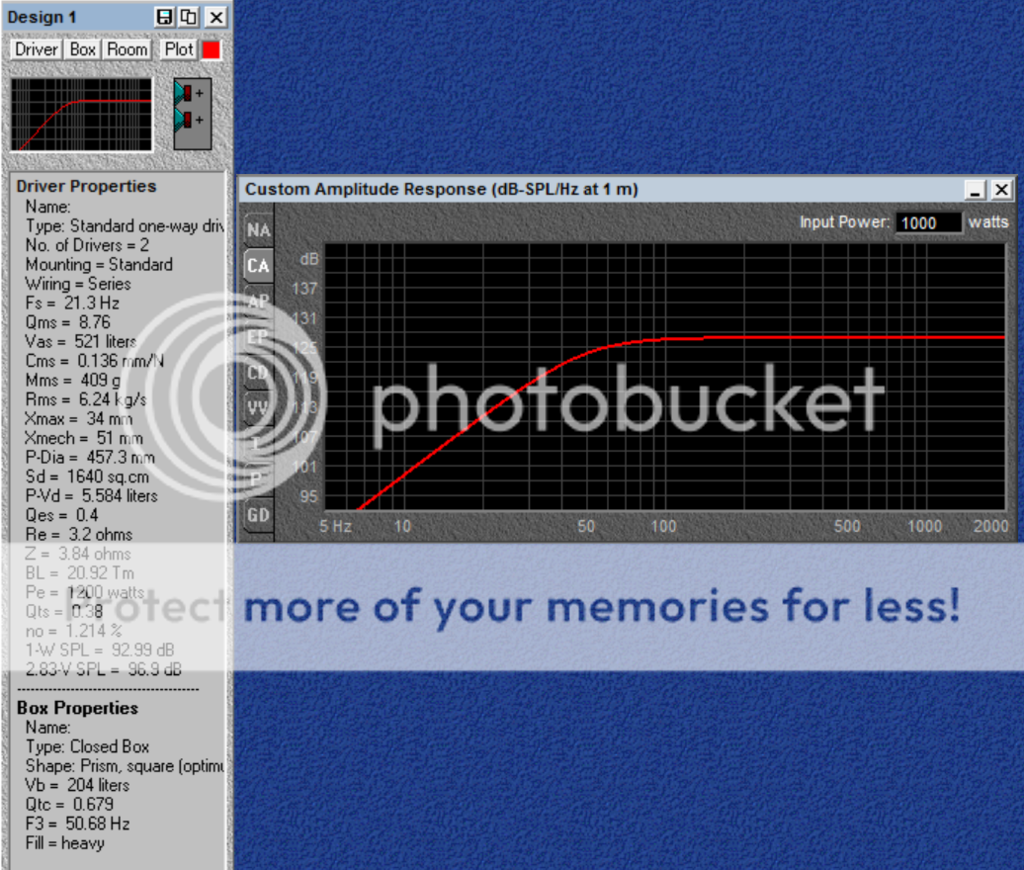

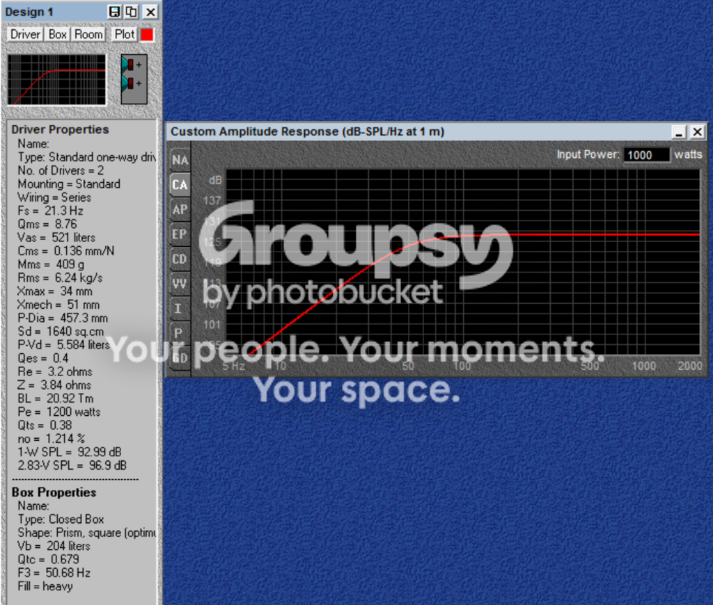

Also, I may run with a new plan. I was fartin' around and had a thought as I was pursuing diysoundgroup. There's a dual opposed 8cuft flat pack on there that would just about fit the FTW drivers for about $160 to my door.
Doesn't look too bad, total Vb is about 7.2 cubes. Roll off starts around 76Hz, F3 is 50.68Hz before boost is applied. With 1000 watts, before the roll off it's modeling at 126db, and at 10Hz it's at 99db.

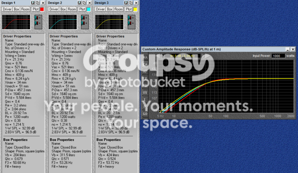

It's not great considering the numbers are for 1m. A single LMS-U put out 93dB at 10Hz in Josh's long term sweep test with a 73V input, and that's at 2m with 73V representing just a tad over a kW to the load. A pair of FTWs will still have more in the tank, but that box size is going to drive down the low end efficiency.

It's not great considering the numbers are for 1m. A single LMS-U put out 93dB at 10Hz in Josh's long term sweep test with a 73V input, and that's at 2m with 73V representing not a lot more than a kW to the load. The FTWs will still have more in the tank, but it looks like that box size is radically reducing low end efficiency.
I dont' know that I agree. According to the models the difference between 7.2cuft vs 15cuft at 10Hz is 4.3db. While that represents a doubling of power and a bit more, weighing that against the size, cost of build and time to build the larger box vs ordering the flat pack isn't insignificant. Plus the F3 of the larger box is 3db higher at 53Hz. While the larger box can certainly deliver a bit more down low and make the roll off a bit shallower, I'm not sure a 3db difference at 20hz and a 4.3db difference at 10hz is radical enough to offset the other factors involved.
Think of it this way: given your current circumstances, how big of an upgrade will the FTWs loaded into the 8cf flat pack represent over the UXL DO box it will replace? I'm guessing you aren't making the UXLs beg for mercy, so the main benefit beyond bragging rights is an incremental gain in efficiency. Doesn't exactly seem worth the effort, but that's just MHO. The big box, while a giant PITA, would turn that marginal gain into a reasonably large step up. Still, I'd agree that I'm not sure it's really worth the effort/massive box in my living room.
Given the practical issues that you're facing (space, power, etc.), I'd think hard about simplifying your setup. Putting each FTW into a ~7cf cabinet, and selling or storing the LMS-U's and UXLs until you move seems like the most viable option. You won't sacrifice any output over your current setup and it wouldn't necessarily take up a lot more room. More to the point, with a single 15A/120V line, it's not like you're going to do justice to a pair of FTWs and a pair of LMS-U's anyway.

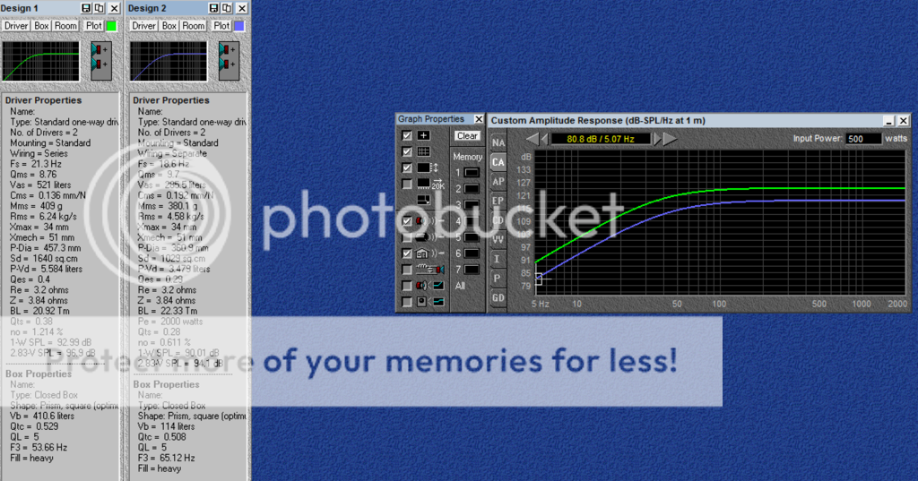

Well thanks to Steve's badgering :)p) I redesigned the box. Now I'm sitting at 14.6-15 cubes not counting bracing and driver volume. As best as I can remember, this is the new box vs what the UXL's have right now. Still fits on 4 sheets.
Also to be noted is the this is with 500W, which should keep me well within what the wall can deliver.
