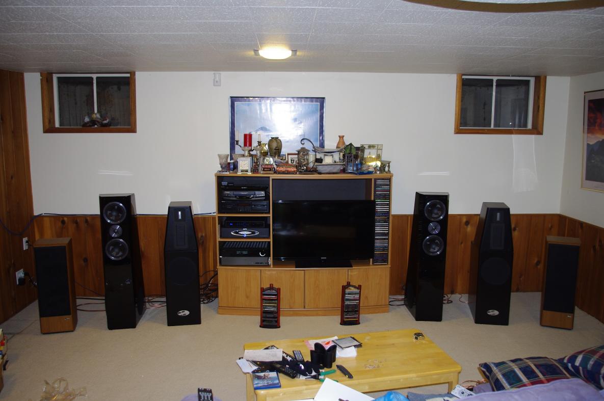

I just finished getting them all set up. On Monday I plan to tweak positioning etc. to try to get them dialed in. So, I don't want to really post many listening impressions yet.
I do have a question. Over on AVS one member mentioned that he thought the crossover from the midrange to the dual 8" woofers, which is at 160Hz, is too low, especially if you use the towers with subs and crossover at 80Hz. It would seem to me that is not a design flaw as long as the midrange can play down to 160hz and the crossover is done right. Any thoughts from the experts? I do agree that for HT, the extra low-end on the Ultra towers might be a waste.
Here are some pics:
