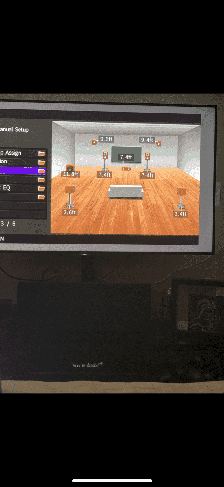

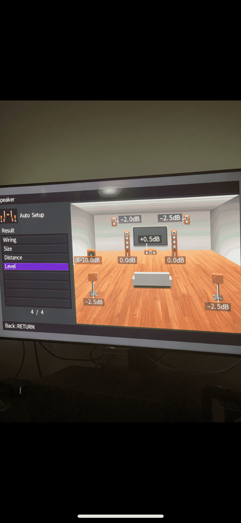

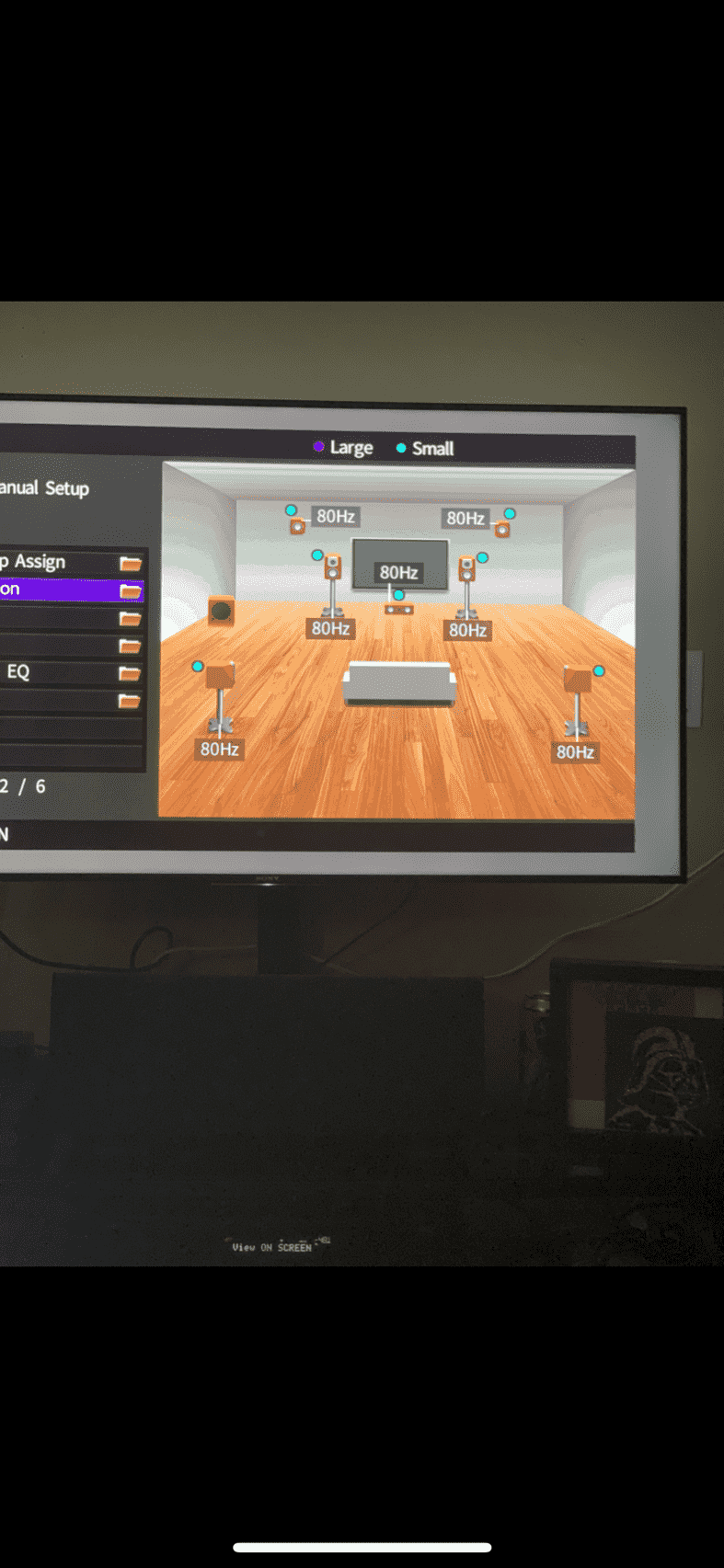

here are the setting of the distance, initial volume setting and then my changes to make everything small and 80hz
View attachment 39467View attachment 39468View attachment 39469
Levels look good. The way I understood your description of levels was that the 3 front speakers were maxed out on the AVR side with no possible room to increase. Are the distances relatively accurate?
Rerun YPAO but make sure adaptive DRC is turned off. Its job is to control dynamics of the soundtrack and bass is usually very dynamic.

Ah sorry about the confusion, yes, the distances are relatively accurate, except the subwoofer is about 3 feet further, but I've read that's usually done on purpose.
