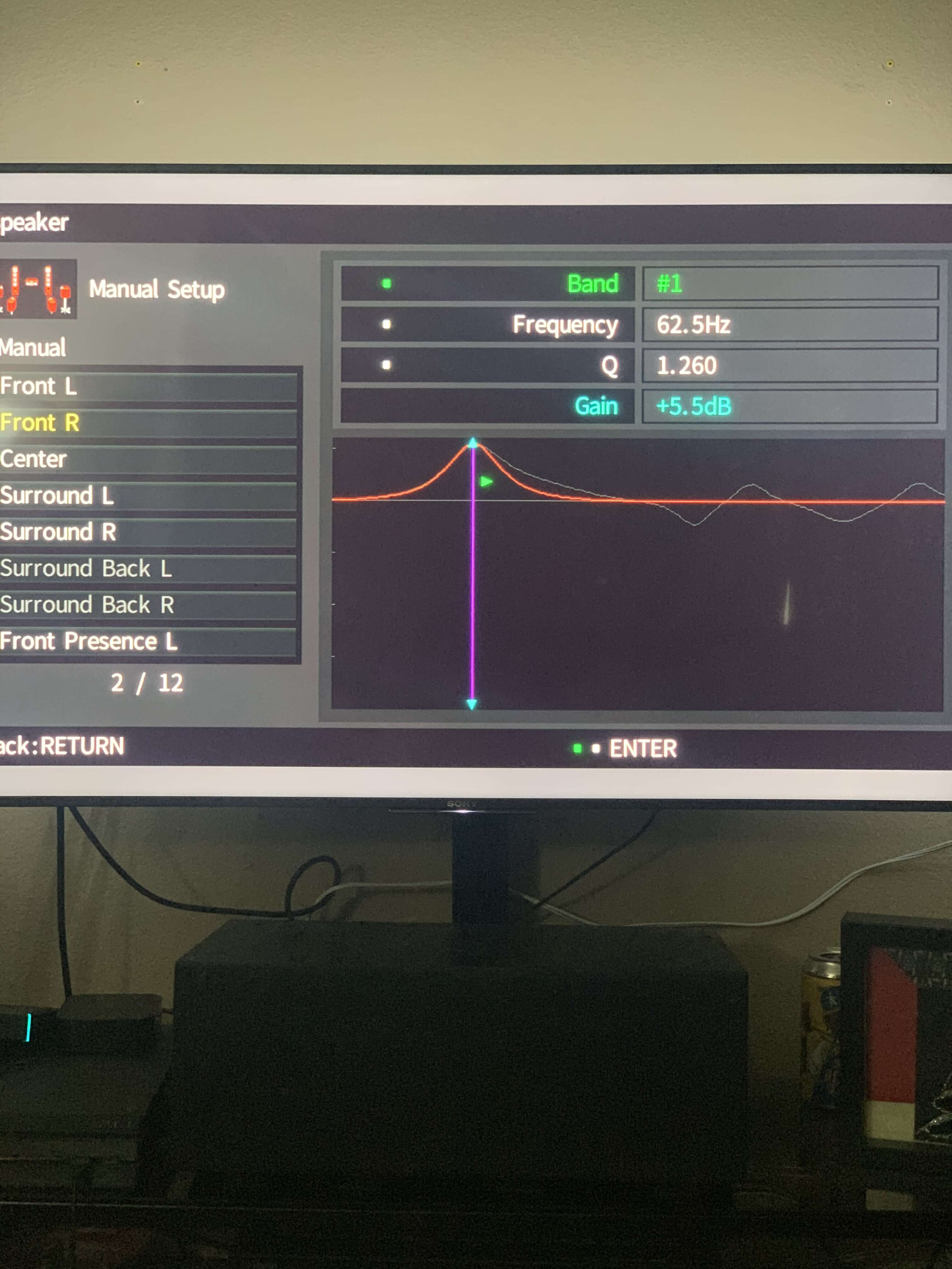

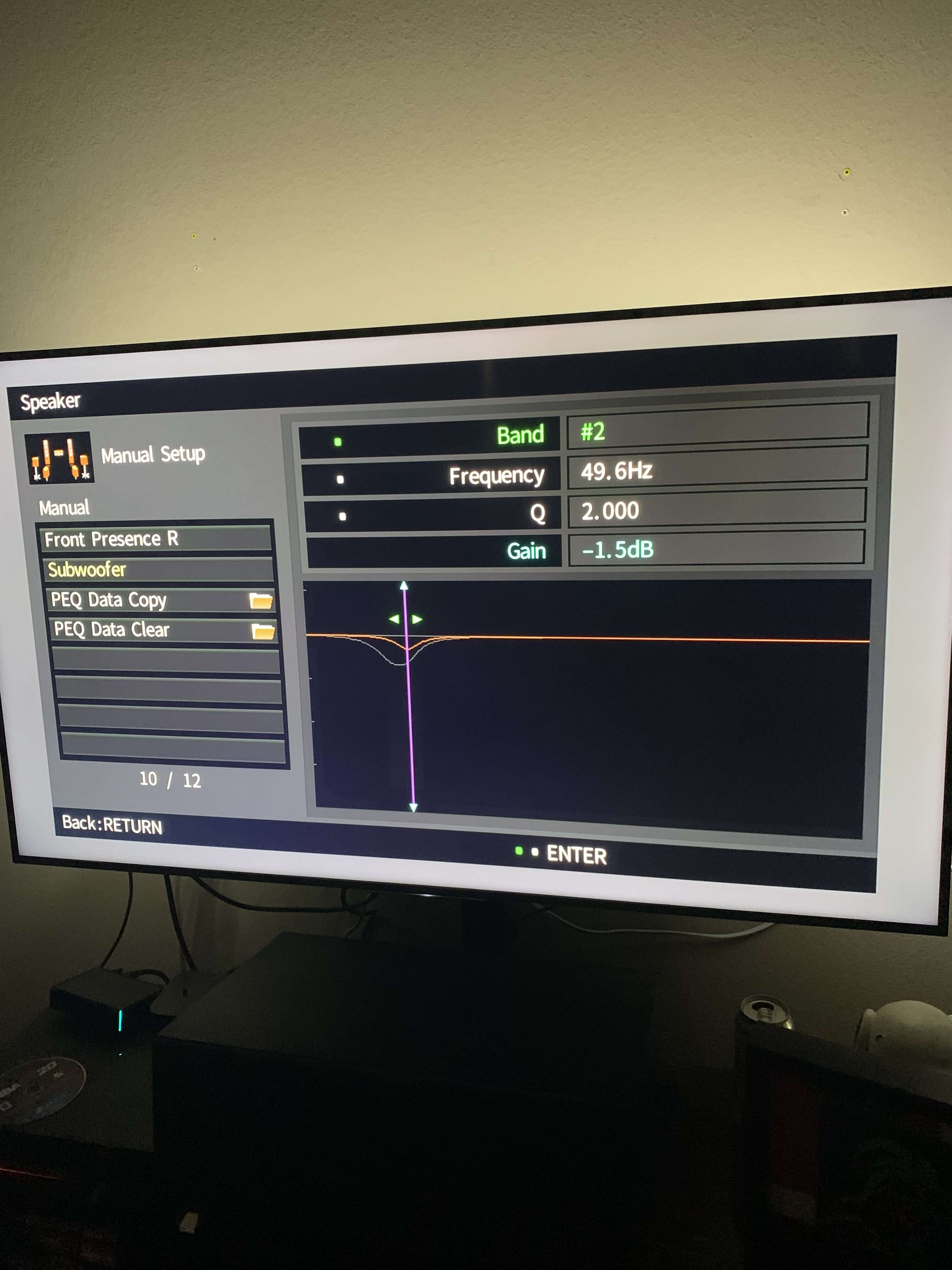

I had to rerun my YPAO after purchasing some new Atmos speakers. However, after rerunning it, my SVS subwoofer doesn't have the punch it use to, seems flat, I noticed that YPAO seemed to really mess with the fronts and sub raising the frequency on the fronts and then dropping the sub. Check out the photos, in the PEQ menu.
I had to basically turn my sub down to 9 o'clock to get it at -9, everything else stayed at -10, it set my center and fronts to large. I had to set them to small and 80hz. But the PEQ seems really off. Any advice is greatly appreciated.

I’m just trying to wrap my head around this l, so in the PEQ if it lowered the subwoofer frequency gain by -2.5db, at 39 & 49hz, that would effect the bass level/sound, as seen in the pic?
As opposed to the subwoofer trim level in the avr or the sub itself, it would simply be relative. Yes, if you boost gain at certain frequencies (and width since its peq) from baseline or reduce from baseline, it will have an effect on level....at those frequencies.
