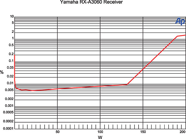

Unless we can see actual measurements from AH or S&V that prove otherwise, I would assume the 5000 and 5200 are essentially the same in power output.
But if you have the RX3080, I don’t see the point of getting the MX5000.
Both will do fine for most cases except for some cases like 9CH Stereo Mode, Speakers with Low sensitivities, 15A house circuits, listening distance, volume.
PENG
I have to agree, look at the graphs below and it is obvious. Less than 20 W difference, measured by the same magazine. www.soundandvision.com
