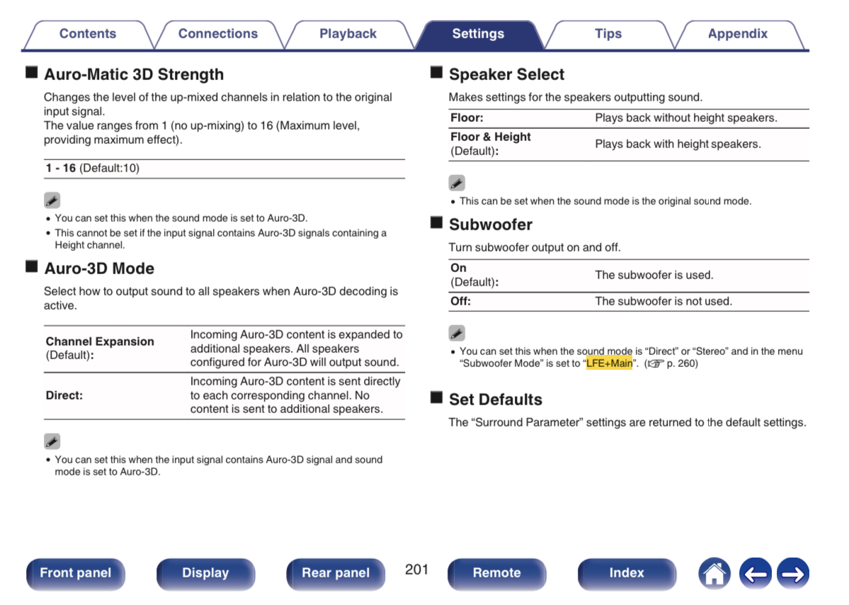

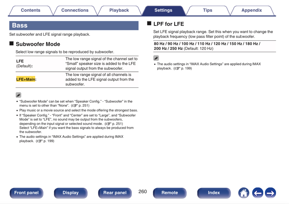

As I’ve already said in my previous posts, when I play Karaoke from YouTube (2CH PCM, NOT 2.1) in PURE DIRECT mode on the Denon’s, my subwoofers are playing 100%.
Again, it is NOT STEREO or any other mode because there is NO AUDIO DELAY for my Karaoke.
But I think the secret might be the Subwoofer Setting LFE + Main, which I think is a “Double Bass” feature.
Regardless of how it is done, It is absolutely PURE DIRECT mode because there is NO AUDIO DELAY. And the Subwoofers are 100% playing for 2CH PCM source.
In conclusion, my Denon AVR’s were capable of bass management (subwoofer use) in PURE DIRECT and DIRECT modes.

Yes. The subs will play with any .1 content. But if there’s a setting for 2ch playback I can’t find it. I’m fairly certain you told me it was only available on 7xxx and 8xxxx series Marantz. Same with higher denons. No?
I don't think I have said that (if I did, I was wrong...) I might have said the older model Denon cannot have sub on in pure direct but that would have to be from ages ago, models as old as the 3805, not sure about the 3808, and being so long ago I could have remember it wrong.
Edit: Below only applies to the Denon 4000 and Marantz 7000 or higher models. I should have known that William must be right, he owns the SR6012, I don't and I should not have assumed.

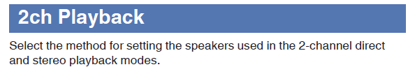

For non .1, that is, 2.0 contents, you don't have the LFE contents, so in order to have the sub on you have to go the SETUP/Speaker/Manual Setup/2ch Playback and set Subwoofer to "Yes" and SW Mode to LFE+MAIN.
After that the sub should be active in direct and pure direct mode.

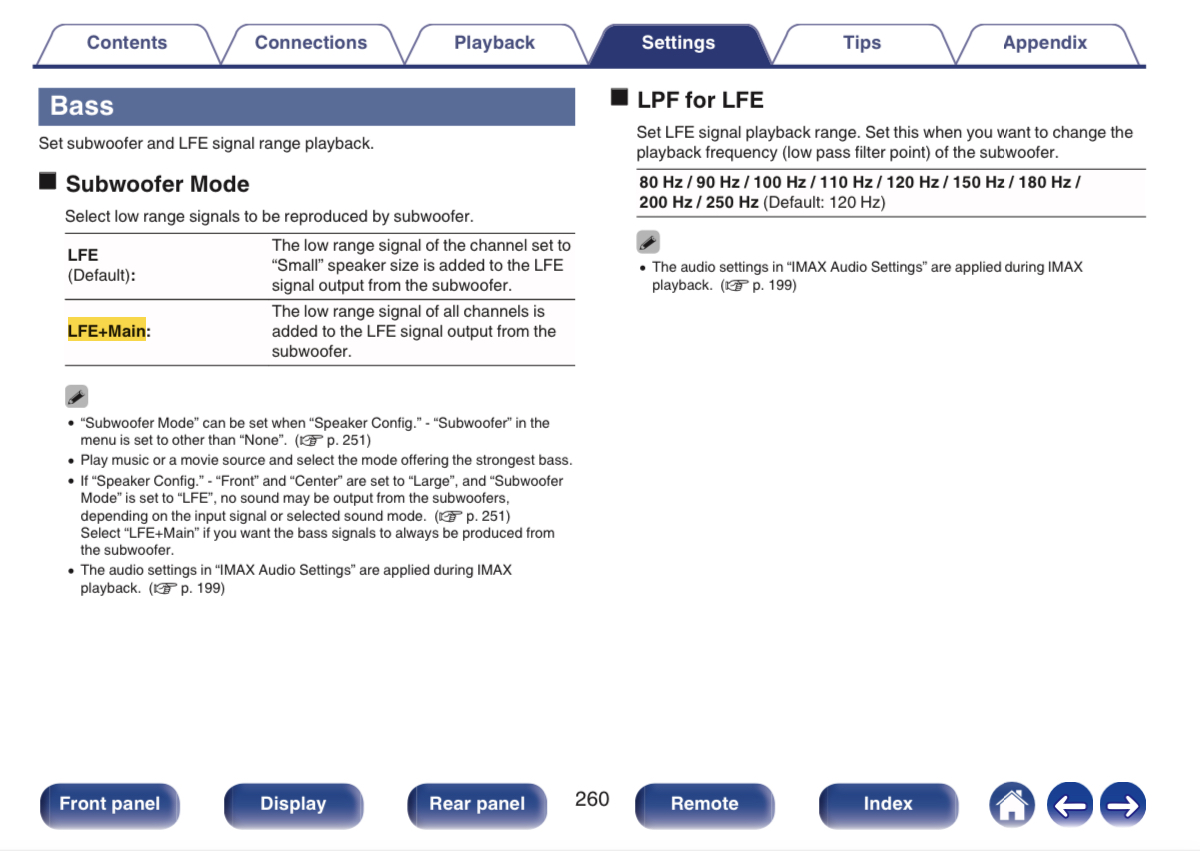

That’s the thing. I don’t have a separate “2ch” setup menu. I can set LFE+mains, but it seems to be global. I can’t be THAT dumm???
My mistake and my apology... You are correct, that only the Denon 4000 and Marantz 7000 and higher models have the 2 Ch playback menu:

William is right about the Marantz 6000 and Denon 3000 series cannot have the subwoofer on in Direct and Pure Direct mode for 2 channel stereo contents play back.

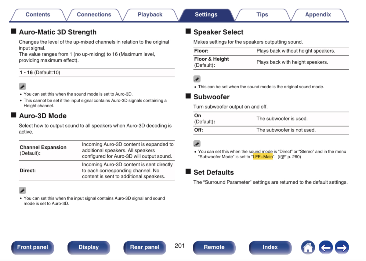

The Denon X3100 and the AVR-3000-series before the X3100 (I think AVR-3312) were the Denon I used for Karaoke which required Pure Direct mode + Subwoofer output. So if Denon stopped that, it must be AFTER the 3000-series I owned.
So anyway, whichever Denon models 3000-series I used did allow Subwoofer use with Pure Direct mode.
